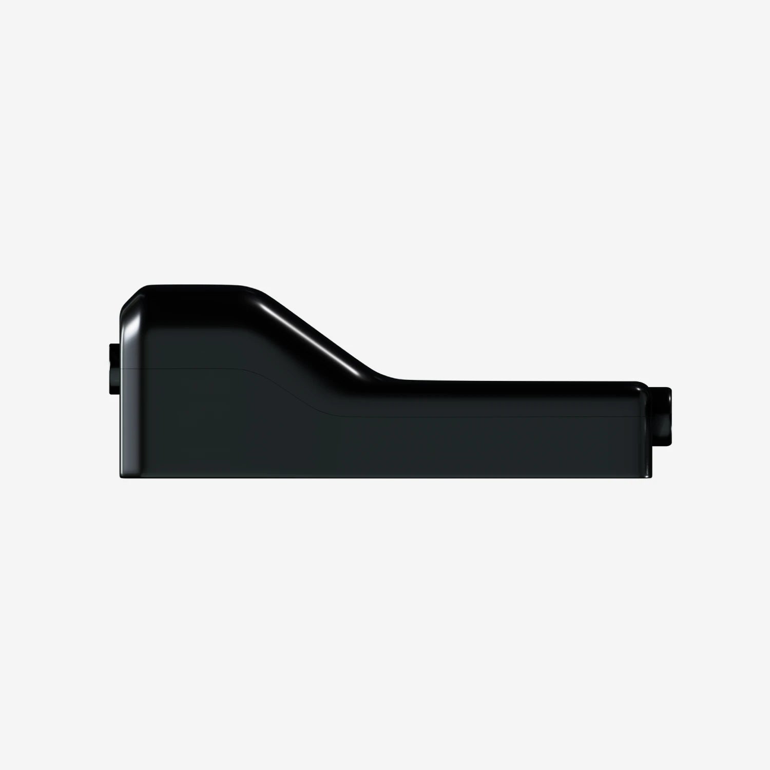

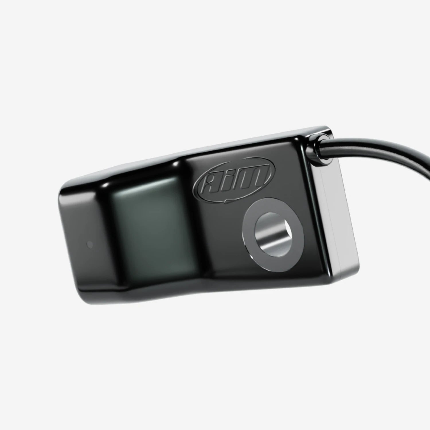

    The Aim Infrared Receiver is a spare or replacement Receiver that is installed on your vehicle and receives the lap signal from the infrared transmitter.
    Key Features:

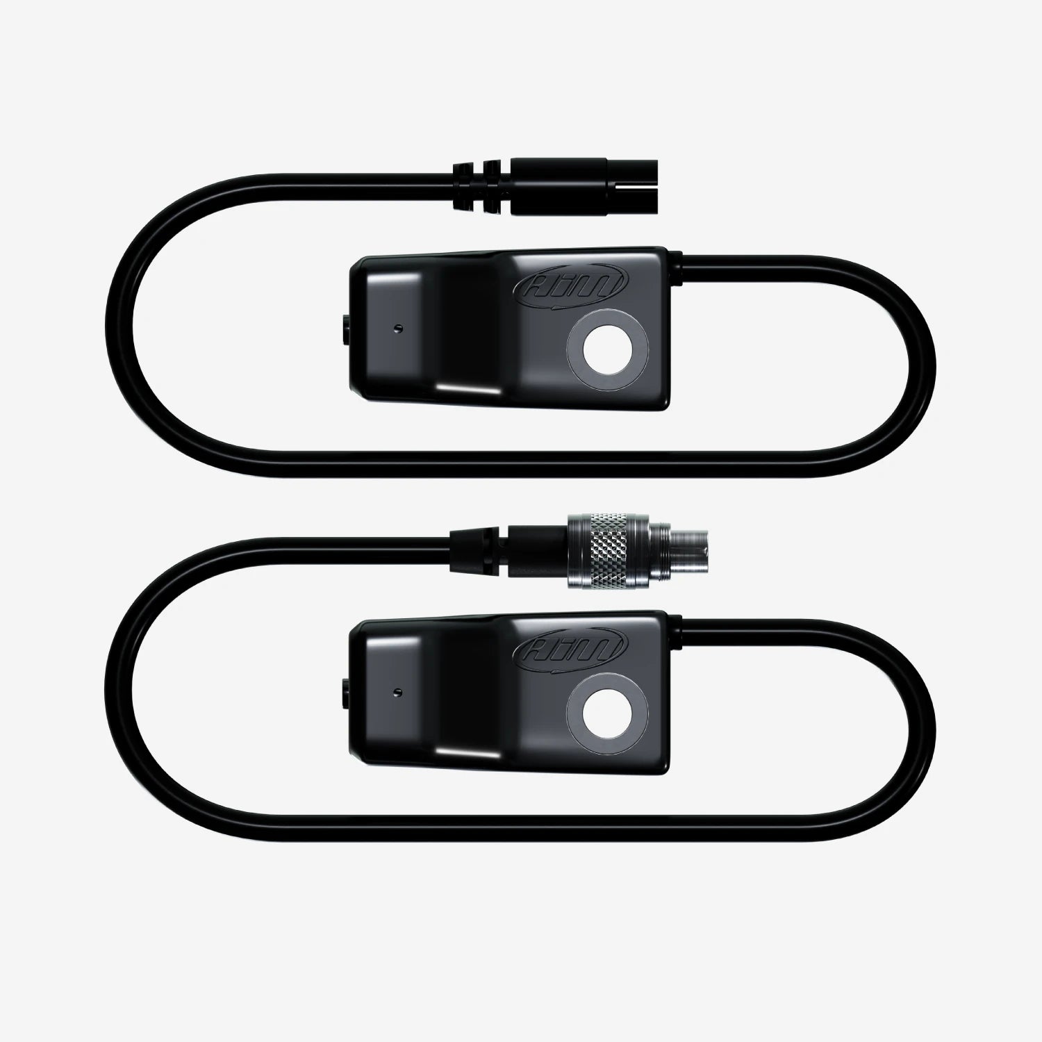

    Spare / Replacement Receiver 4 pin connector
    Aim IR Optical Lap Receiver

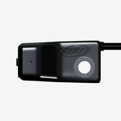

    The Aim Infrared Receiver, sometimes referred to as an Optical Lap Receiver, is installed on your vehicle and receives lap signals from the infrared transmitter positioned at the side of the track. It just needs to be pointed to the side of the track where the transmitter is installed to be able to read the signal.
    It is also available with a 4 pin metal plug connector.
    The infrared receiver is available with a 90cm lead for motorcycles, motocross bikes or karts, and it is also available with a 300cm lead for cars to suit your requirements.

    Installation
    The Infrared receiver should be fixed to your vehicle by fixing through the fixing hole at the top of the receiver. When fixing the receiver, be sure that the eye is pointing to the side of the track where the receiver has been installed.

    • Binder connection Pinout:
    • 1 - n.c
    • 2 - GND
    • 3 - V battery (7-15 VDC)
    • 4 Optical Lap Signal
