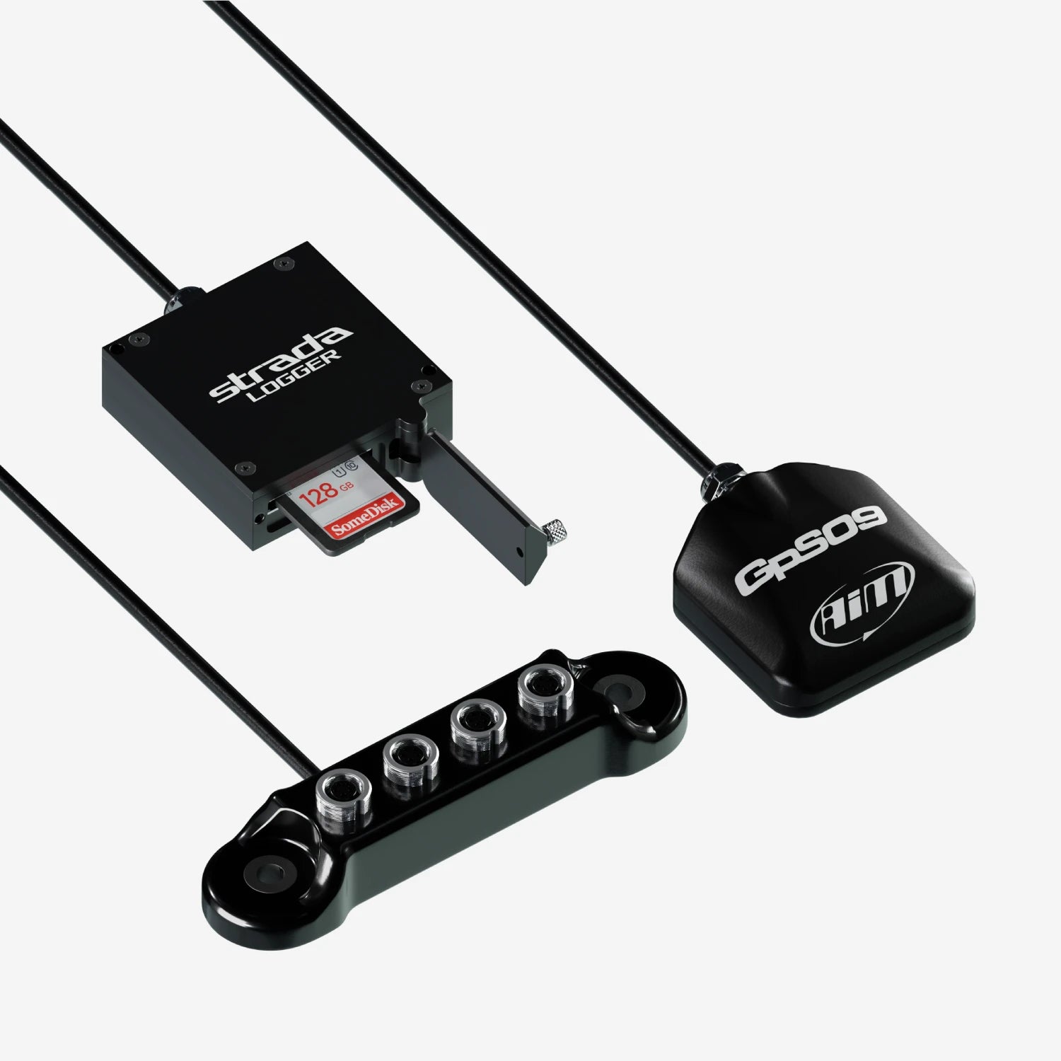

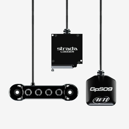

The Aim Strada logger kit will upgrade and turn any base MX Strada (MXS, MXP, MXG or MXT) into a complete data logger. The logger kit comes with the MX Strada logger, a GPS09 Module and a four-way data hub.

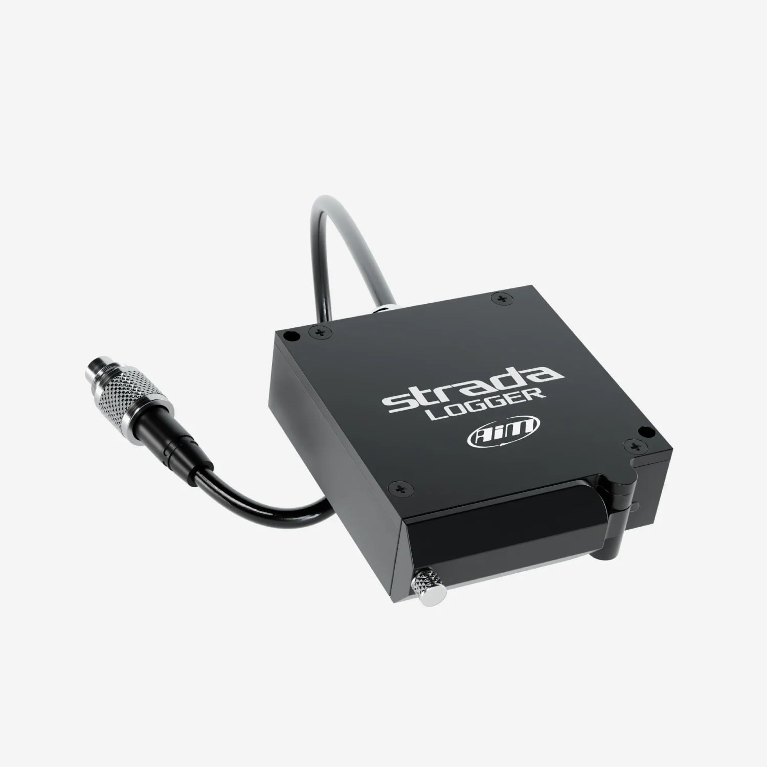

MX Strada Logger
The MX Strada logger kit will record all the data from your practice sessions or race onto the data logger and prepare it to be downloaded to Race Studio 3 software for further analysis. This allows you to review and analyse your data to improve driving technique and improve the vehicle setup, taking seconds off lap times.
Data will be saved on an SD card (supports up to 32GB memory cards) and stored in the logger memory. You can remove the memory card during a pit stop or with the engine running, so if you are in an endurance race or an extended test session, you can analyse your recorded data whilst you are still on track. The MX Strada logger also features a front LED that shows its status: recording/firmware status.
Please Note: SD cards are not included in the kit.
GPS09 Module
Aim GPS technology represents a true revolution in data acquisition. The lightweight, waterproof GPS09 module connects via CAN for quick installation and works with nearly 20 satellites to ensure precision and reliability. It achieves an average accuracy of less than 1 meter, even when the finish line is close to another track segment.
Immediately after switching on, the GPS09 module locks onto satellites rapidly, eliminating the risk of lost signals due to noise or interference. Paired with GPS Manager software, it provides instant lap times, comprehensive track databases, and the ability to set start/finish lines and splits. You can access vital performance data such as speed, chassis analysis, track position, cornering in-line and lateral G and automatic lap timing—everything needed to improve both engine tuning and driving technique.

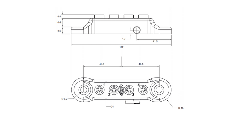

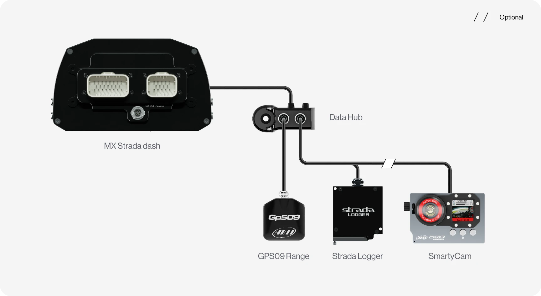

Data Hub CAN Connection Multiplier
The compact data hub provides four additional CAN channels and works as an interface between the Aim logger and its peripheral devices and accessories, such as the LCU Lambda Controller, GPS Module, TC Hub (thermocouple multiplier), Memory Key and SmartyCams.
Using many devices can result in excessive wiring, but with the data hub, all unnecessary wiring is eliminated for a clean and simple setup.
Strada Logger
  • Max Power Consumption: 50mA
  • Cable Length: 40cm
  • SD Card: Supports up to 32GB (not included)

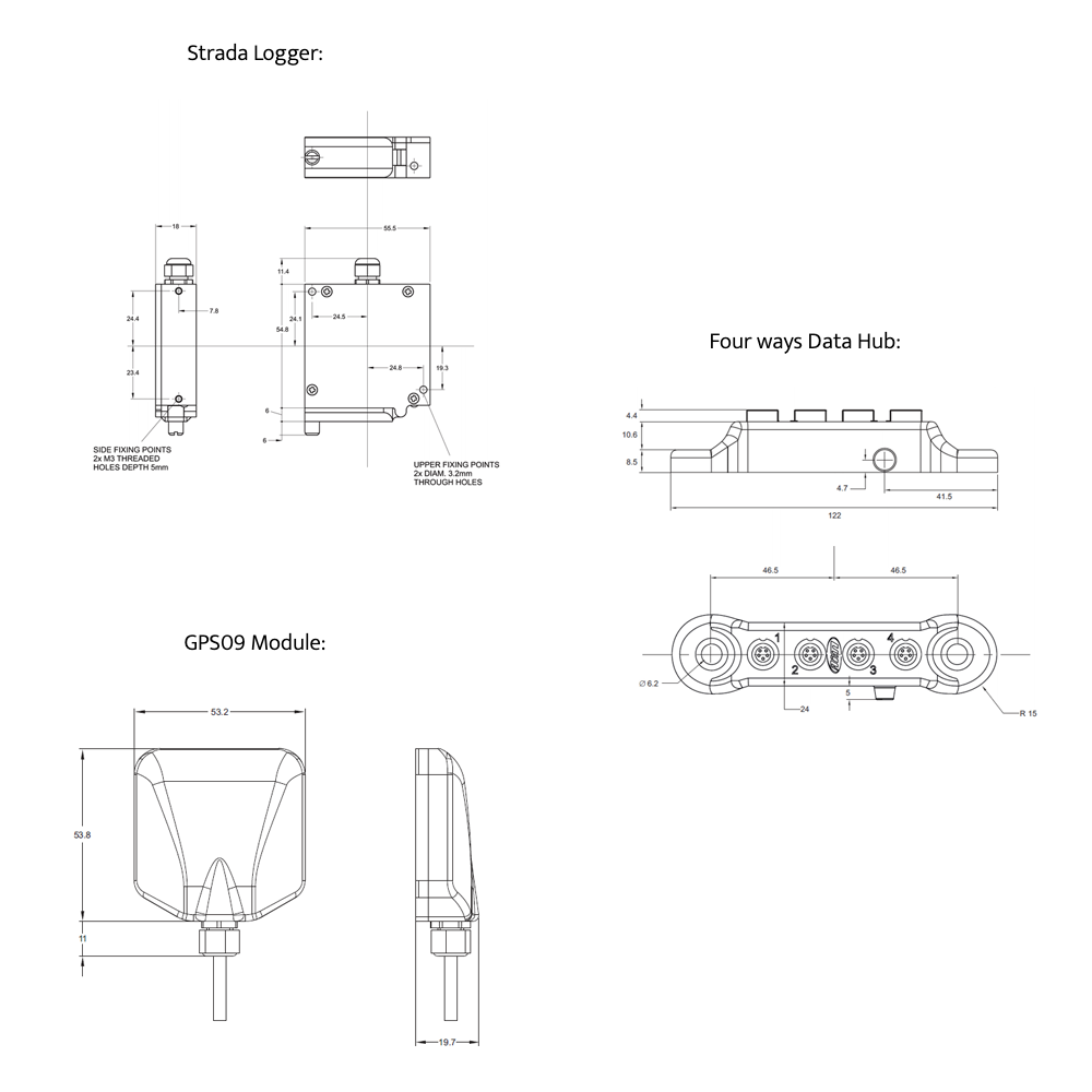

  • Dimensions: 55.5 x 78.3 x 18mm
  • Weight: 103g
  • Waterproof: IP65
Four-Way Data Hub
  • Dimensions: 123 x 30 x 23.5mm
  • CAN Cable Length: 40cm
  • Weight: 97g
  • Waterproof: IP65
GPS09 Module
  • Weight: 60.5g
  • Waterproof: IP67

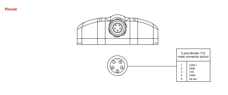

Pinouts
