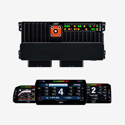

Aim PDM32 Data Logging Kit
The Aim PDM32 system combines advanced power management, real time data display, and precision GPS tracking into a single integrated solution. Its 32-channel power distribution module replaces traditional fuse boxes and relays, while the fully configurable TFT display presents critical information through customisable layouts and intuitive road icons. When paired with the onboard GPS Module, the system also delivers accurate lap timing and track-mapping capabilities for a complete electronics package.
Aim PDM32 Power Distribution Module
Why Choose the PDM32 Road Dash Display Kit
The Aim PDM32 is a 32-channel advanced power distribution module designed to power a multitude of vehicle circuits, removing the need for traditional fuse boxes and relays. It allows for a simplified wiring harness with increased reliability and control functions. Paired with a TFT Display with Road Icons, a fully configurable display with a range of layouts to choose from, and a GPS Module that provides easy lap timing and lap position for track mapping, this kit is the ultimate set-up for full vehicle control and performance improvement.
The PDM32 features 28 high-side outputs and 4 half-bridge outputs: 4x rated up to 20A (high power), 12x rated up to 15A (mid-power), 12x rated up to 10A (low power), and 4x rated up to 35A (half-bridge), with a total continuous max current of 120A. Each output provides feedback to the data logger to provide vital information such as open circuits, short circuits, high/low voltage, and the number of fault retires. The time between the retires is user-definable. All outputs can be configured as PWMs for a soft start/stop. All of the PDM circuits can be set up and monitored via the Race Studio 3 software.

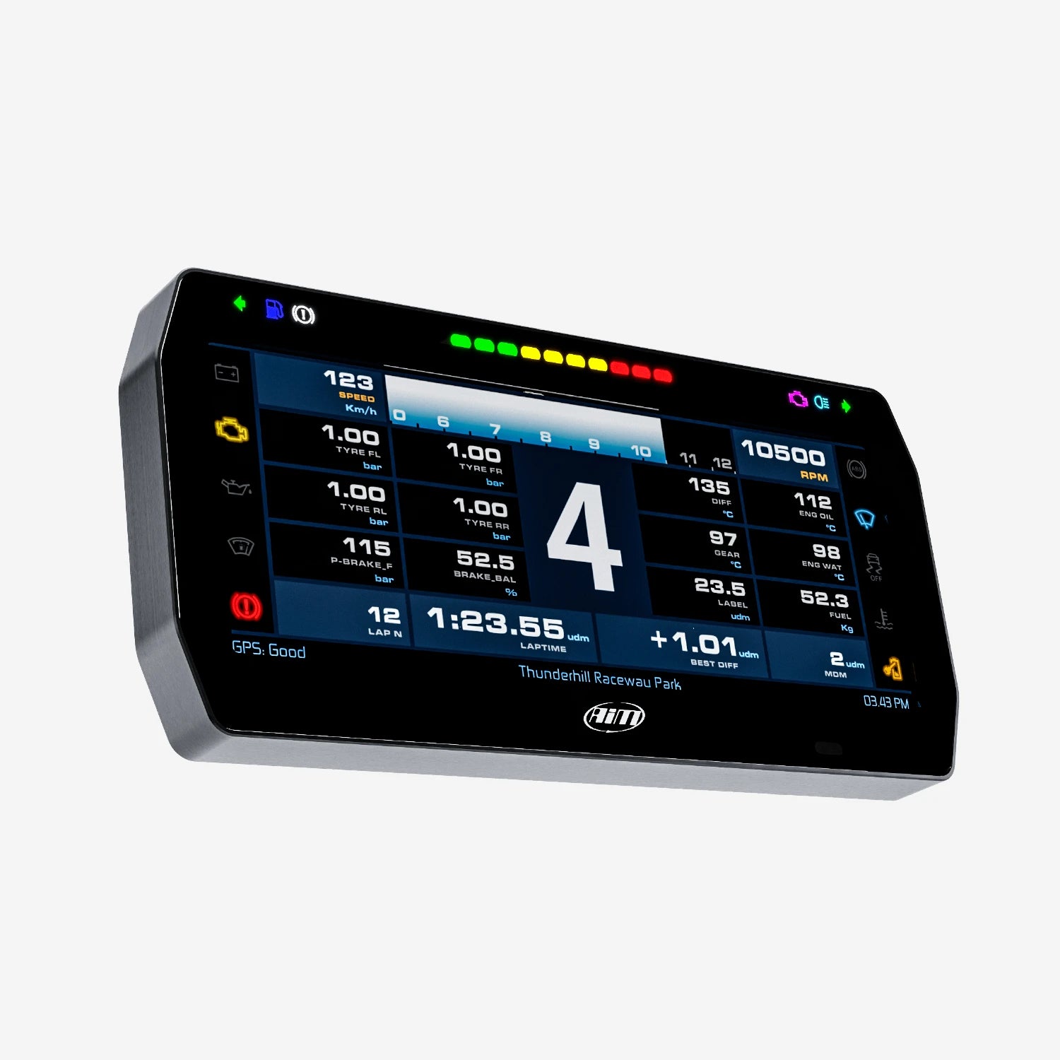

PDM Dash Displays with Road Icons
All versions have fully user-configurable displays and offer a range of layouts, and are available with "Road" or "Race" icons. Road icons with this particular kit allow you to apply conditions to the LED icons, such as fuel, engine, oil, lights, indication and more.
Indlæs video: Delta times LED display feedback on the 5 inch PDM Display
Indlæs video: Integrated shift light array interface and customisable alarms for the PDM Dash Displays
Indlæs video: Pre-configured dash display screens for the PDM Dash Displays.
Pre-Configured Pages
The Aim PDM Display can show the RPM scale and all the data you need, like speed, water temperature and oil pressure, lap times and much more. You can customise pages to suit your requirements, including up to four additional fields. Define what data is shown with the end of scale and measure units. Swapping between the pages is easy; just use the push buttons.
  • LEDs: 32 RGB LEDs, 1 PDM ON & 1 PDM STS (status)
  • Inputs: 14 fully configurable (max 500Hz each) - 8 analogue/digital, 4 digital inputs & 2 speed inputs
  • Lin Bus: 1
  • CAN Connections: 3
  • Internal Memory: 4GB
  • External Analogue Camera Input: 2
  • Connectors: 2 AMP connector, 2 binder connectors, 1 Amphenol SurLok connector & 1 Rosenberger connector
  • Body: Anodised aluminium
  • Dimensions: 234.5 x 94.6 x 49.5mm
  • Weight: 761g
  • Waterproof: IP65
Power Outputs
  • 4 rated up to 20A (high power)
  • 12 rated up to 15A (mild power)
  • 12 rated up to 10A (low bridge)
  • 4 rated up to 35A (high side/half bridge/low side/configurable PWM at max 10KHz)
  • Protected For: Over-voltage, under-voltage, over-current, over-temperature
  • Total Max Current: 120A

Aim PDM Display
  • Display: 5" / 6" / 10" TFT
  • Waterproof: IP65
