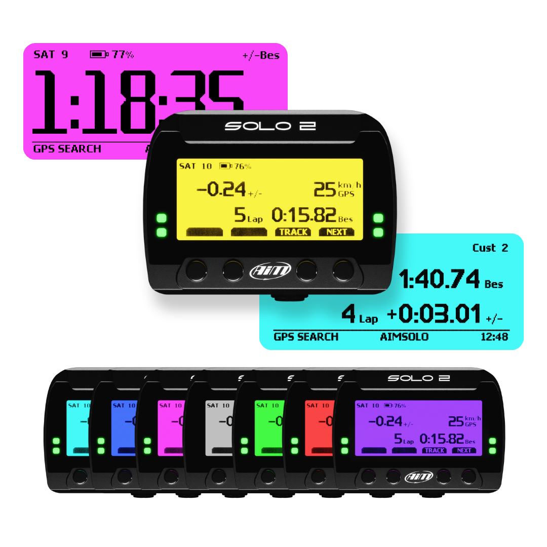

Advanced Lap Times & Performance Analysis
The Aim Solo 2 DL is the most precise GPS lap timer in the world. With the ability to show your live delta times as you drive. Receiving data from 2 satellite constellations, GPS and Glonass, it also gives you a significant improvement in data, speed, and positioning precision.
Powering on requires only a few seconds, and lap times are calculated within 2/100 sec of tolerance.
The Solo 2 DL gives instant speed, timing, splits, live data and predictive lap times, and can be backlit in 8 available colours.
The Solo 2 DL has a sharp, high-contrast display which helps drivers easily identify the data displayed on screen, as well as 8 different backlight colours.
