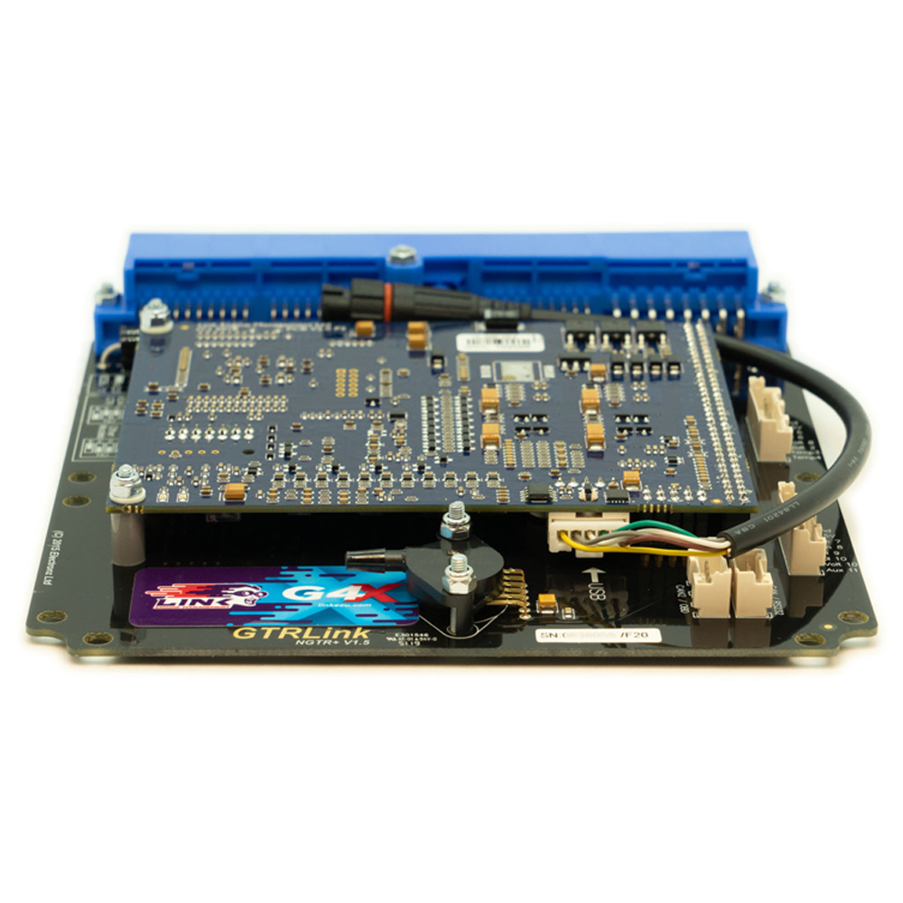

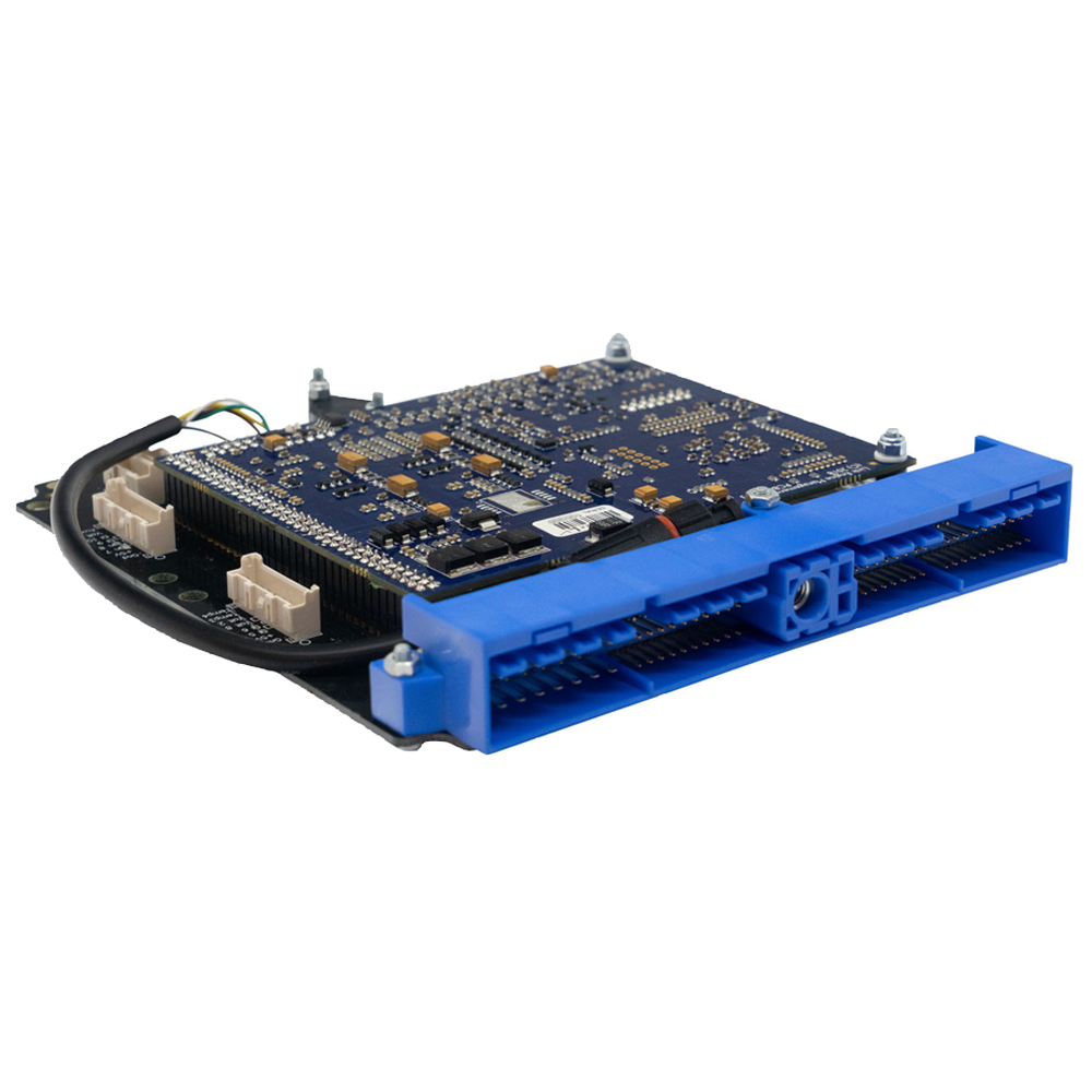

    The NGTRX is Designed to suit the blue plug Nissan RB engine.
    This model includes an onboard 4 bar or 7 bar MAP sensor.
    Suitable Applications:
    RB26DETT engines found in R32, R33, R34 Skyline GTRs and Autech 260RS Stageas
    RB20DE engines found in R32 & R33 Skylines, A31 Cefiros
    RB20DET engines found in R32 Skylines (incl 4wd), A31 Cefiros and C33 Laurels. – Injector 4&6 need swapping
    RB25DE engines found in R32 & R33 Skylines, C33 & C34 Laurels and A31 Cefiros.
    RB25DET engines found in R33 Skylines (incl 4wd) and C34 Laurels
    RB30DE/DET/DETT engines made using Non-Neo heads and blue plug looms
    PlugIn Key Features (where applicable):
    Sequential fuel delivery
    OEM idle hardware supported
    CAN port
    USB tuning cable included
    Staged injection
    Knock with "windowing"
    I/O Expansion Options:
    Expansion connector 1
    Gnd Sensor Ground Only
    DI5 Digital Input
    DI6 Digital Input
    An Volt 8 Analog 0-5V input
    An Volt 2 Analog 0-5V input
    Expansion connector 2
    DI 9 Digital Input
    DI 10 Digital Input
    An Volt 10 Analog 0-5V input
    Aux 11 Auxiliary Output 11
