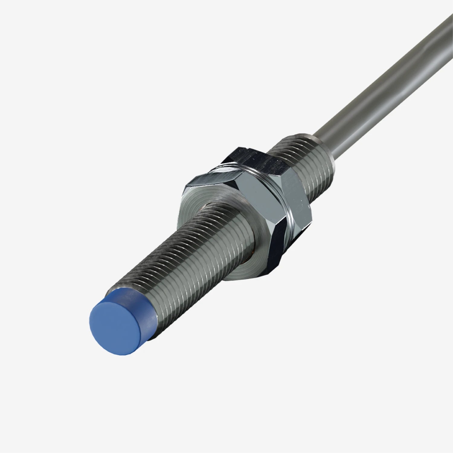

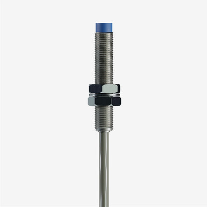

The Aim Hall Effect Speed Pick-Up Sensor is a non-contact sensor that detects the speed of a rotating object such as a wheel, driveshaft, or gear. It does this by sensing the passing of a metallic trigger (for example, a bolt head, gear tooth, or magnet) in front of the sensor face. The sensor includes a magnet and locknuts for installation.
Why Choose the Hall Effect Speed Pick-Up Sensor
The Aim Speed Pick-Up Sensor operates using a Hall Effect; inside the sensor, a small thin piece of semiconductor material carries a constant electrical current. When this material is exposed to a magnetic field (such as when the trigger passes by), the movement of electrons within it changes - they are pushed to one side of the material, creating a small voltage difference called the Hall voltage.
This voltage is then converted into a digital signal - a square wave - that the data logger or ECU (Engine Control Unit) can interpret as pulses. Each pulse represents one pass of the trigger, allowing the system to calculate rotational speed (RPM) or linear speed, depending on where the sensor is mounted.
Please Note: There will be a flashing light on the back of the sensor when it is in contact with metal - you can perform this as a test to be sure that the sensor is ready for installation.

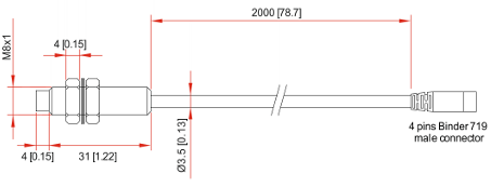

Hall Effect Speed Sensor Dimensions

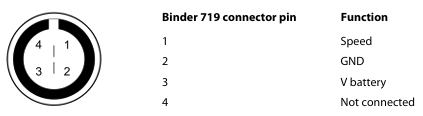

4-Pin Binder Pinout
