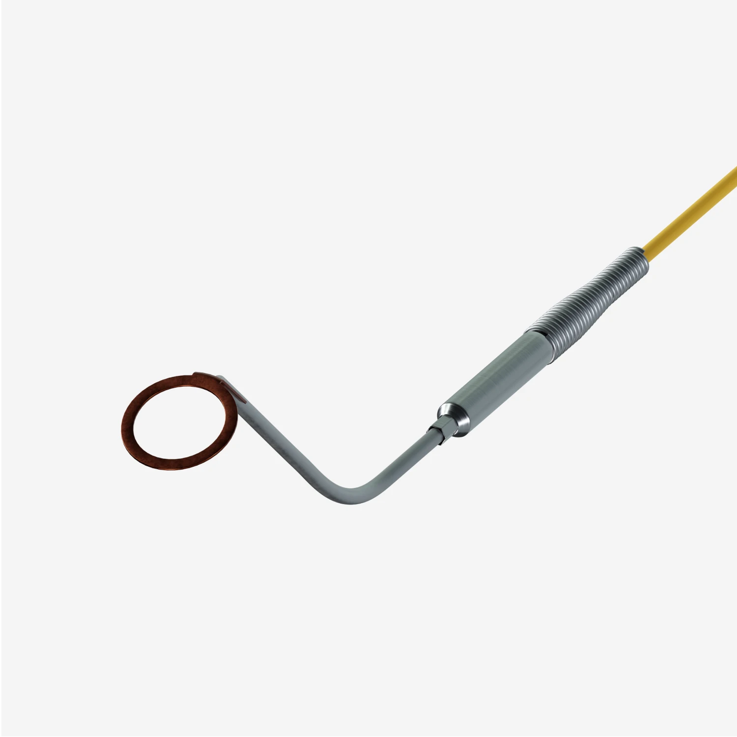

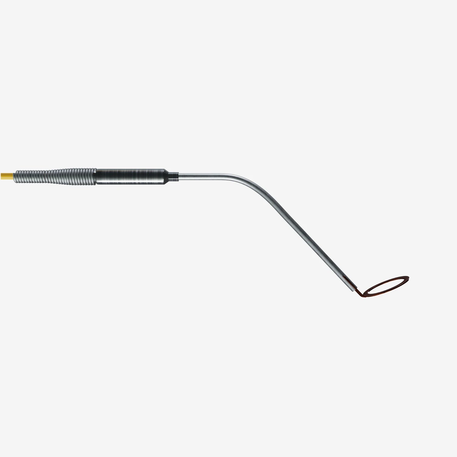

The Aim Under Spark Plug Sensor is a thermocouple sensor that measures the cylinder head temperature from 0º to 300ºC, and is suitable for data loggers using a TC yellow patch lead. The cylinder head is a direct indicator of the overall engine combustion temperature, and the sensor is designed to be placed between the spark plug and the engine’s cylinder head.

Please Note: To keep the sensor in contact with the cylinder head, you will need to remove the washer from the plug when installing the thermocouple.

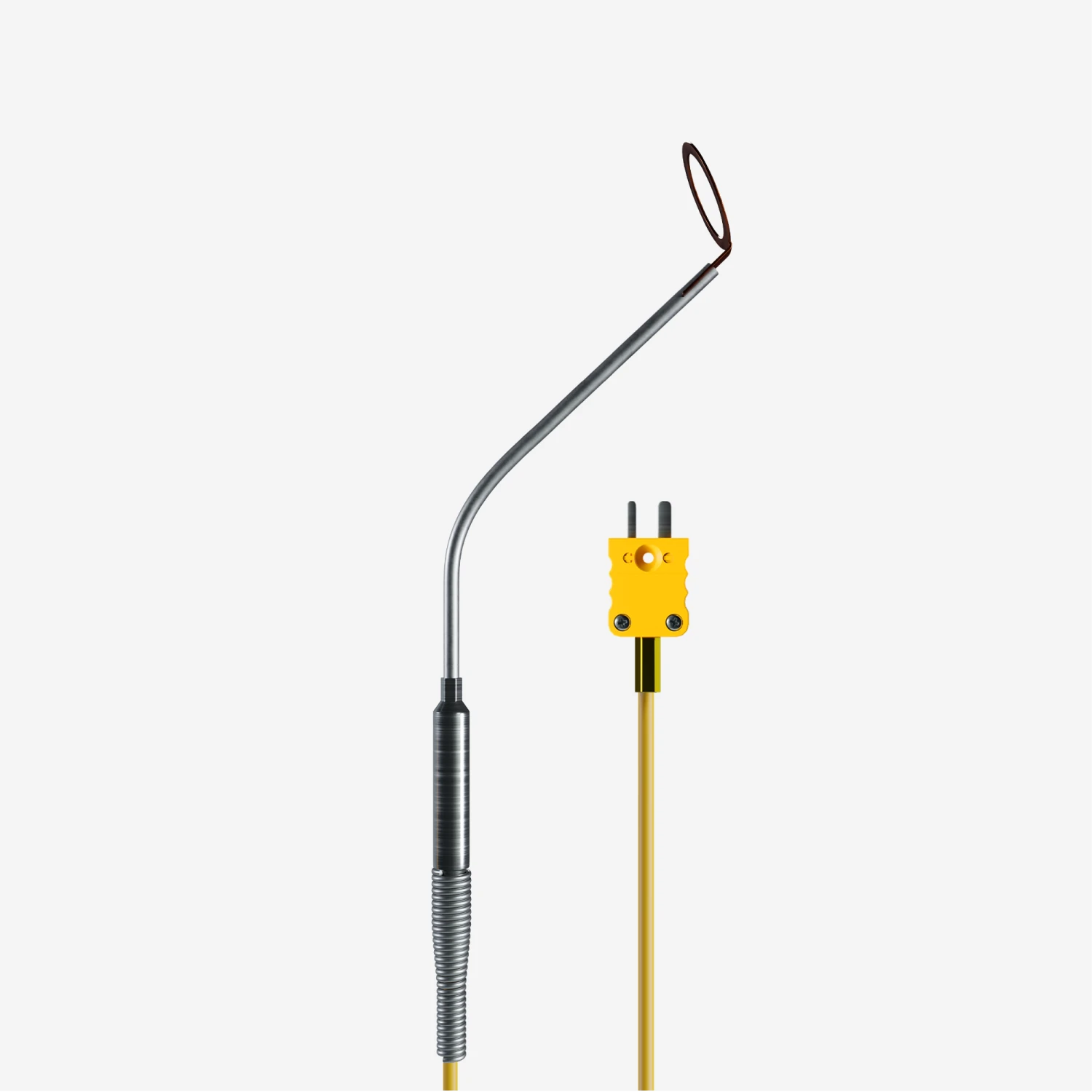

  • Temperature Working Range: 0-300°C
  • Cable Sensor Length: 40cm
  • Cable Type: Compensated
  • Connection: 2-pin male thermocouple
  • K Type Thermocouple
  • Diameter: 14mm
