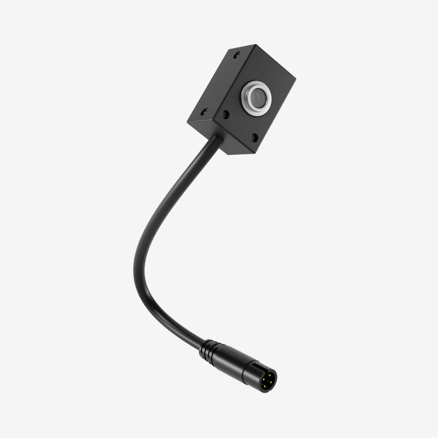

The Aim Infrared (IR) tyre temperature sensors have 4-pin black 719 binder plug connection to fit all Aim loggers and dash display/loggers.

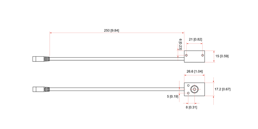

The compact IR sensor enables contact-free tyre temperature measurements at distances ranging from 30 to 150mm. An ideal car set-up would be three sensors per tyre (inside, centre and outside). However, 1 per tyre can also be helpful if budget or channel input constraints dictate this. The temperature range is 0–150ºC with a cable length of 25cm.
Ensure to place the sensor far from strong heat sources like the exhaust pipe and electromagnetic interference.
