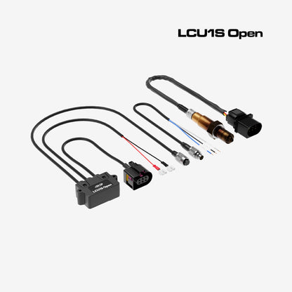

The Aim LCU-One S Open gives you complete control of your engine while offering unrivalled flexibility in motorsport data integration. Unlike the standard version, the Open version is designed to connect seamlessly with a wide range of networks outside of the Aim Technologies ecosystem, making it the perfect choice for teams and drivers running mixed systems.

The Aim LCU-One S Open Lambda Controller can detect an accurate Lambda value from 0.65 to 1.6, delivering precise and reliable measurements for engine tuning. By analysing the remaining oxygen in the exhaust gases, it highlights excess or a lack of oxygen in the carburetion process, giving essential insights for both 2-stroke and 4-stroke engines.
The LCU-One S uses the wideband Bosch LSU 4.9 sensor due to its stability and long service life, designed to last more than 100,000km on a stock car without recalibration.

What sets the LCU-One S Open apart is its compatibility. While the standard LCU-One S Lambda Controller integrates exclusively with Aim Technologies systems, the Open version extends your possibilities. The LCU-One S Open communicates via CAN with leading motorsport brands, making it a truly universal solution for engine management and data acquisition. This ensures you can use the same trusted sensor technology, regardless of which system your team runs.

With its compact, waterproof (IP67) design, the LCU-One S Open is engineered for the toughest racing environments - from cars and motorcycles to motocross and karting. It also supports multiple fuels, including petrol, diesel, and alternative fuels, giving it the versatility needed across modern motorsport.
  • Sensor Compatibility: Bosch LSU 4.9
  • Power Supply Voltage: 9-15V
  • Power Supply Current: 50mA + sensor heater current typical 750mA up to 2A on cold sensor
  • Reaction Time: Less than 10 msec
  • Materials: Latigloss 57
  • Dimensions: 43.4 x 30 x 18.4mm
  • Weight: 70g
  • Waterproof: IP67
