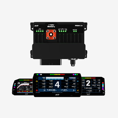

The Aim PDM08 system combines advanced power management, real time data display, and precision GPS tracking into a single integrated solution. Its 8-channel power distribution module replaces traditional fuse boxes and relays, while the fully configurable TFT display presents critical information through customisable layouts and intuitive race icons. When paired with the onboard GPS Module, the PDM kit delivers accurate lap timing and track-mapping capabilities for a complete, race-ready electronics package.

The Aim PDM08 is an 8-channel advanced power distribution module designed to power a multitude of vehicle circuits, removing the need for traditional fuse boxes and relays. It allows for a simplified wiring harness with increased reliability and control functions. Paired with a TFT Display with Race Icons, a fully configurable display with a range of layouts to choose from, and an optional GPS Module that provides easy lap timing and lap position for track mapping, the PDM08 kit is the ultimate setup for full vehicle control and performance improvement.
PDM08 Power Distribution Module
The PDM08 features 8 high-side outputs: 1x with series diode rated up to 20A, 1x rated up to 25A, and 6x rated up to 15A, with a total continuous max current of 100A. Each output provides feedback to the data logger to provide vital information such as open circuits, short circuits, high/low voltage, and the number of fault retires. The time between the retires is user-definable. All outputs can be configured as PWMs for a soft start/stop. All of the PDM circuits can be set up and monitored via the Race Studio 3 software.

  • LEDs: 8 RGB LEDs + 1 PDM ON + 1 PDM STS (Status)
  • Inputs: 6 fully configurable (max 500Hz each), pullup + 12V, + 5V, pull down & analogue/digital
  • Speed Inputs: 2
  • Lin Bus: 1
  • CAN Connections: 3
  • Internal Memory: 4GB
  • External Analogue Camera Input: No
  • Connectors: 1 AMP connector, 1 Amphenol SurLok connector & 1 Rosenberger connector
  • Body: Anodised aluminium
  • Dimensions: 161 x 100.6 x 50.6mm
  • Weight: 500g
  • Waterproof: IP65
