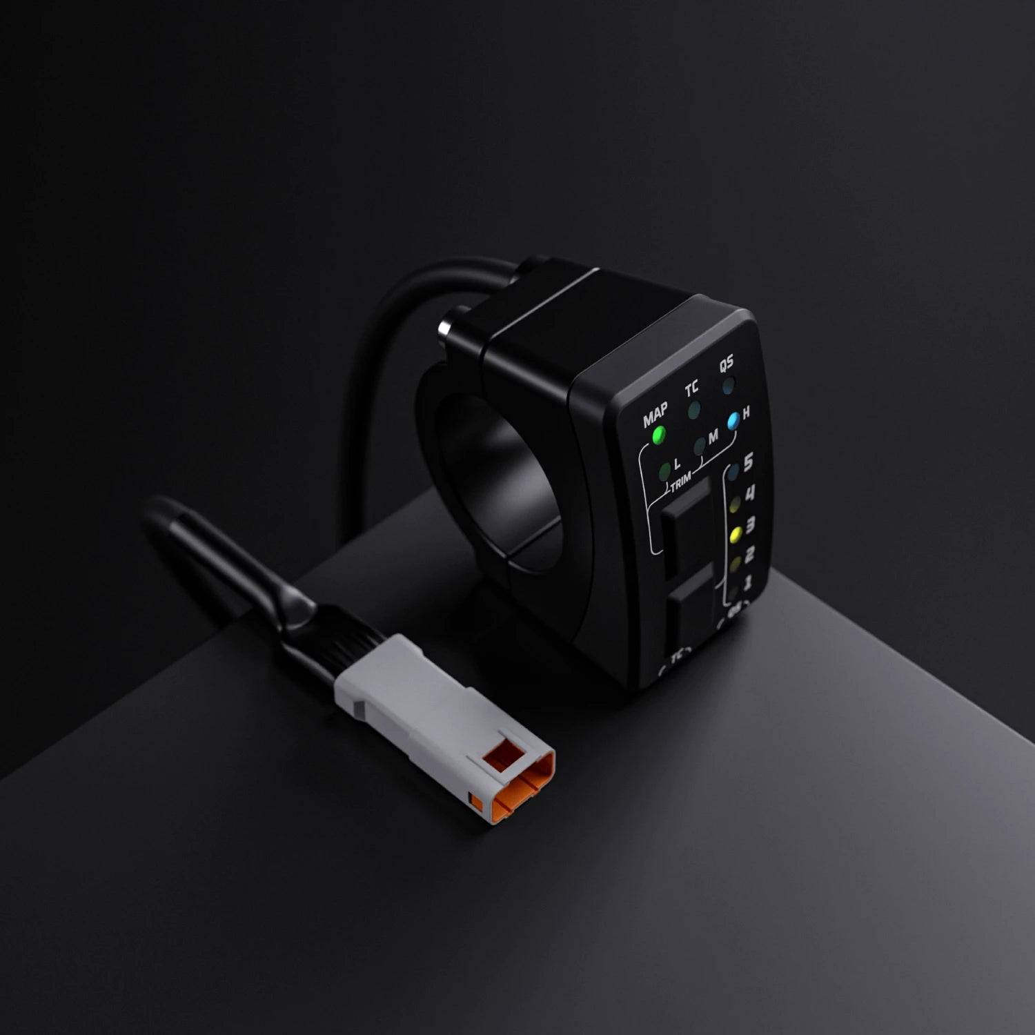

The AiM Taipan Handlebar Switch is the best way for changing the behaviour of your bike.
Up to 5 selectable maps | Apply fuel corrections |
Activate traction control | Activate launch control |
10 LEDs | |

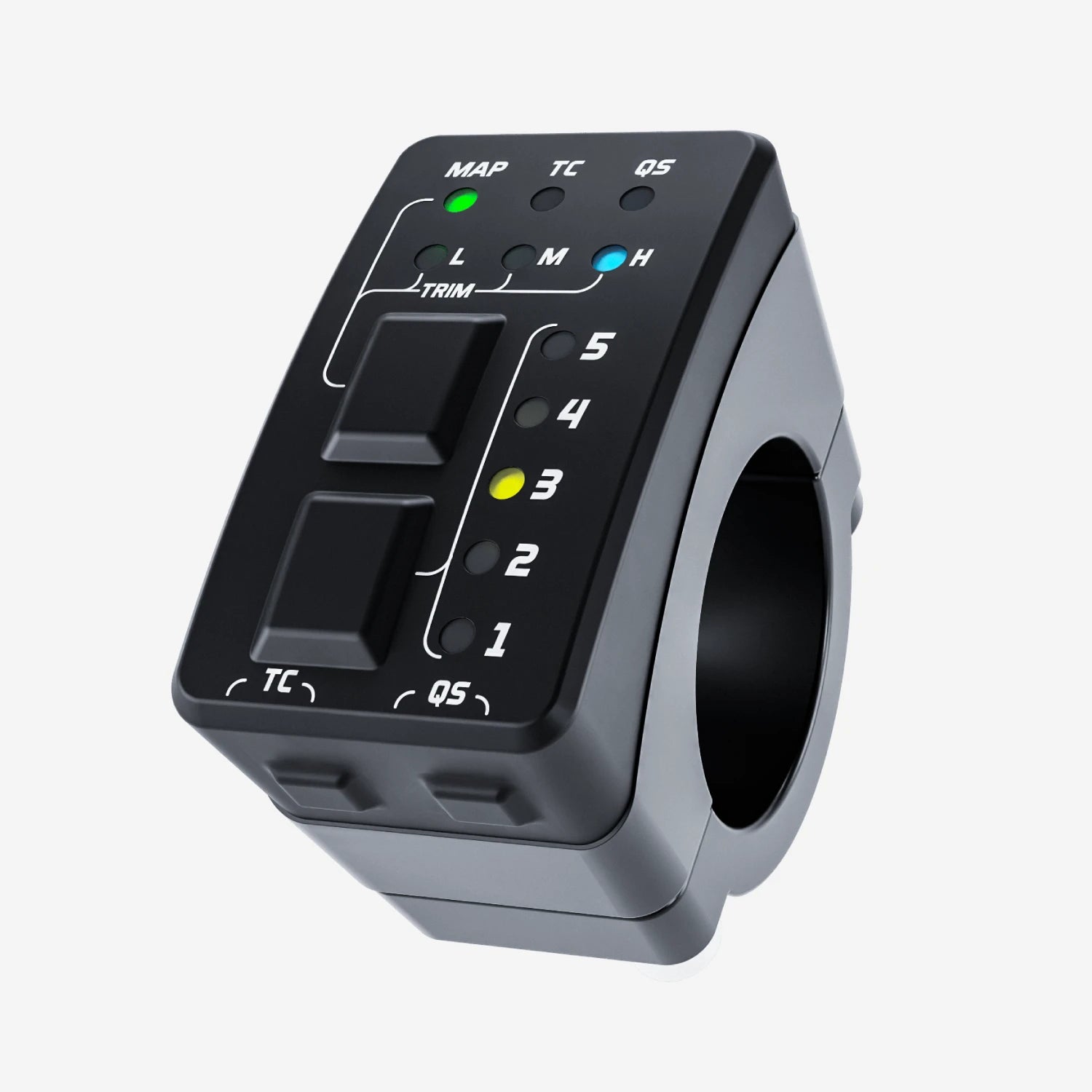

The AiM Handlebar Switch is the best way for changing the behaviour of your bike, it features 2 pushbuttons and 10 LEDs and manages the following settings:

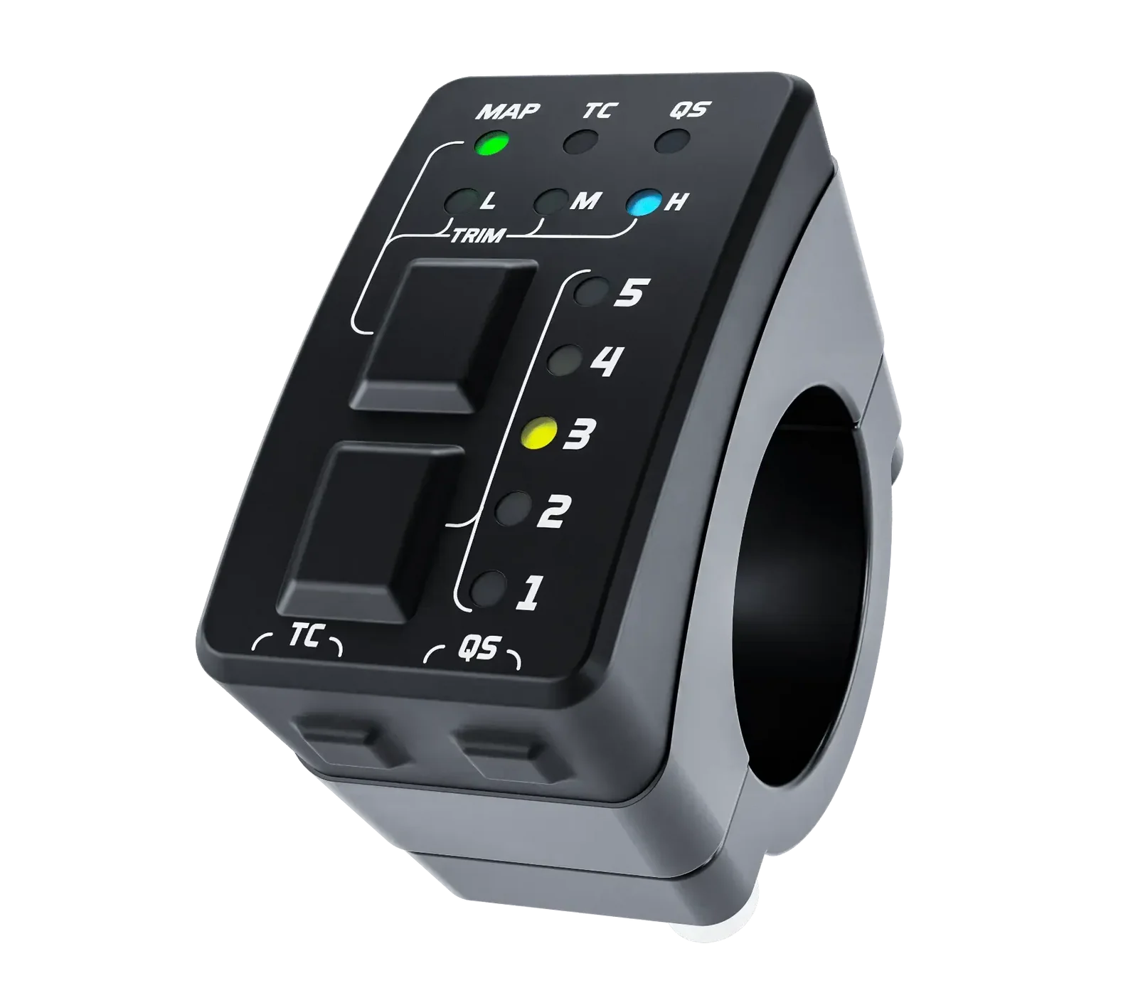

The lower push button on the device is used for changing a feature, while the upper push-button is for choosing one of the possibilities inside the selected feature.
The LEDs on the handlebar switch can be used as a Shift Light Module. Set your required RPM value and the LEDs will start to blink promoting a gear change.
Please Note: The Handlebar Switch is an accessory and you will need to purchase the Taipan ECU and UC-Bridge to enable all the below functions.

Traction Control

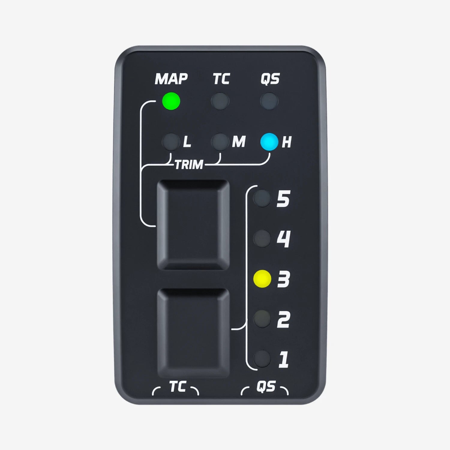

Traction control is used to stop your wheels from spinning when you apply any excess power. You can activate traction control by keeping the lower button pushed down until the green LED beside the TC label appears. To de-activate simply hold down the lower push button.
After pressing down the lower pushbutton and the green TC LED appears, you can select using the upper pushbutton how strong the Traction Control Strategy is supposed to be with (1) being the weakest wheel block to (5) being the strongest wheel block.
Please Note: Traction Control is enabled in the selected map - this is done during the ECU Maps configuration.
Launch Control
The handlebar switch can be used to activate launch control which will assist you to accelerate from a standing start. To activate simply push both the upper and lower buttons on the handlebar switch together, wait a few seconds and the red LEDs will start to blink and the strategy will be engaged.
Please Note: The Launch Control has to be enabled in the selected map - this is done during the ECU Maps configuration.

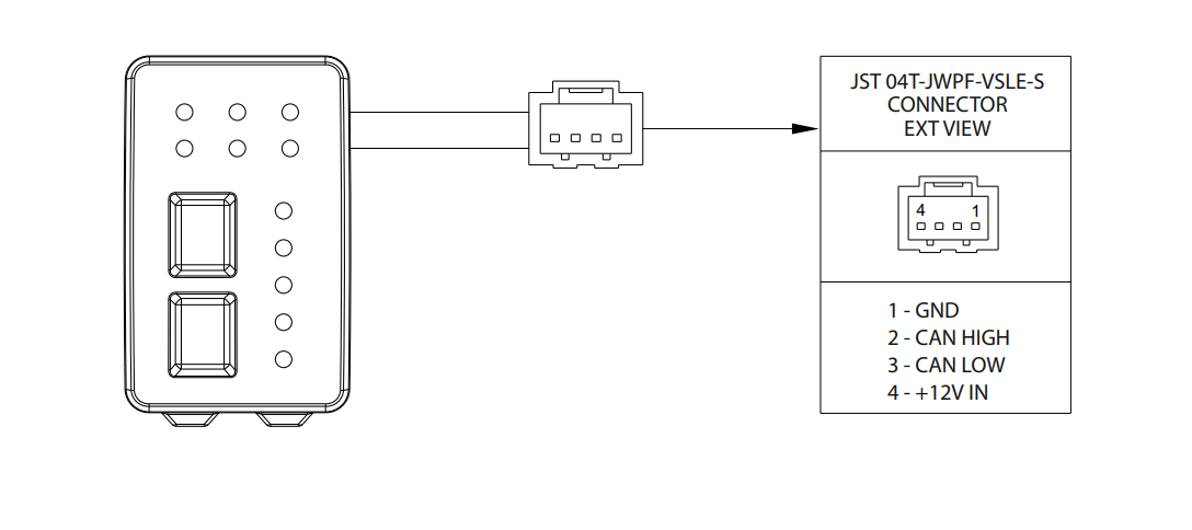

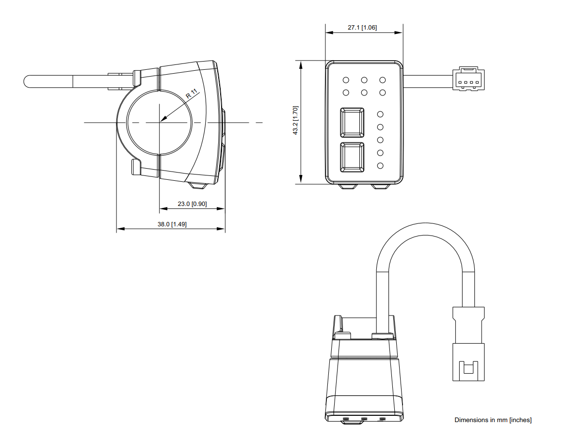

- JST waterproof connector for CAN Bus communication
- Connector: n.1 JST 04T-JWPF-VSLE-S Connector
- Body: PA6 + 30% glass fiber
- Dimensions: 47.3 x 24.9 x 48.1mm
- Waterproof: IP65
- Weight: 70g
