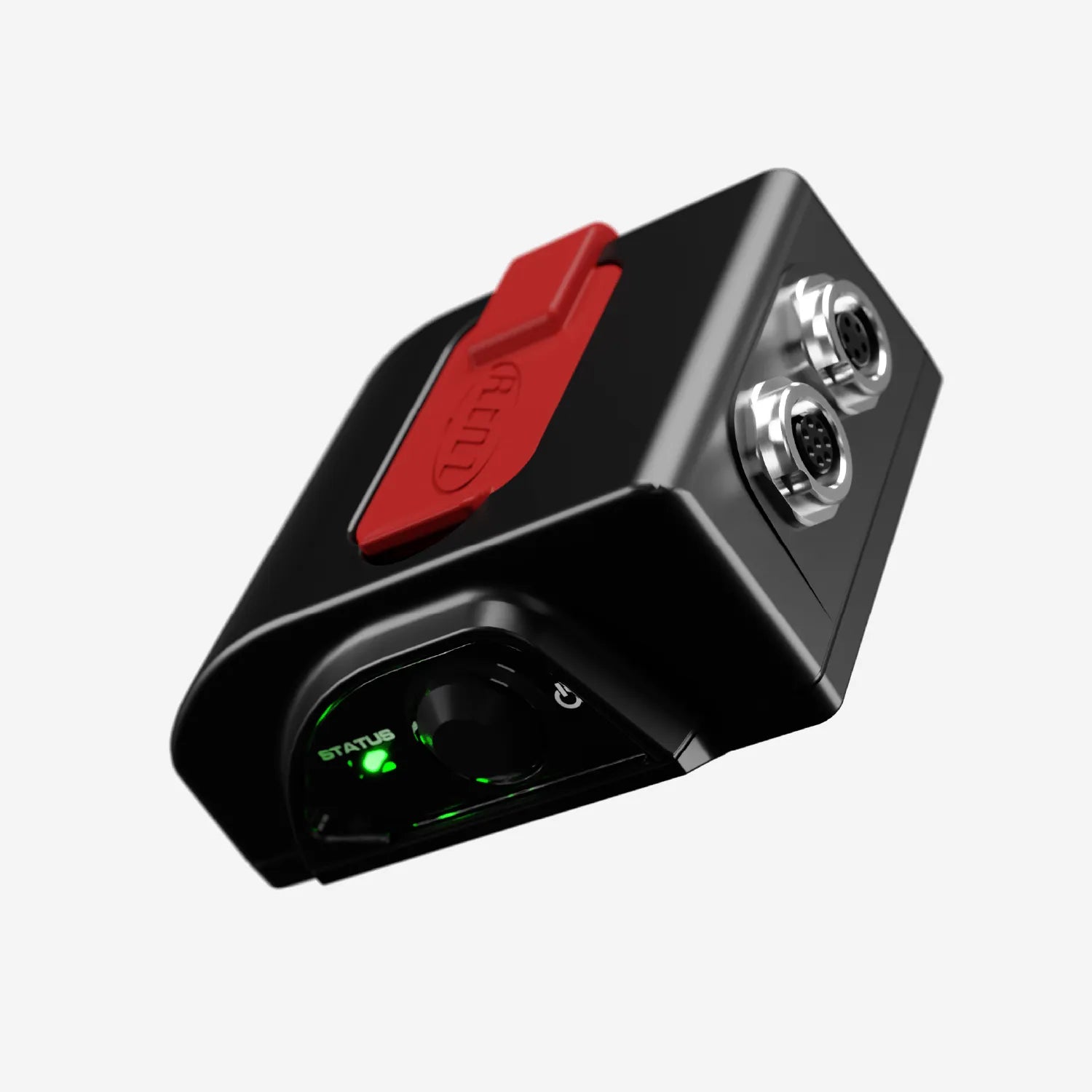

XLog data logger
Motorcycle riding on track
XLog Features
  • Lap times
  • Sector times
  • Vehicle position and speed
  • 3D acceleration and gyro
  • ECU data via CAN, K-Line or RS232 connections.
    (You can select the protocol of your car/bike among thousands of pre-defined protocols, or easily develop your own).
  • Digital RPM input from the primary of the coil (150-400V) or from a square wave (8-50V) when no ECU connection is available.
In addition, the XLog features a second CAN for connecting an external device or Aim Expansion, meaning you can add a Lambda Controller, analogue inputs, and a professional motorsport camera for enhanced functionalities.

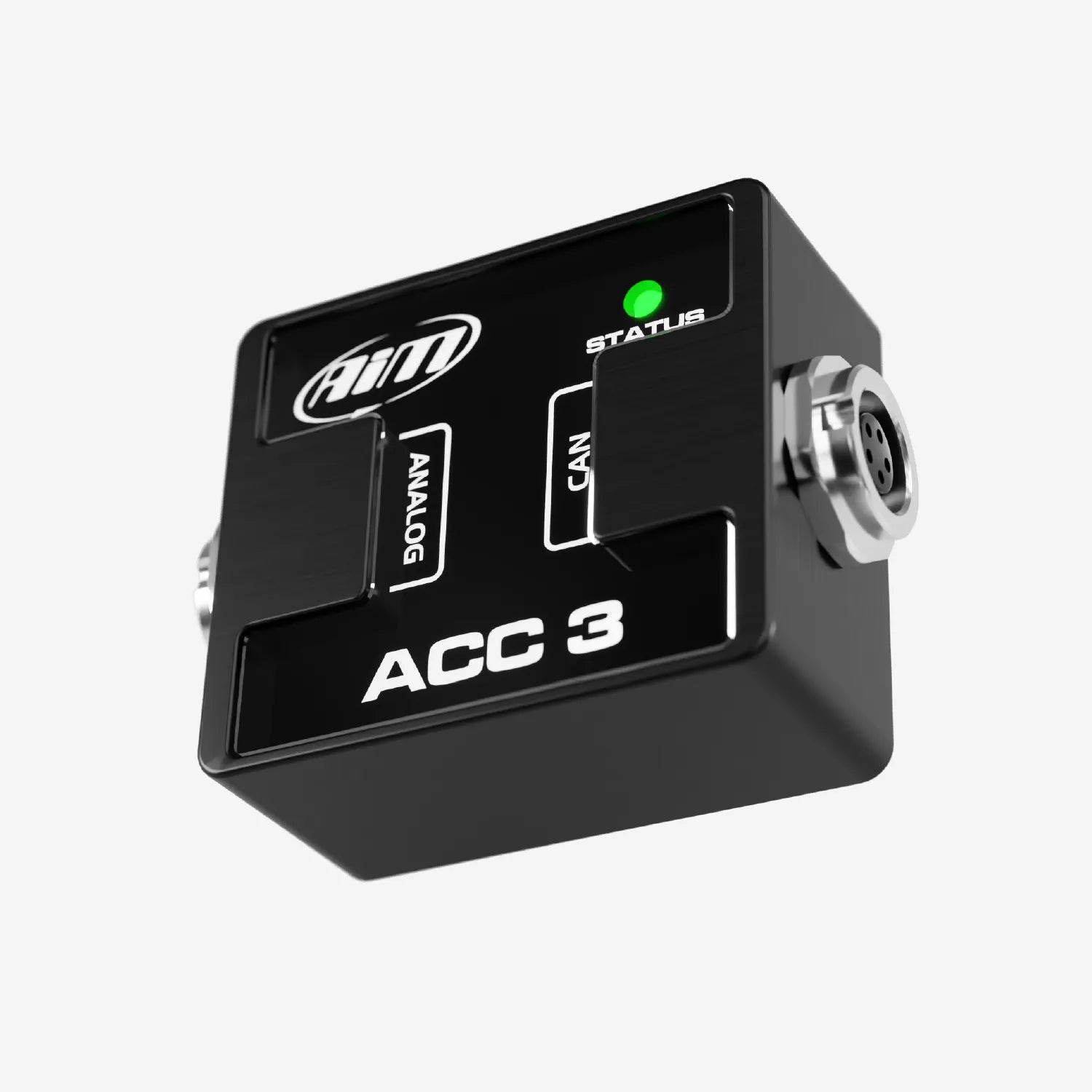

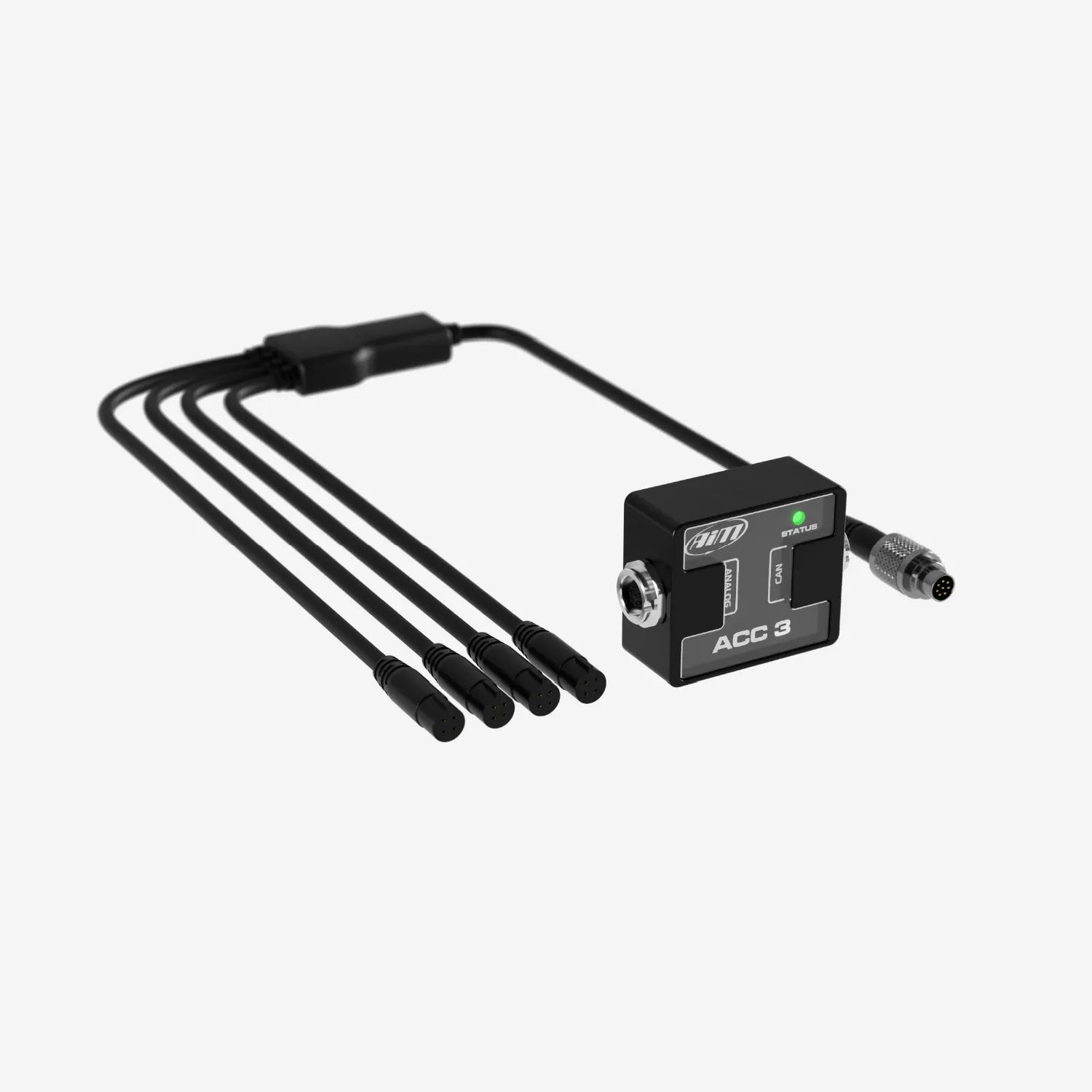

ACC3 with 4 channel harness
Like all Aim devices, the Aim ACC3 is built for motorsport applications. Its compact design ensures easy installation across a range of racing vehicles, while its robust construction guarantees reliability in demanding environments. When combined with Race Studio 3 software, the ACC3 unlocks powerful configuration and analysis tools, including suspension analysis with Aim Eclipse sensors and video synchronisation with SmartyCam 3 cameras.
  • Thermo Resistors
  • 0–5V Sensors
  • 0–12V Sensors
Inertial Platform in XLog
XLog GPS & Inertial Platform
  • Lap Timing & Sectors: Automatically recognises track layouts, samples laps and sectors, and provides all the raw data for Race Studio 3 analysis.
XLog connects with Race Studio software
XLog Connectivity
  • ECU Connection: Supports thousands of predefined CAN, RS232, or K-Line protocols, or you can build your own protocol via CAN builder.
  • Second CAN Option: Configure for Aim expansions, or connect additional sensors and third-party CAN devices.
  • Wireless: Integrated Wi-Fi and Bluetooth for fast, cable-free data transfer.
  • USB-C & Memory Key: 4GB internal memory plus a removable 16GB USB-C key for quick access.

  • ACC3 Analogue to CAN Converter: Add up to four analogue channels for pressure, temperature, suspension, and other sensors.

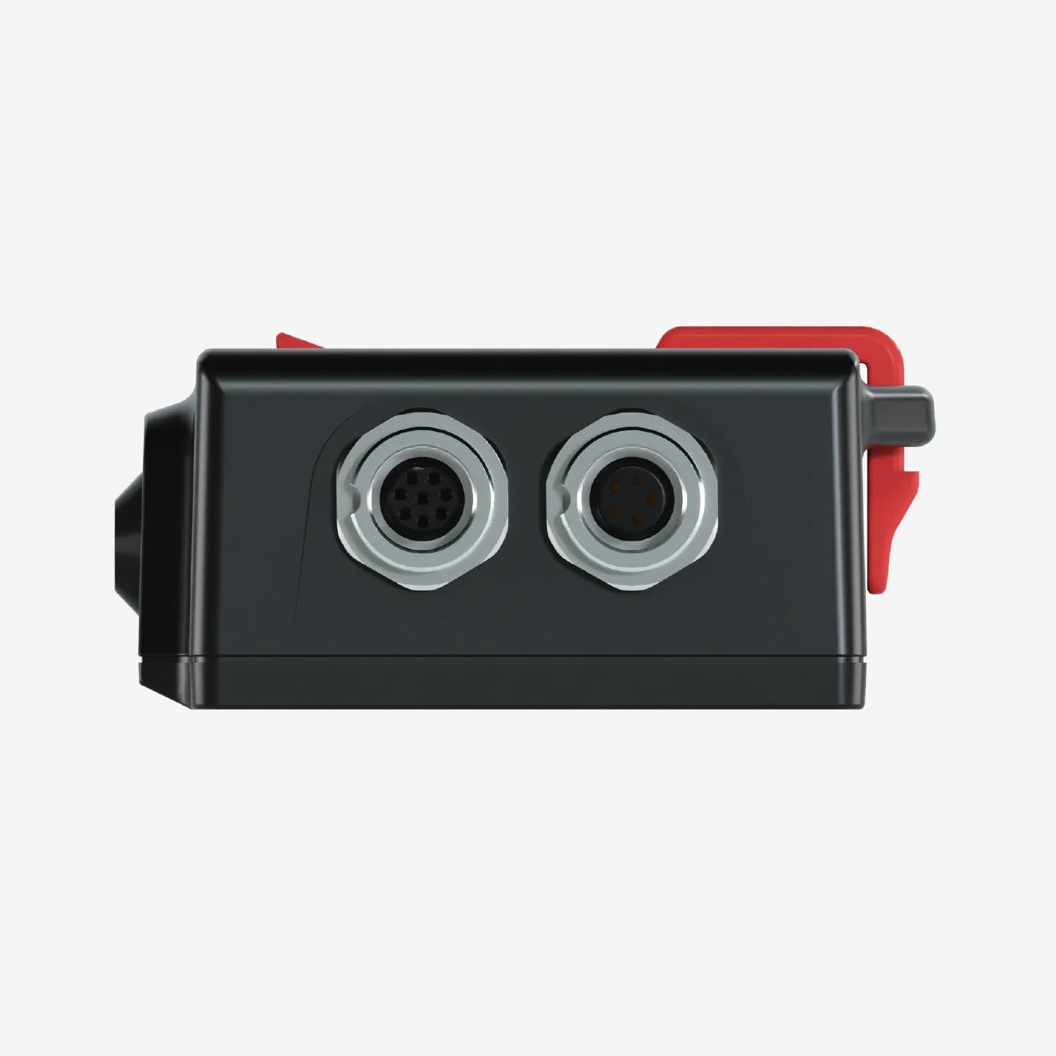

XLog
  • USB Connection: Yes
  • GPS: 25Hz
  • Wi-Fi: Built in
  • Bluetooth: Built in
  • Expansions: ACC3, Lambda Sensors, SmartyCam
  • RPM Input: 1
  • Push Button: 1
  • Status LED: 1
  • External Power: 9-15V
  • Weight: 150g approx.
  • Waterproof: IP65

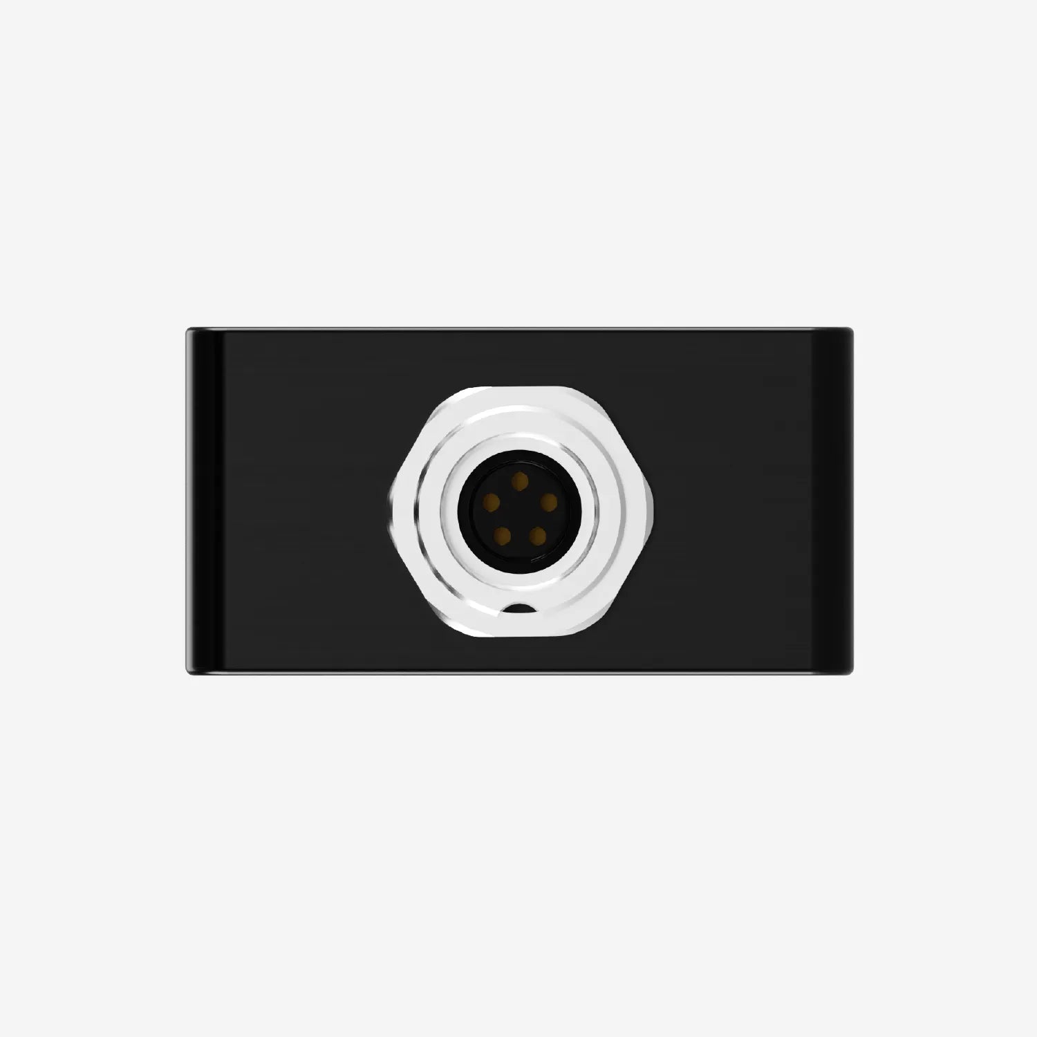

ACC3
  • Connection: CAN
  • Material: PA6 30% glass
  • Weight: 50g
  • Waterproof: IP65
SKU: ACC
