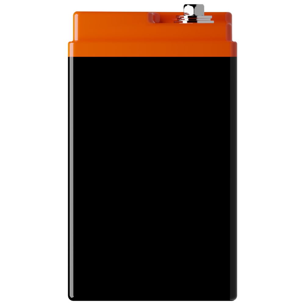

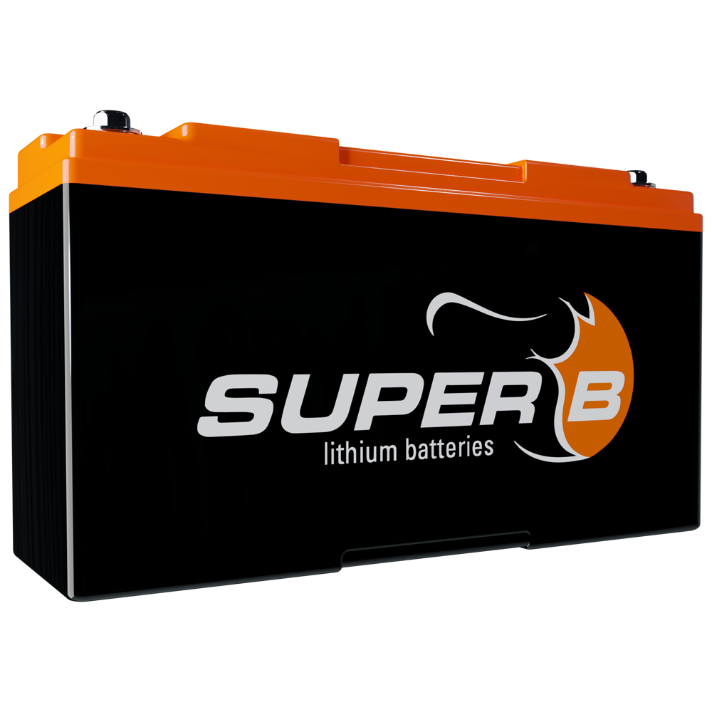

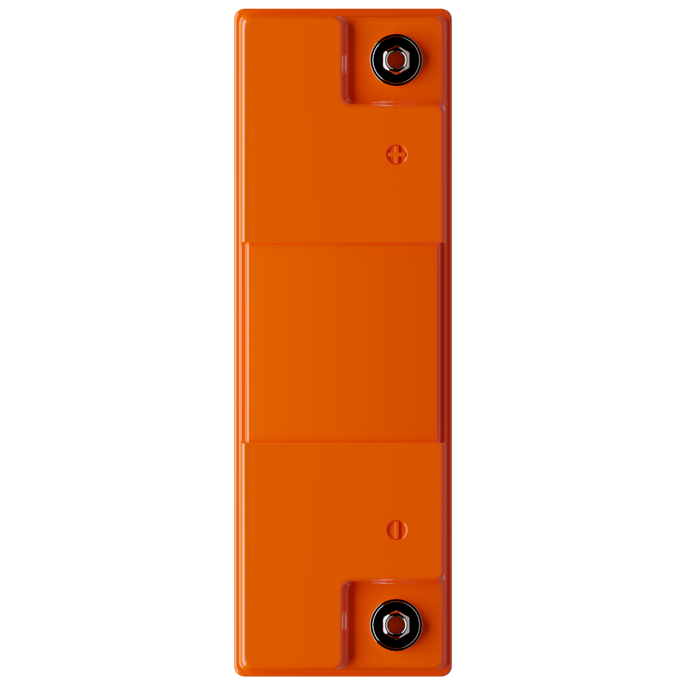

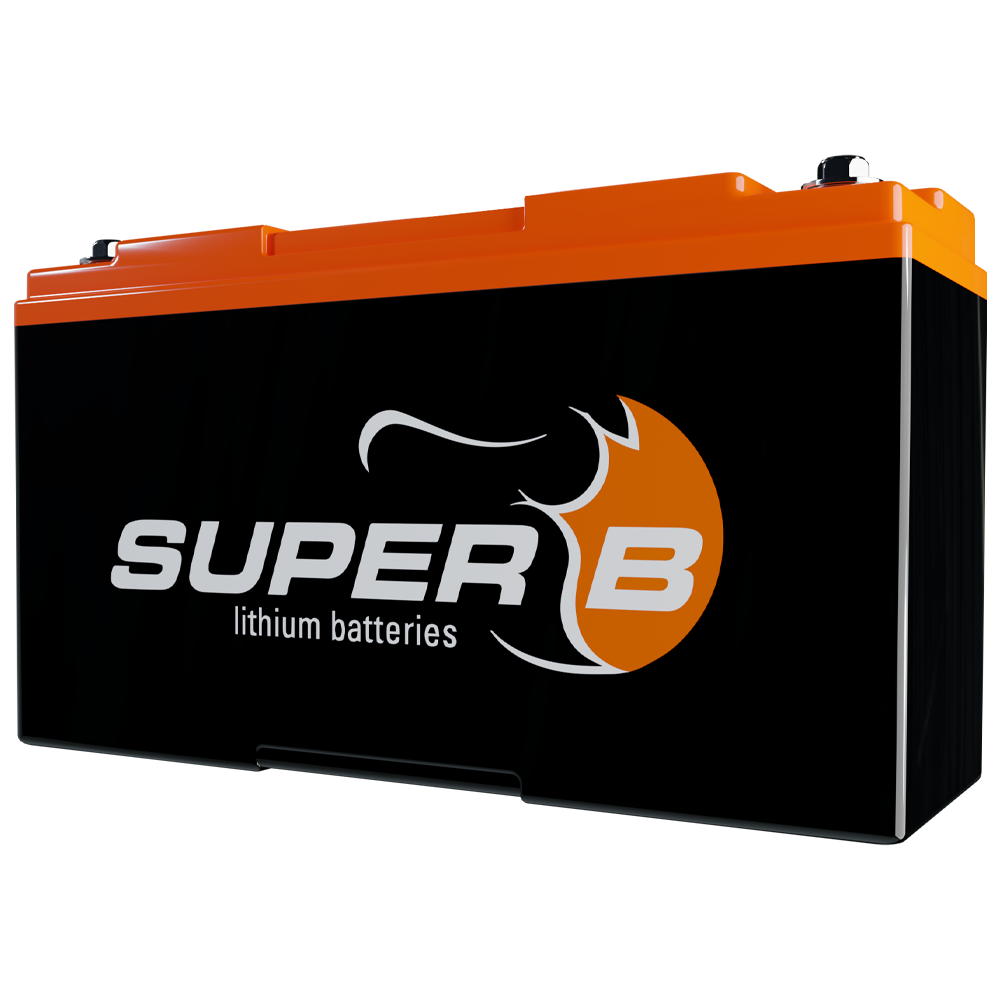

The Super B Andrena 12V20Ah-SC Lithium Battery delivers lightweight, high-performance power, designed specifically for motorsport and high-demand 12V systems. The Andrena 12V20Ah-SC battery equals a lead-acid battery of 70 to 100Ah, provided the alternator’s maximum current doesn’t exceed the battery’s maximum charge current of 66A.

The Super B Andrena 12V20Ah-SC Lithium Battery is compact in size, measuring in at 249 x 96 x 141mm and weighing 3.6kg, so it is perfect for vehicles that need a smaller power source with high energy capacity.
At only 1/3 of the size of traditional lead-acid batteries, the Super B Andrena 12V20Ah-SC Lithium Battery not only simplifies maintenance and installation in tight engine bays, but it also improves fuel economy and performance, delivering sharper handling, quicker acceleration and less strain on suspension components.

Electrical Specifications
  • Nominal Capacity: 20Ah
  • Energy: 256Wh
  • Nominal Voltage: 12.8V
  • Open Circuit Voltage: 13.2V
Mechanical Specifications
  • Dimensions (LxWxH): 249 x 96 x 141mm / 9.80” x 3.78” x 5.55”
  • Weight: 3.6kg / 8lbs
  • Case Material: PC - ABS
  • Ingress Protection: IP69
  • EAN-13: 8718531360075
  • Charge Method: CCCV
  • Max Charge Current: 66A
