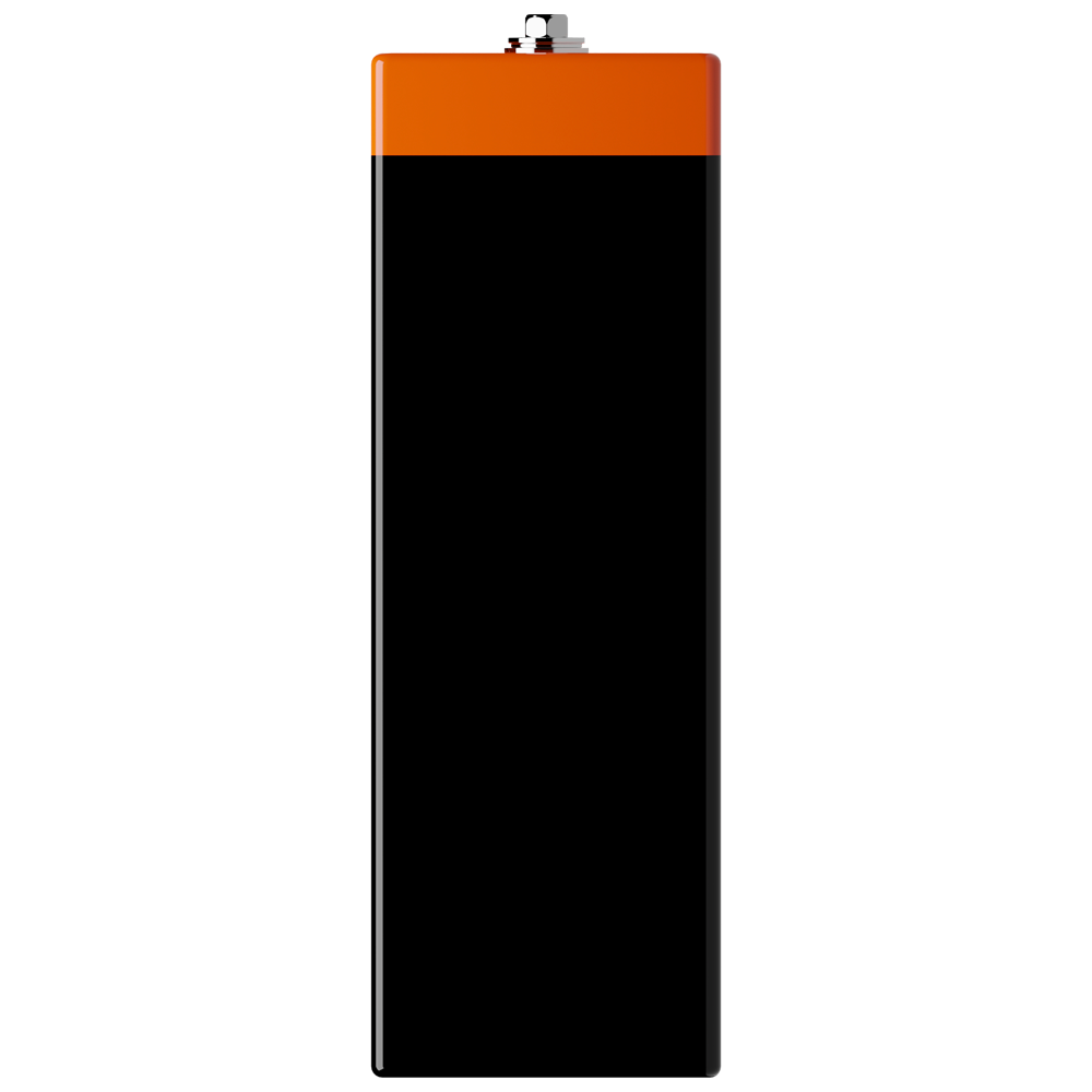

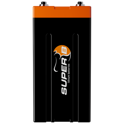

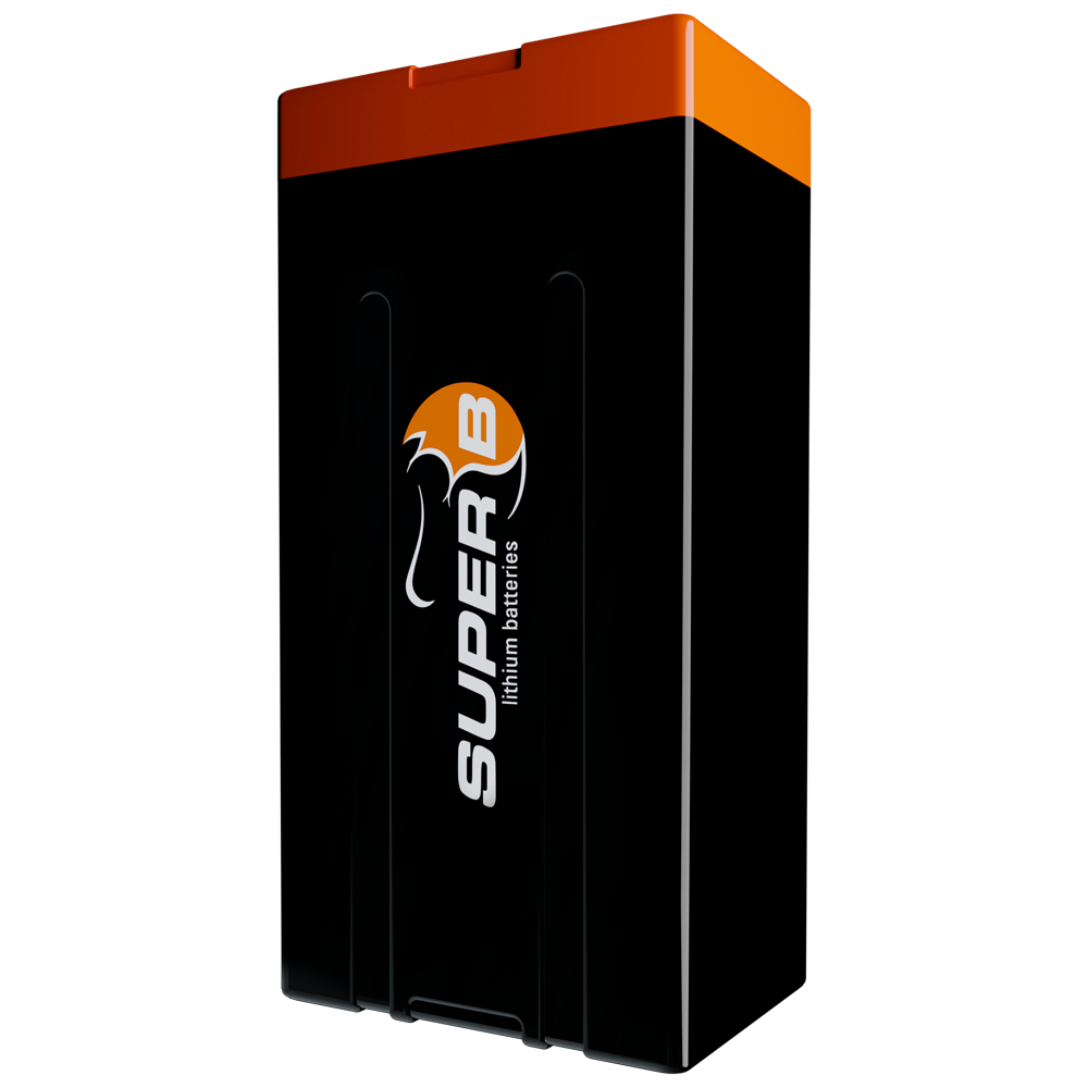

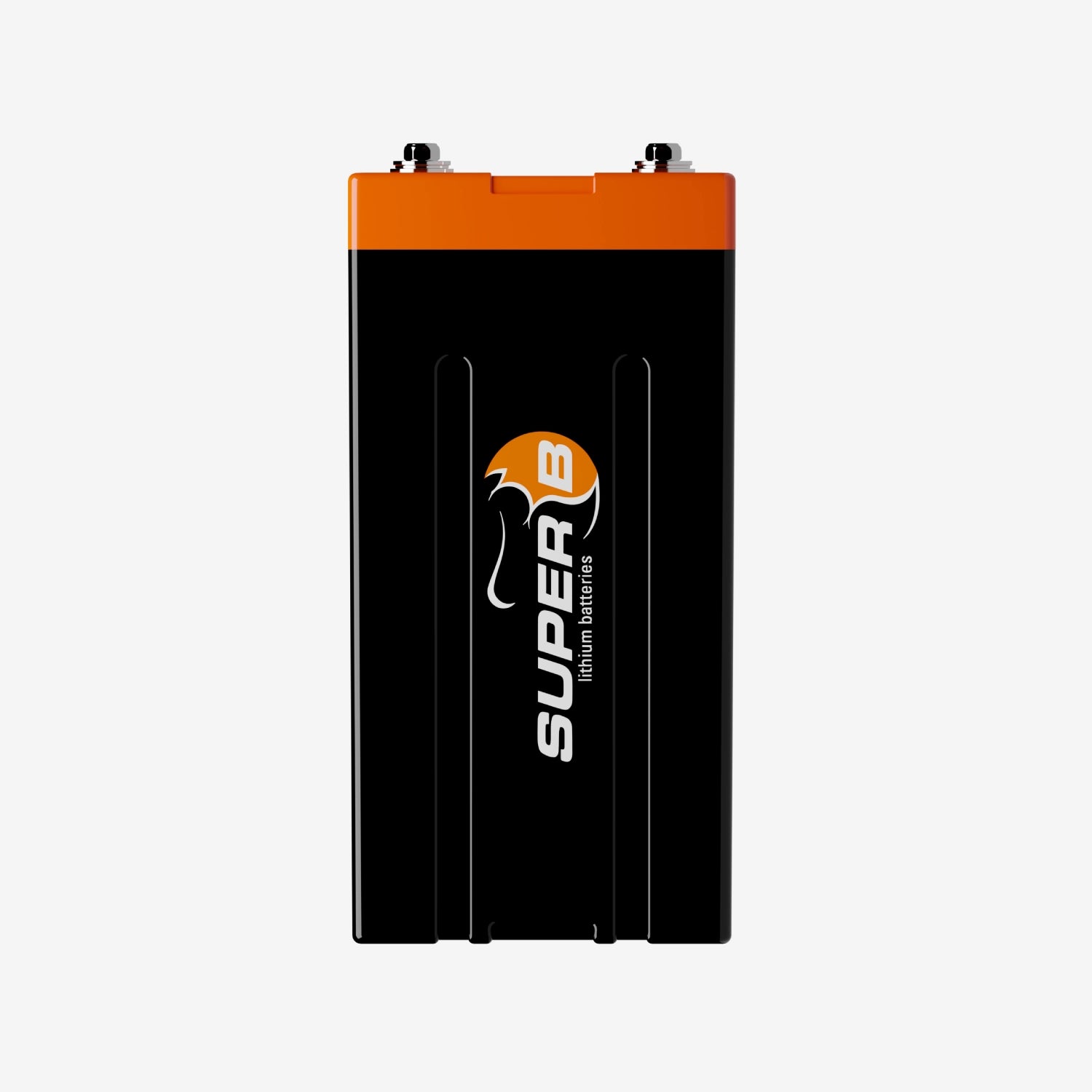

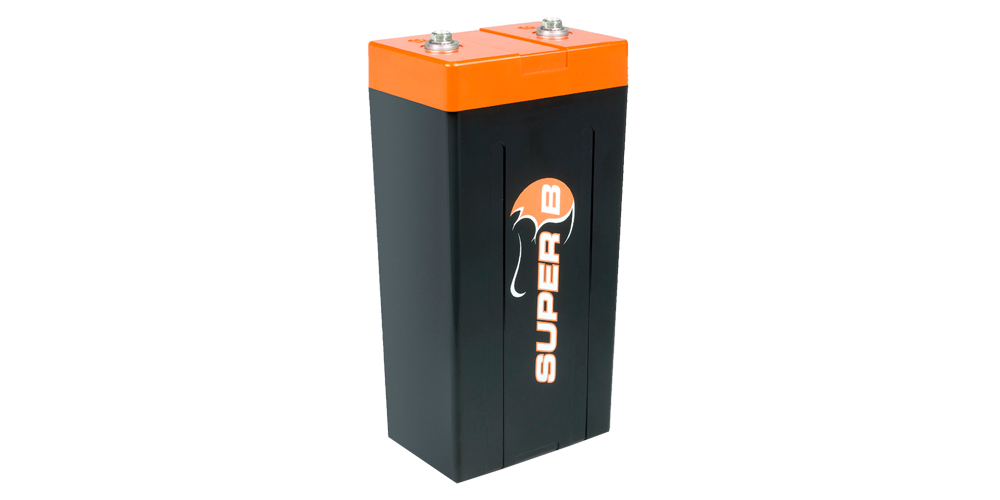

Motorsport Lithium Battery
The Super B Andrena 12V20Ah Lithium Battery delivers lightweight, high-performance power, designed specifically for motorsport and high-demand 12V systems. The Andrena 12V20Ah battery equals a lead-acid battery of 70 to 100Ah, provided the alternator’s maximum current doesn’t exceed the battery’s maximum charge current of 66A.
Why Choose the Super B Andrena 12V20Ah Battery
As the Andrena Battery is very lightweight and compact, it can fit with ease in any vehicle and eliminates the need to constantly check on it due to its low maintenance features. The fast-charging aspect of the battery, combined with the minimal self-discharge rate, means that the battery life is long-lasting and quick to refill, ensuring that usage of the Super B Andrena 12V20Ah Lithium Battery is maximised. With lithium iron phosphate (LiFePO4) technology, combined with its waterproofness, it is the safest and most reliable battery on the market.

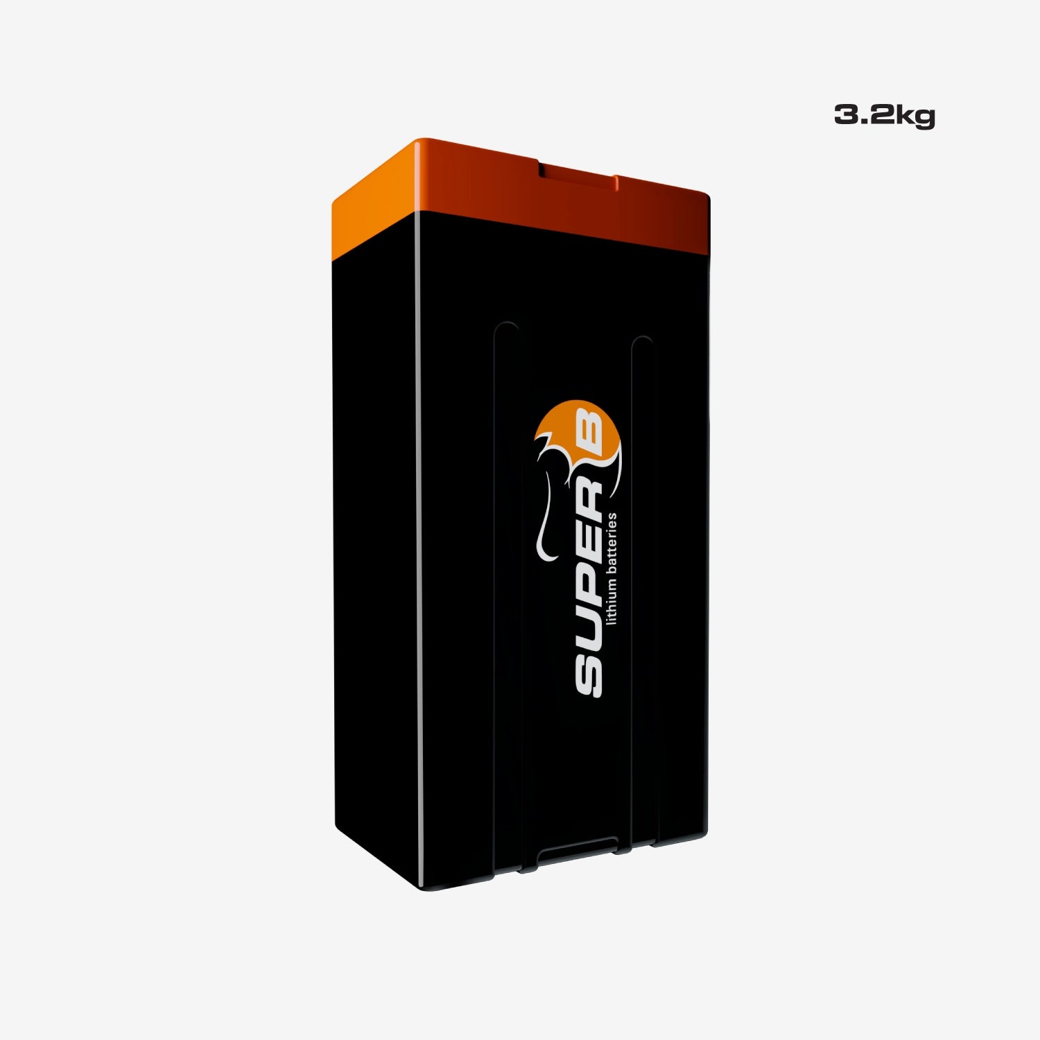

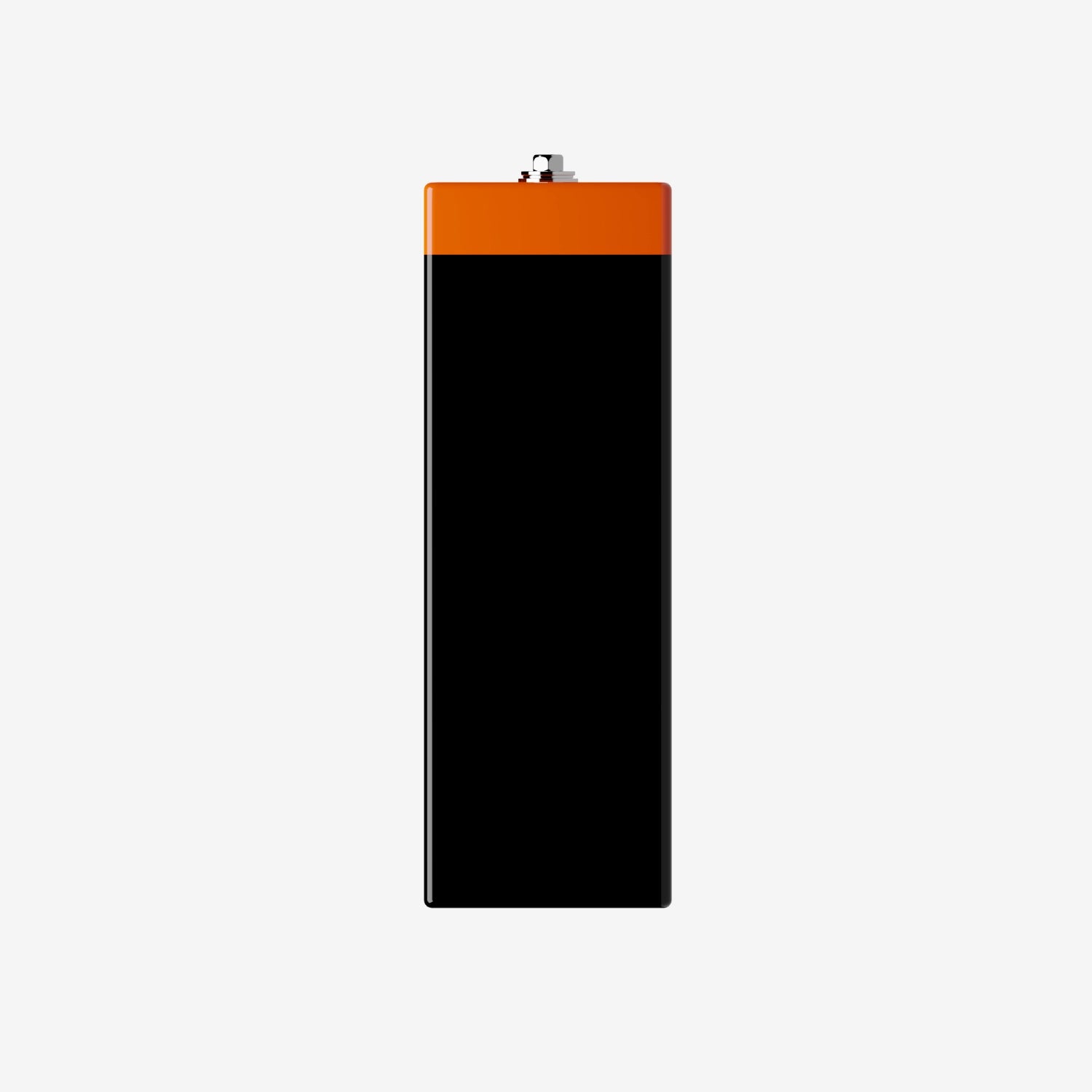

Lightweight Power
The Super B Andrena 12V20Ah Lithium Battery is compact in size, measuring in at 120 x 82 x 238mm and weighing 3.2kg, so it is perfect for vehicles that need a smaller power source with high energy capacity.
At only 1/3 of the size of traditional lead-acid batteries, the Super B Andrena 12V20Ah Lithium Battery not only simplifies maintenance and installation in tight engine bays, but it also improves fuel economy and performance, delivering sharper handling, quicker acceleration and less strain on suspension components.
High-Performance
The Super B Andrena 12V20Ah Lithium Battery delivers exceptional power with a stable and flat discharge curve, meaning over 80% of its capacity is usable. It supports high continuous and pulse discharge currents, making it ideal for demanding motorsport applications.
Safe & Reliable
3-Year Warranty
The Super B Andrena 12V20Ah Lithium Motorsport Battery comes with a 3-year manufacturer warranty and support from Aim Shop’s experienced technical team for your peace of mind. Super B provides batteries that have been engineered and tested against the harshest of environments to ensure high performance for years to come.

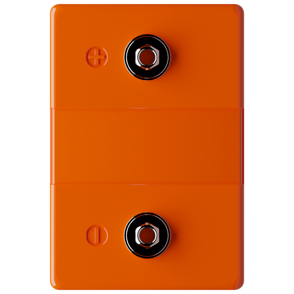

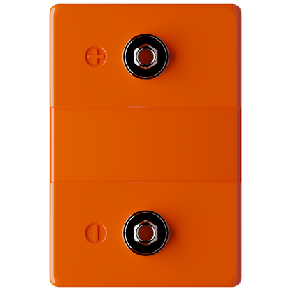

Electrical Specifications
  • Nominal Capacity: 20Ah
  • Energy: 256Wh
  • Nominal Voltage: 12.8V
  • Open Circuit Voltage: 13.2V
Mechanical Specifications
  • Dimensions (LxWxH): 120 x 82 x 238mm / 4.72” x 3.23” x 9.37”
  • Weight: 3.2kg / 7lbs
  • Case Material: PC - ABS
  • Ingress Protection: IP69
  • EAN-13: 8718531360051
  • Charge Method: CCCV
  • Max Charge Current: 66A
