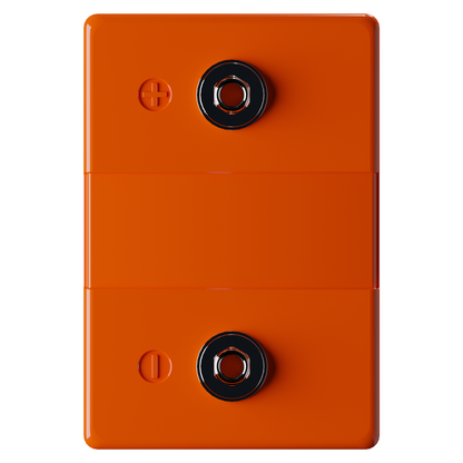

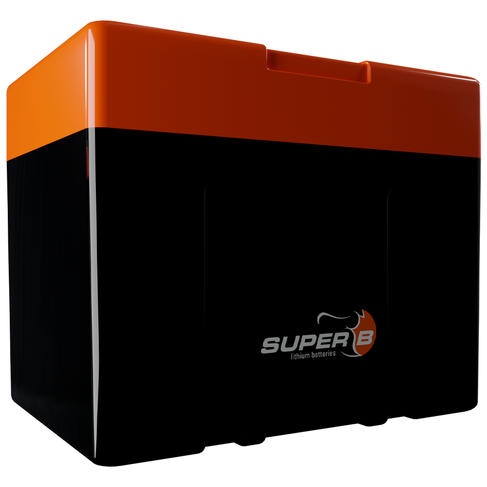

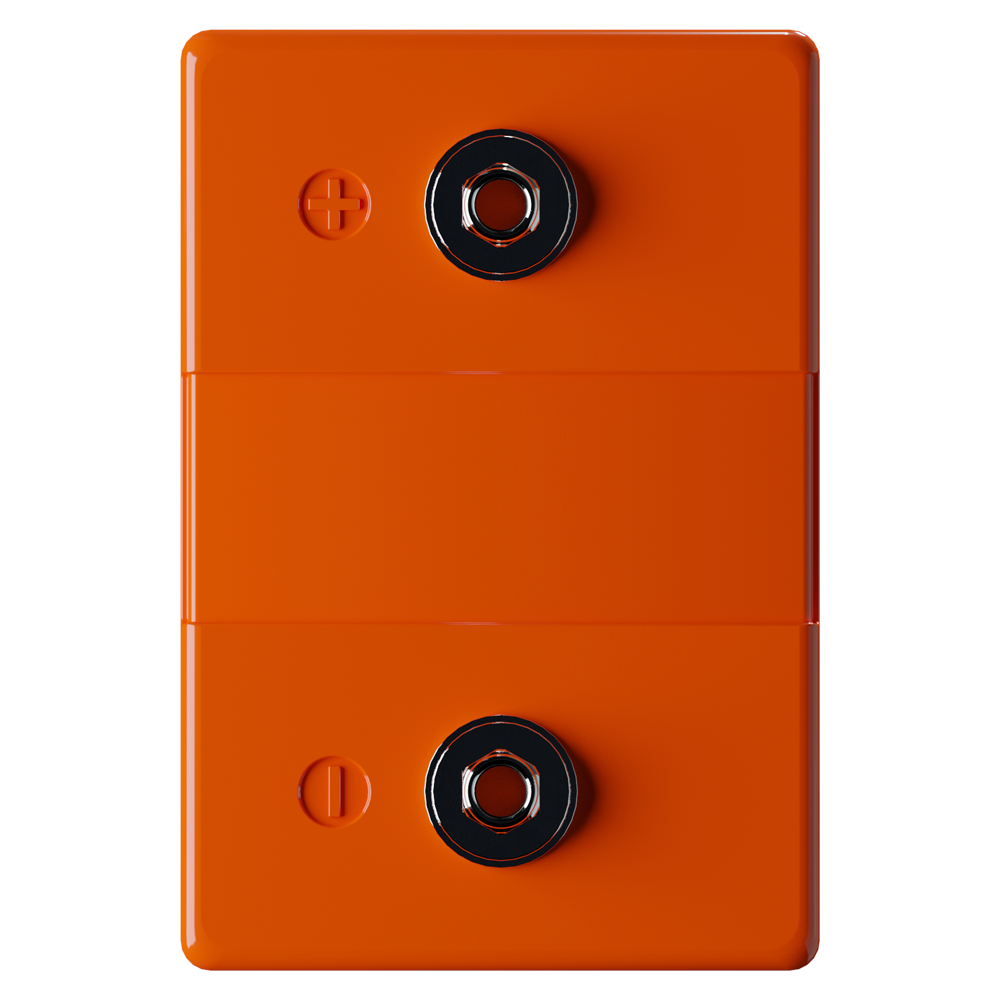

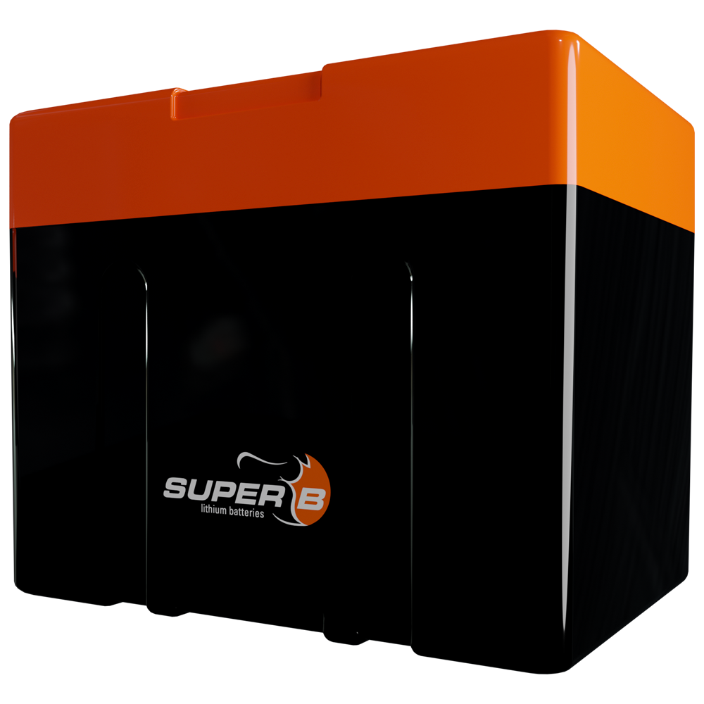

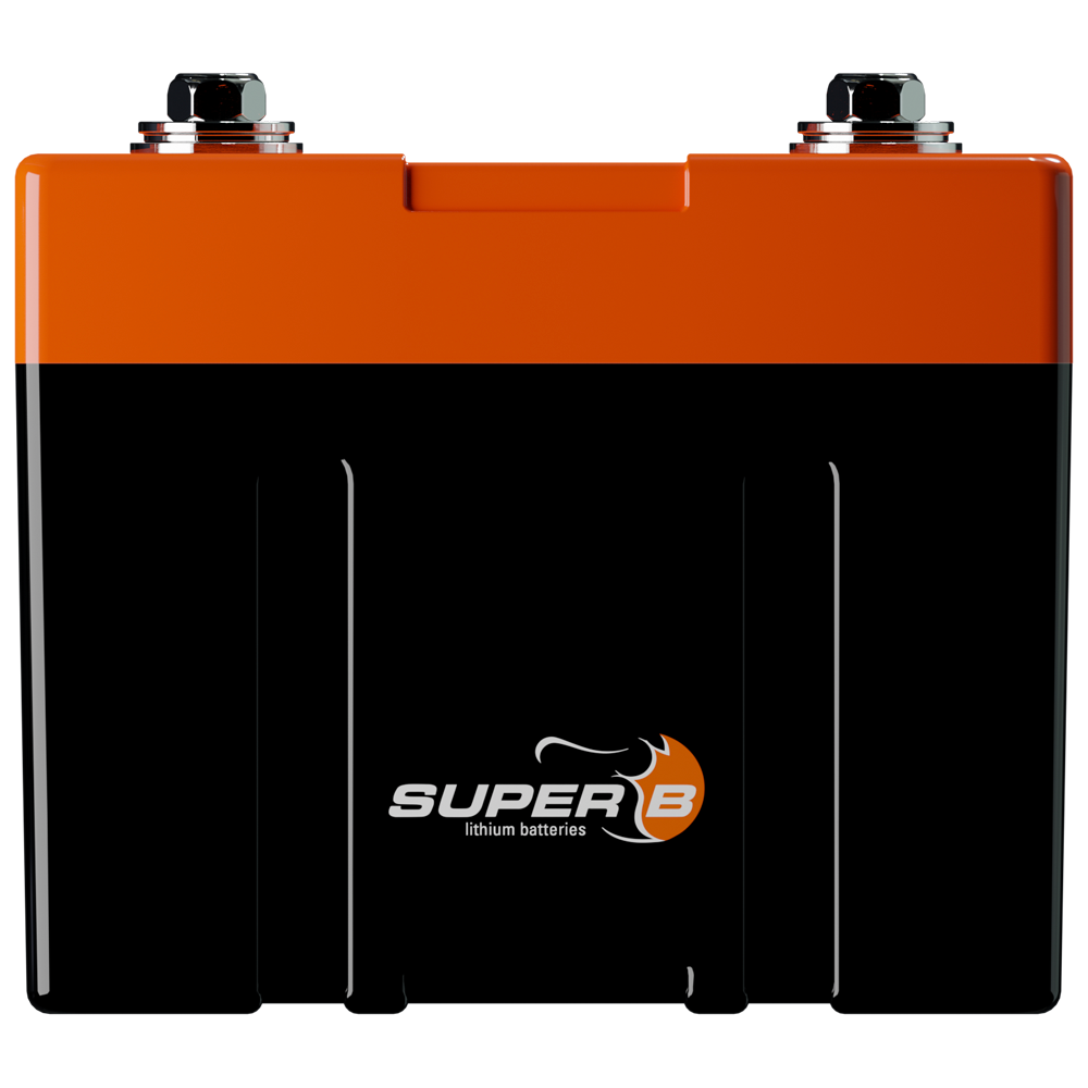

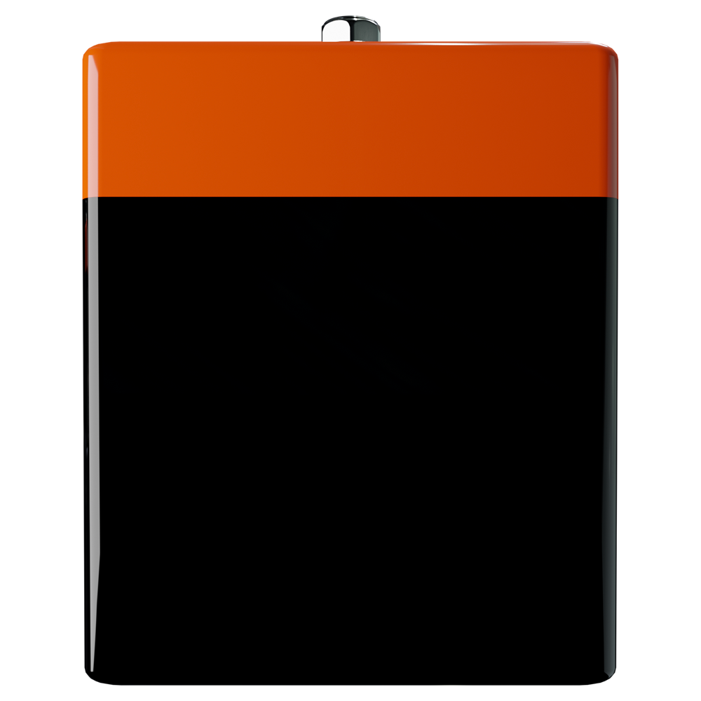

    Super B Andrena 12V7.5Ah Lithium Battery
    Light-weight, high-performance, safe and reliable lithium power battery, especially  developed for motorsports. This battery equals a lead-acid battery of 12 to 20Ah, provided the  alternator’s maximum current doesn’t exceed the battery’s maximum charge current of  27A. Designed in a standard rally casing. Suitable for 12V systems and for use in extreme  environments.
    Lightweight Power
    With a weight of only 1.3kg / 3.0lbs, the Andrena 12V7.5Ah power battery saves up to 80% in weight in comparison to traditional lead-acid batteries and is only 1/3 of the size of a conventional battery. This improves not only the performance of your vehicle but also helps to increase the fuel economy.
    The power battery offers a high level of power, fast charging and a long, maintenance-free service life. It also has a stable and flat discharge which means you have over 80% of the batteries capacity available and you can leave your vehicle unattended for a much longer period compared to a lead-acid battery.
    Safe & Reliable
    Super B batteries are based on lithium iron phosphate technology (LiFePO4). This is the safest lithium technology available today. On top of that our bespoke casing and electronics further increase safety and durability. Due to its high ingress protection class (IP69) the battery is completely dust tight and waterproof. Therefore the battery can be used in the most extreme environment as well.

    ELECTRICAL SPECIFICATIONS
    Nominal Capacity 7.5Ah
    Energy 96Wh
    Nominal Voltage 12.8V
    Open Circuit Voltage 13.2V
    Self Discharge <3% per month
    Cycle life >1000 (at 10C charge/discharge, 100% DoD)
    EqPb (Equals lead-acid)  12 to 20Ah
    MECHANICAL SPECIFICATIONS
    Dimensions (LxWxH) 120 x 82 x 98mm | 4.72” x 3.23” x 3.86”
    Weight 1.3 kg / 3.0lbs
    Case Material PC - ABS
    Ingress Protection IP69
    Cell Type / Chemistry Cylindrical - LiFePO4
    Charge Method CCCV
    Charge Voltage 14.3V - 14.6V
    Max Charge Current 27A
    End of Discharge Voltage 8V
    Discharge Current Continuous 120A
    Discharge Pulse Current (1 sec) 175A (50C)
    TEMPERATURE SPECIFICATIONS
    Charge Temperature 0°C to 45°C1 | 32°F to 131°F1
    Discharge Temperature -20°C to 55°C | -4°F to 131°F
    Storage Temperature -20°C to 45°C | -4°F to 113°F
    COMPLIANCE SPECIFICATIONS
    Certifications CE, UN 38.3, UL 1642 (Cells)
    Shipping Classification UN 3480
    1 Do not charge below 0°C / 32°F
