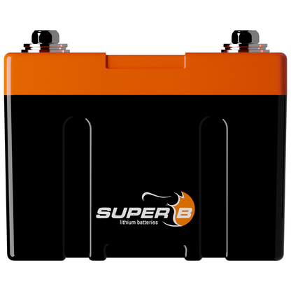

The Super B Andrena 12V5Ah Lithium Battery is compact in size, measuring in at 114 x 62 x 84mm and weighing 0.85kg, so it is perfect for vehicles that need a smaller power source with high energy capacity.

  • Dimensions (LxWxH): 114 x 62 x 84mm / 4.49” x 2.44” x 3.30”
  • Weight: 0.85kg / 1.8lbs
