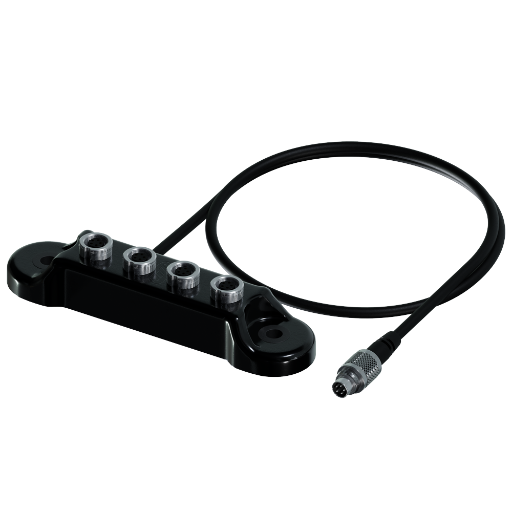

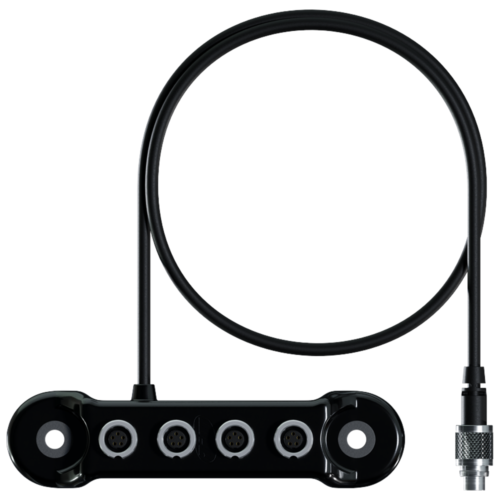

Four-Way CAN Connection Multiplier
The compact four-way data hub provides four additional CAN channels and works as an interface between the Aim logger and accessories.
Why Choose the Four-Way Data Hub
Using many devices can result in excessive wiring. Thanks to the data hub, it can eliminate all unnecessary wiring. Aim data hubs take all the information you need to your logger with only one cable, minimising wires overall.
Aim data hubs are available in the following versions to suit your setup:
- Four-way data hub
- Two-way data hub
- Two-way data hub with external power cable
Connections
Additional devices, such as GPS modules, TC hubs (thermocouple multipliers), SmartyCams and Lambda sensors, can be added to provide extra data from your vehicle and improve performance. You can also use the four-way data hub with our MX series dashes and loggers, powered by the vehicle's 12V onboard battery supply.
Note: You can connect multiple data hubs to build a wider network.
Four-Way Data Hub
What sizes are available for the Aim Four-Way Data Hub CAN Connection Multiplier?
The Aim Four-Way Data Hub CAN Connection Multiplier is available with 40cm or 150cm cable length options to suit your setup.
