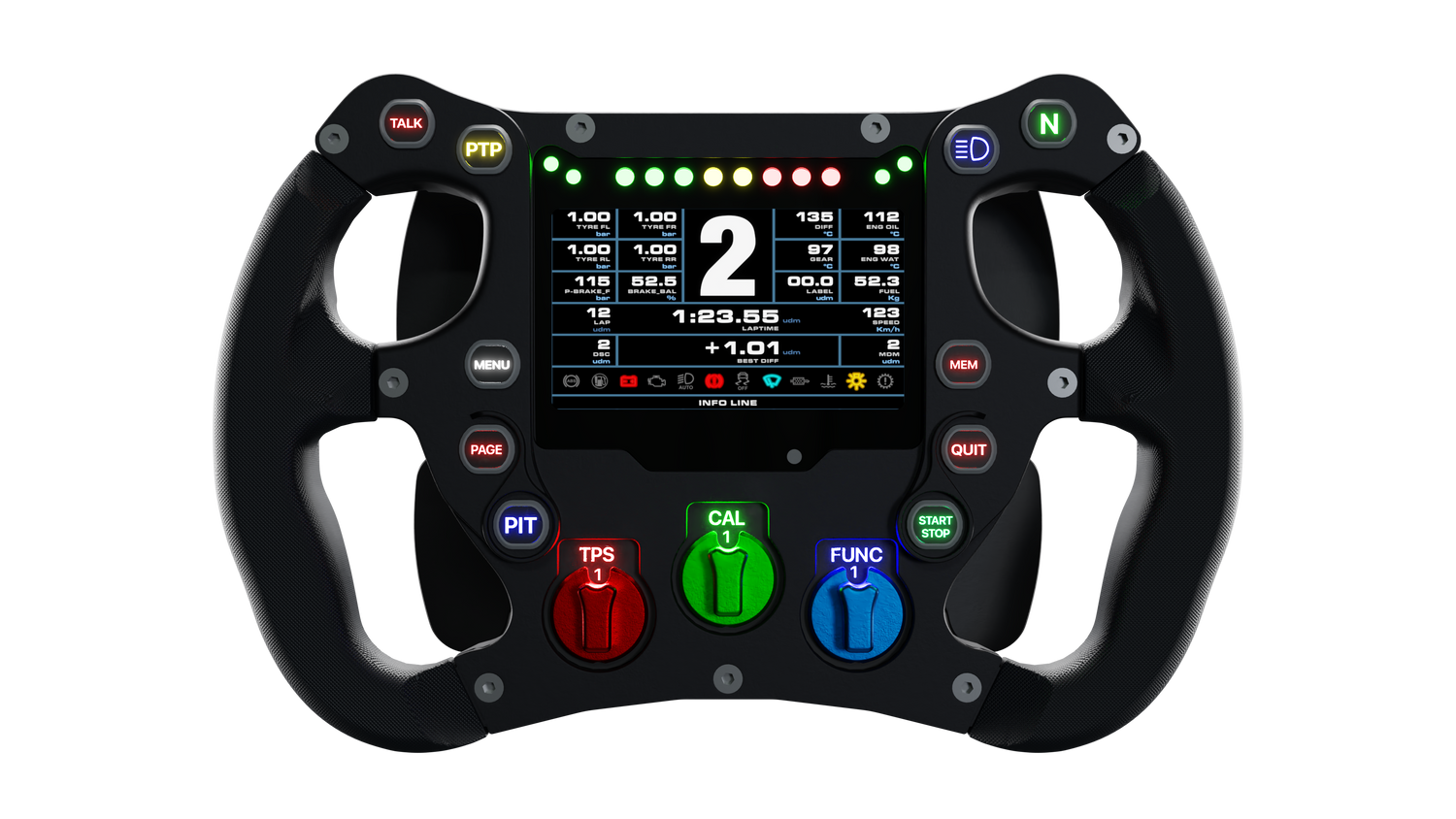

The Formula Steering Wheel 4 270 has a high contrast 4.3" TFT display that is fully configurable and fully sunlight viewable. With the added ambient light sensor, the display stays straightforward to read. The wheel has eight visible shift lights and four-alarm RGB LEDs. The display is a high-quality solution for a formula wheel delivering clear, precise, and easy-to-read information to the driver.

The AiM Formula Steering Wheel 270 has eight configurable shift light RGB LEDs and four configurable alarm RGB LEDs. You can choose the conditions and colours. Select a solid alarm or flashing one and the flashing frequency. You can choose to have an accompanying text message and set the alarm priorities.
With integrated shift lights, you can choose from a host of advanced multi-coloured RGB shift light patterns that you can customise to suit your requirements and each unique gear when required.

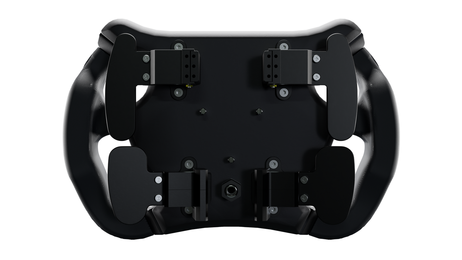

 We offer a clutch paddle kit with the bottom left and right paddles or can be brought separately as either left or right, See the drop-down at the top of the page.
