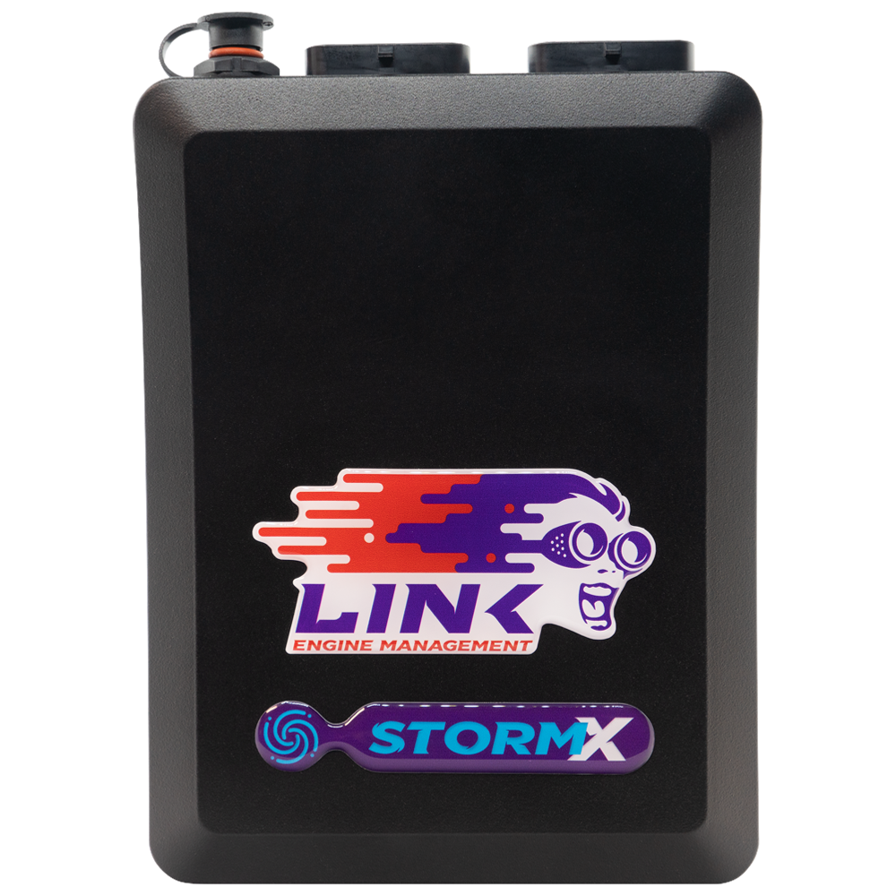

Link G4X StormX WireIn ECU
The Link G4X StormX ECU is the latest version of our trusty, mid-sized ECU. With eight injector and eight ignition drives, it allows sequential injection and direct spark on engines with up to eight cylinders or four rotors.
The StormX has all the upgrades of the AtomX and MonsoonX but offers more advanced tuning features like a built-in Trigger Oscilloscope, Stepper Motor Idle Control, Rotary Oil Metering Pump Control, Onboard Knock Control, Open and Closed Loop Boost Control plus most Motorsport features including Full Gear Shift Control, Antilag and Launch Control.
The StormX has expanded data logging and is more responsive with a higher bandwidth than its G4+ Storm predecessor. G4X features 512 megabytes of logging at 32bit using up to 250 channels, each limited to up to 1kHz per channel (by the Operating System), with a maximum of 100 kSamples/sec.
It also features 8 x faster communications speed, allowing you to download logs 8 x faster and pushes all the logging quickly up to a new and improved PCLink – available for download in the tab.
* Requires "A" & "B" looms or "A" & "B" connector kits.

Inputs
8 x Digital inputs
3 x Temperature inputs
8 x Analog inputs
2 x Trigger Inputs
2 x Knock Inputs
Outputs
8 x Injection drives
8 x Ignition drivers
8 x Auxiliary outputs^
+5V Sensor power supply
+8V Sensor power supply
^unused fuel and ignition drives can be used as additional Aux outputs
Communications
1 x CAN bus
1 x USB tuning connection
Upgraded communications chip (at least 8 x faster than G4+ V2)
