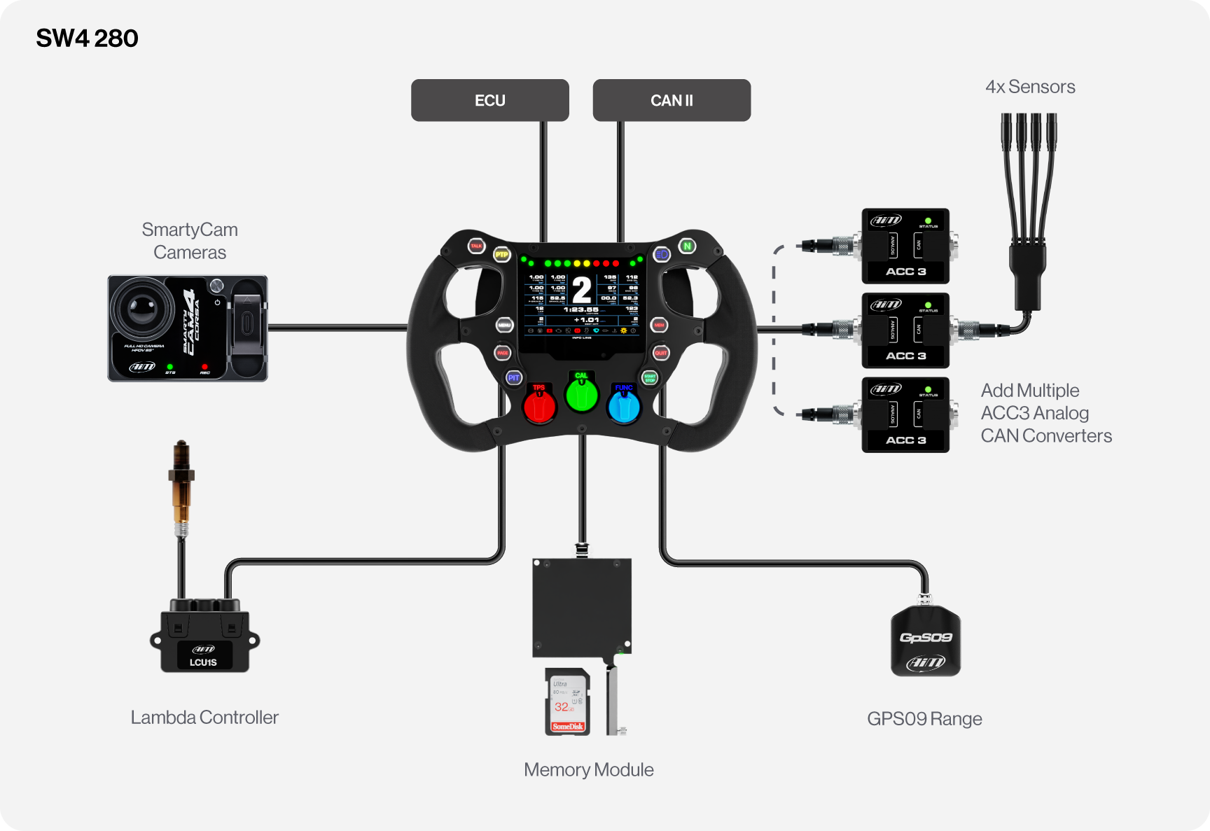

With CAN output, you can send messages to other Aim sim racing devices or expansions, broadening your cockpit’s range of telemetry and control options.

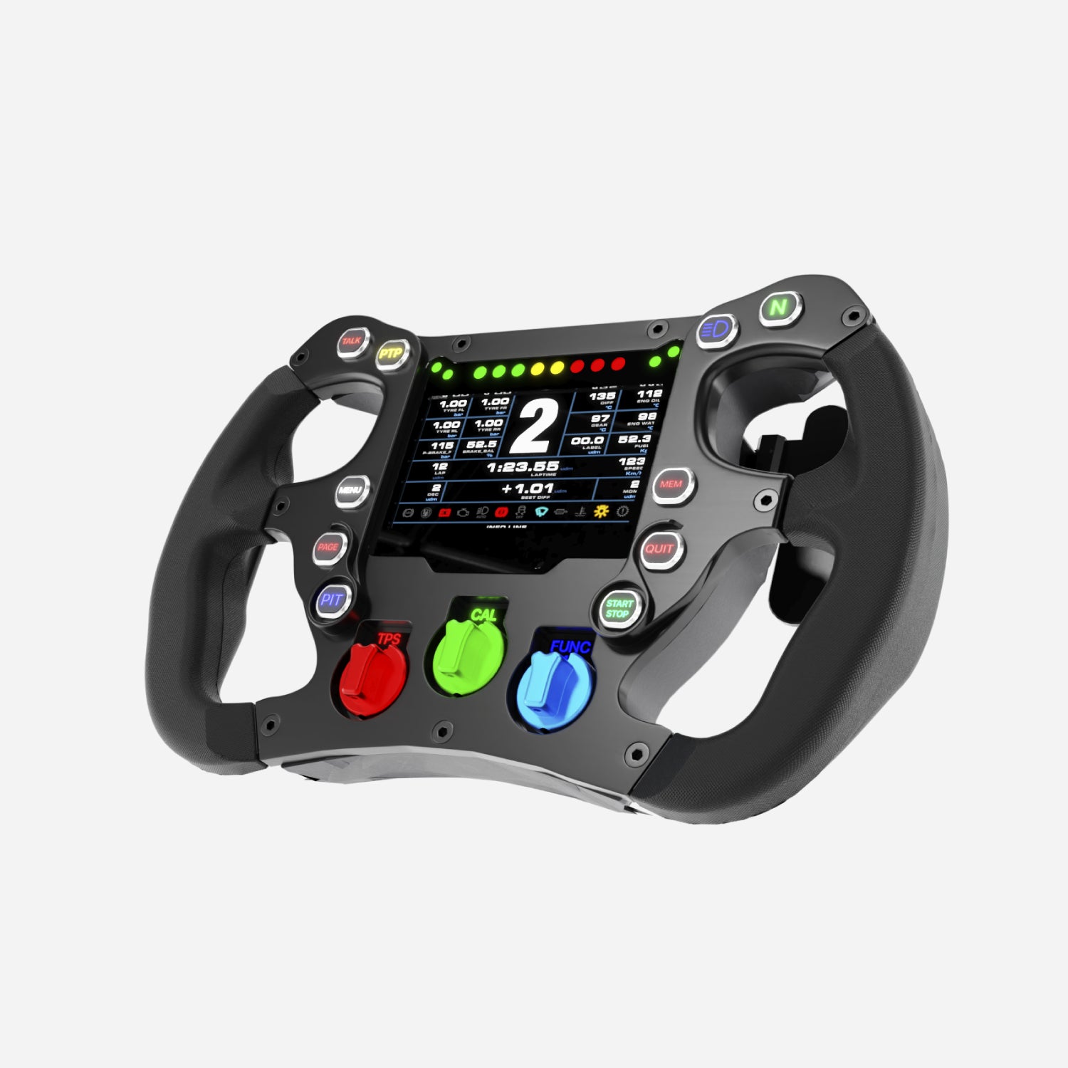

The 280 Formula Sim Racing Steering Wheel has a high-contrast 4.3" TFT display that is fully configurable and easy to read in all conditions. With the ambient light sensor, the display automatically adjusts brightness to stay clear and comfortable.
The Formula Steering Wheel also features 10 push buttons and 3 rotary switches, all backlit with RGB LEDs for enhanced usability in your sim racing rig.
Flexible Alarms
The Aim 280 Sim Racing Formula Steering Wheel has 8 configurable shift light RGB LEDs and 4 configurable alarm RGB LEDs. You can choose the conditions and colours, whether solid or flashing, flashing frequencies, and display on-screen messages alongside them.
With integrated shift lights, you can choose from a host of advanced multi-coloured RGB shift light patterns that you can customise to suit your requirements and even configure them per gear.

  • GPS Module: When used in sim environments, the GPS Module enables lap time calculation and virtual track position analysis, with a database of thousands of circuits available.
  • CAN Connections: 3
  • ECU Connection: CAN
  • ECU Compatibility: 1,000+ industry-leading ECUs
  • Shift Lights: 8 configurable RGB LEDs
  • Ambient Light Sensor: Yes
  • Expansion CAN Connection: GPS Module, Channel Expansion, TC Hub, Lambda Controller, SmartyCam, RIO Module, GS-Dash, Memory Module

Aim SW4 Steering Wheels are compatible with other Aim devices and data logging systems, such as the ACC3 Analogue CAN Converter, SmartyCam Cameras and various sensors. This allows for a more detailed and advanced data collection and analysis, making it a very versatile product for different motorsport applications.
