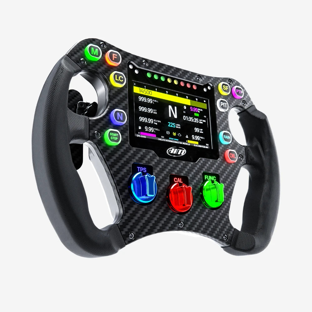

Our latest evolution in motorsport steering wheel technology combines advanced data integration, enhanced ergonomics, and full customisation in a compact 270mm design. The Formula Steering Wheel 4 270mm (MY26) is built for professional drivers and high-performance formula racing applications, delivering precise control, real time data visibility, and seamless adaptability to any race setup.
Why Choose the Aim 270 (MY26) Steering Wheel
The SW4 Steering Wheels support over 2,000 ECU protocols, ensuring compatibility with a wide range of vehicles and driver requirements. The high-contrast customisable TFT display offers multiple layout options, allowing drivers to view real time data in their preferred format.
The SW4 270 (MY26) introduces several enhancements, such as a stronger and lighter construction - built with a polymer and carbon front panel, a HBNR hydrocarbon-resistant compound, and a CNC-machined aluminium base. It has improved ergonomics: all buttons and rotary switches are within easy thumb reach, and an optimised design with reduced and refined thickness in the lower section. Key data can be displayed both during the race and after each session. You can select which data to view during configuration for a tailored experience.
Connecting the Aim 270 (MY26) Formula Steering Wheel to your ECU is straightforward. You can choose between a coiled cable with a 22-pin Autosport connector, or a free-wire cable for Quick Release systems.
Display & Push Buttons
The Aim Formula Steering Wheel 4 270 (MY26) is equipped with a high-contrast 4.3" TFT display, fully configurable and sunlight viewable. With 8 shift lights, 4 RGB alarm LEDs and an integrated ambient light sensor, the steering wheel delivers clear, precise, and reliable information directly to the driver at all times.
The Formula Steering Wheel 4 270 (MY26) features 8 fully configurable push buttons, 2 open free-contact buttons and up to 3 fully configurable rotary switches (you can choose between versions with 0, 1, or 3 rotary switches, depending on your needs), all backlit with RGB LEDs. It also includes removable ergonomic handle grips made from high-density polyurethane, ensuring excellent grip and comfort in all racing conditions.
Flexible Alarms
The Aim SW4 270 (MY26) Formula Steering Wheel offers 8 configurable shift light RGB LEDs and 4 configurable alarm RGB LEDs. You can define conditions, colours, priorities, and flashing frequencies, as well as display accompanying text messages when required.
The advanced multi-colour RGB shift lights can be fully customised, with the option to define different shift patterns for each gear.

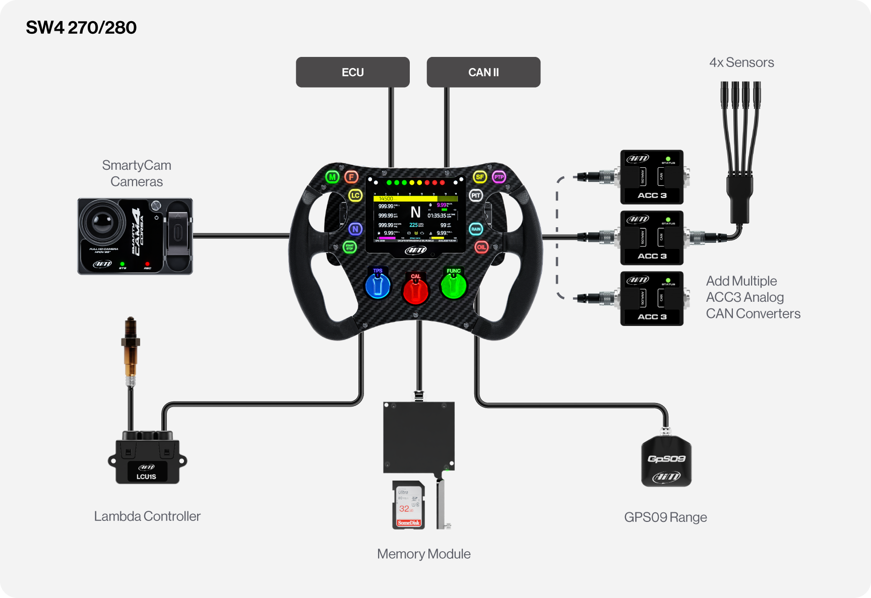

  • GPS Module: Connected via CAN, the GPS Module makes lap timing and track position analysis easy.
  • Other Expansions: Expand your system with a range of additional Aim devices, including the TC Hub, Lambda Controller, SmartyCam camera, RIO, GS-Dash, and more.

  • Expansion CAN Connection: GPS Module, LCU Series, ACC3, SmartyCam Series, RIO02, Shift Light Module, Memory Module

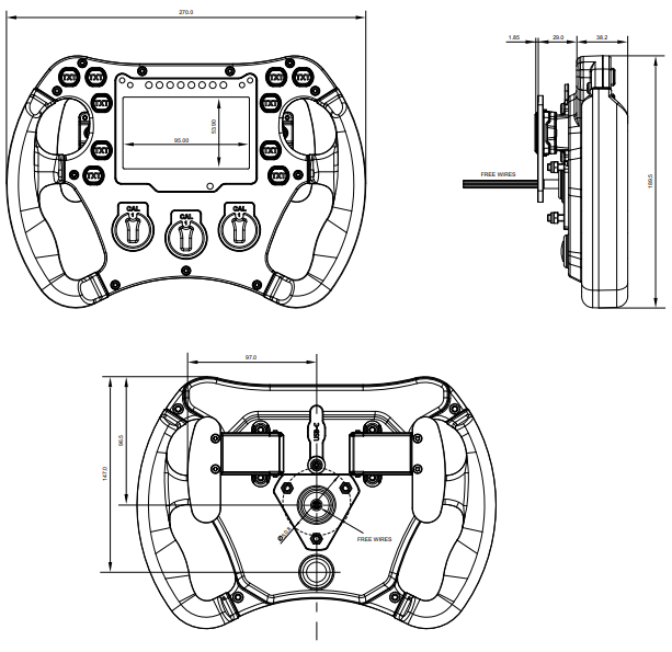

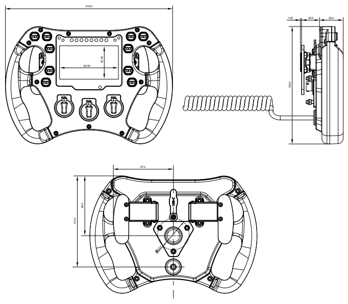

  • Dimensions: 270 x 189.5 x 38.2mm
  • Weight: 1,500g

SW4 270 (MY26) Formula Steering Wheel Diagram SW4 270 MY26 Formula Steering Wheel free wires diagram

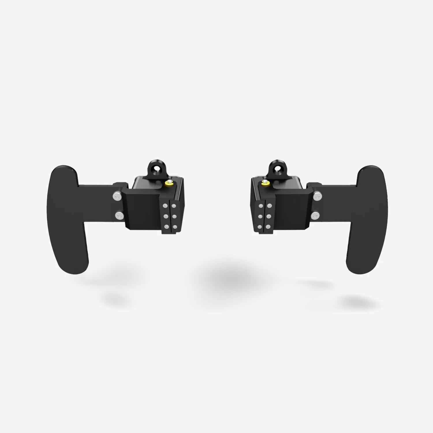

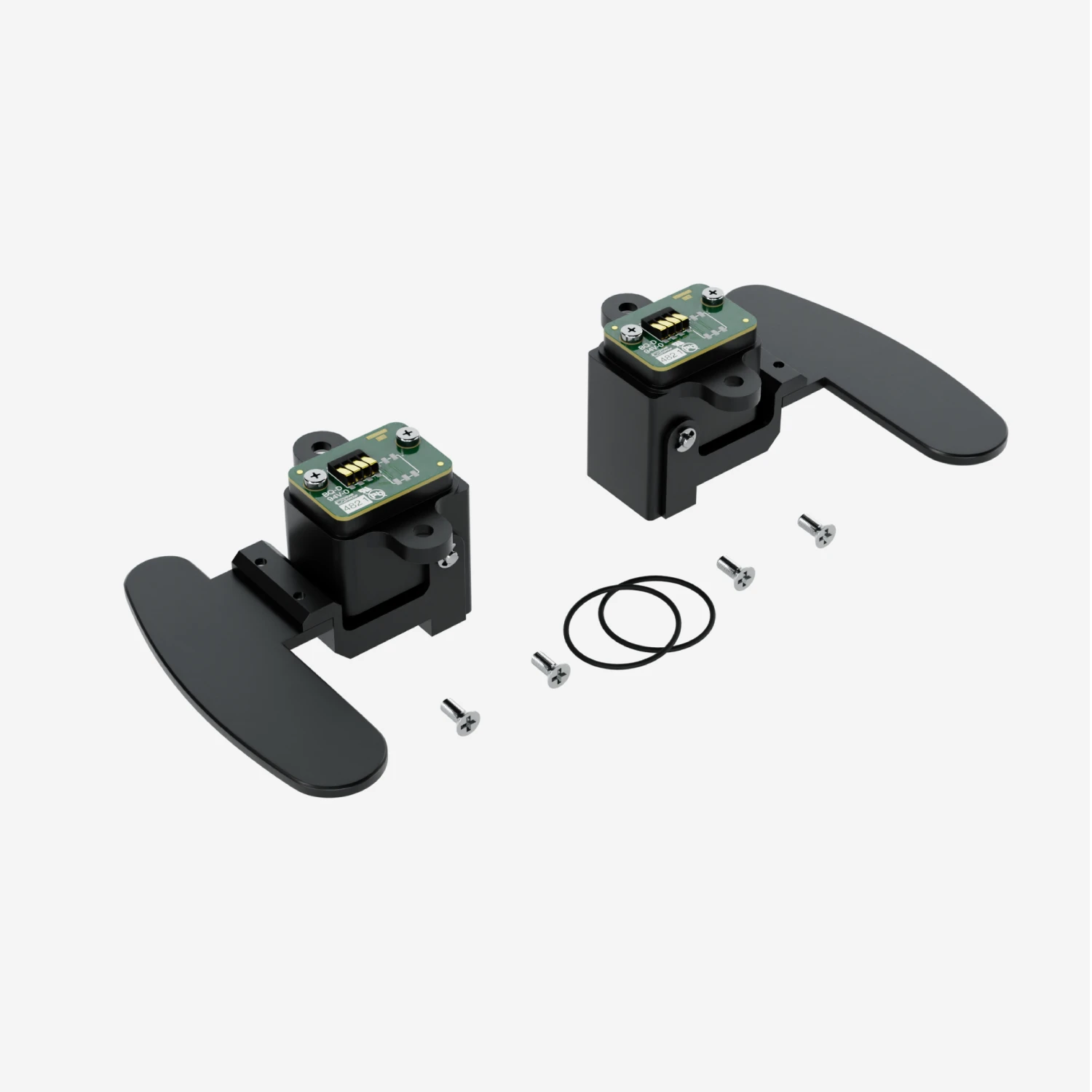

  • Steering wheel paddle shifters
    Paddle Shifters

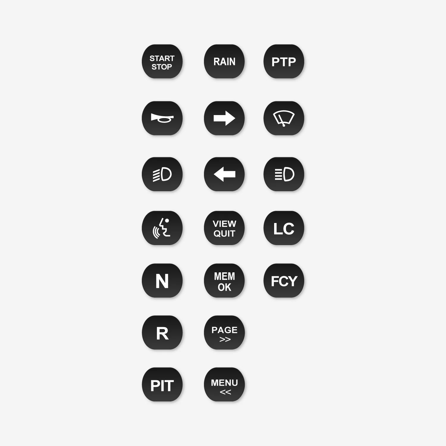

  • Aim Formula Steering Wheel 4 Push-Buttons - AimShop.com
    Standard Push-Button Kit
