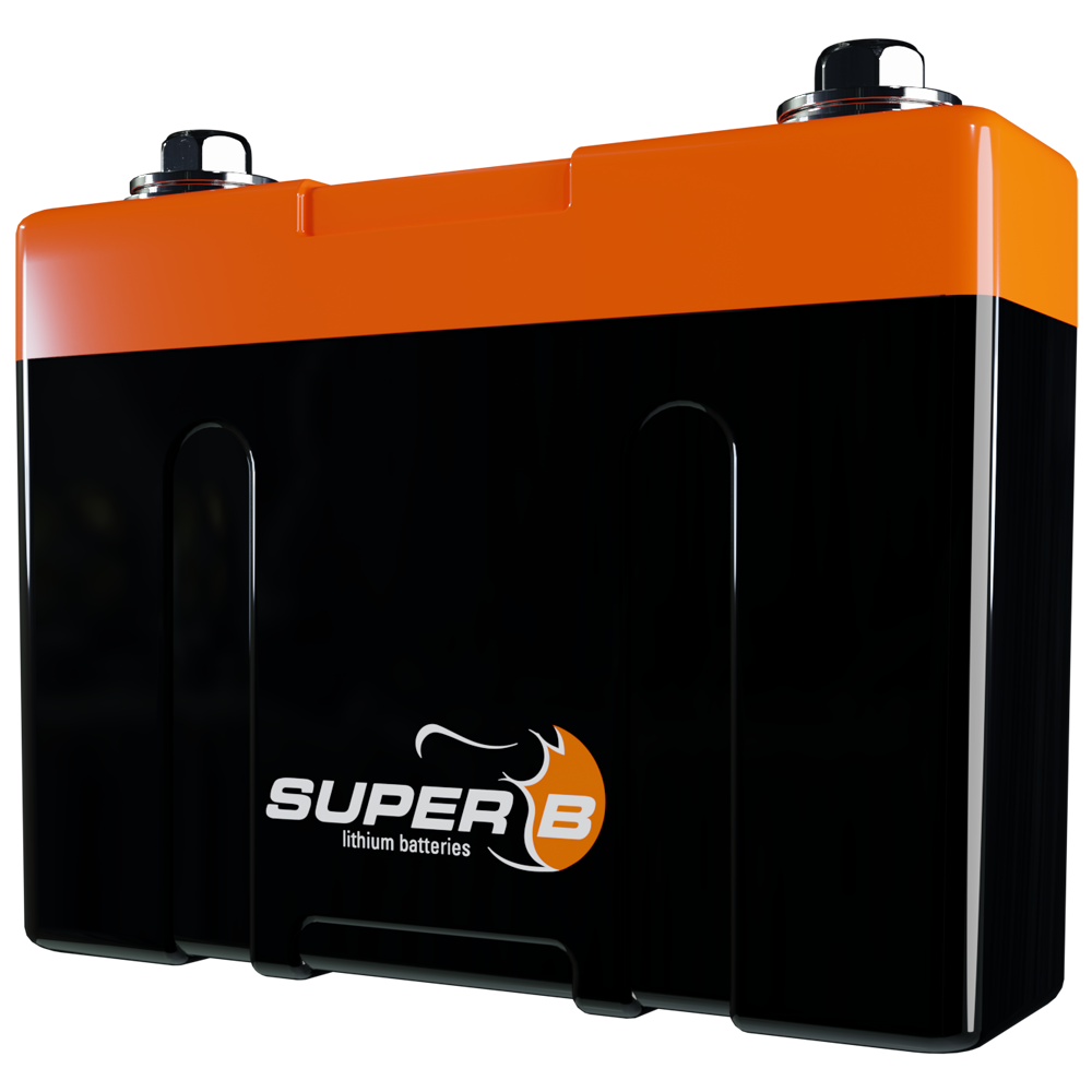

    Super B Andrena 12V2.5Ah Lithium Battery
    Light-weight, high-performance, safe, and reliable lithium power battery, specially developed for motorsports. This battery equals a lead-acid battery of 5 to 7Ah, provided the alternator’s maximum current doesn’t exceed the battery’s maximum charge current of 10A. Designed in a standard rally casing. Suitable for 12V systems and for use in extreme environments.
    Lightweight Power
    With a weight of only 0.46kg /1.0lbs, the Andrena 12V2.5Ah power battery saves up to 80% in weight in comparison to traditional lead-acid batteries and is only 1/3 of the size of a conventional battery. This improves not only the performance of your vehicle but also helps to increase the fuel economy.
    The power battery offers a high level of power, fast charging, and long, maintenance-free service life. It also has a stable and flat discharge which means you have over 80% of the battery's capacity available and you can leave your vehicle unattended for a much longer period compared to a lead-acid battery.
    Safe & Reliable
    Super B batteries are based on lithium iron phosphate technology (LiFePO4). This is the safest lithium technology available today. On top of that our bespoke casing and electronics further increase safety and durability. Due to its high ingress protection class (IP69), the battery is completely dust-tight and waterproof. Therefore the battery can be used in the most extreme environment as well.
    Performance
    Fast charging
    Lightweight
    Long and maintenance-free lifespan
    Compact size
    Low self-discharge
    High discharge rates
    Safest Lithium Iron Phosphate Technology (LFP)
    3 Year Warranty
    A 3-year warranty offers the best peace of mind. It is the benefit of years of continuous engineering improvement and proven experience with all of our batteries in the harshest environments.
    Specification
    ELECTRICAL SPECIFICATIONS
    Nominal Capacity 2.5Ah
    Energy 32Wh
    Nominal Voltage 12.8V
    Open Circuit Voltage 13.2V
    Self Discharge <3% per month
    Cycle life >1000 (at 10C charge/discharge, 100% DoD)
    EqPb (Equals lead-acid) 5 to 7Ah
    MECHANICAL SPECIFICATIONS
    Dimensions (LxWxH) 114 x 32 x 84mm | 4.49” x 1.26” x 3.30”
    Weight 0.46 kg / 1.0lbs
    Case Material PC - ABS
    Ingress Protection IP69
    Cell Type / Chemistry Cylindrical - LiFePO4
    Charge Method CCCV
    Charge Voltage 14.3V - 14.6V
    Max Charge Current 10A
    End of Discharge Voltage 8V
    Discharge Current Continuous 40A
    Discharge Pulse Current (1 sec) 136A (54C)
    TEMPERATURE SPECIFICATIONS
    Charge Temperature 0°C to 45°C1 | 32°F to 131°F1
    Discharge Temperature -20°C to 55°C | -4°F to 131°F
    Storage Temperature -20°C to 45°C | -4°F to 113°F
    COMPLIANCE SPECIFICATIONS
    Certifications CE, UN 38.3, UL 1642 (Cells)
    Shipping Classification UN 3480
    1 Do not charge below 0°C / 32°F
