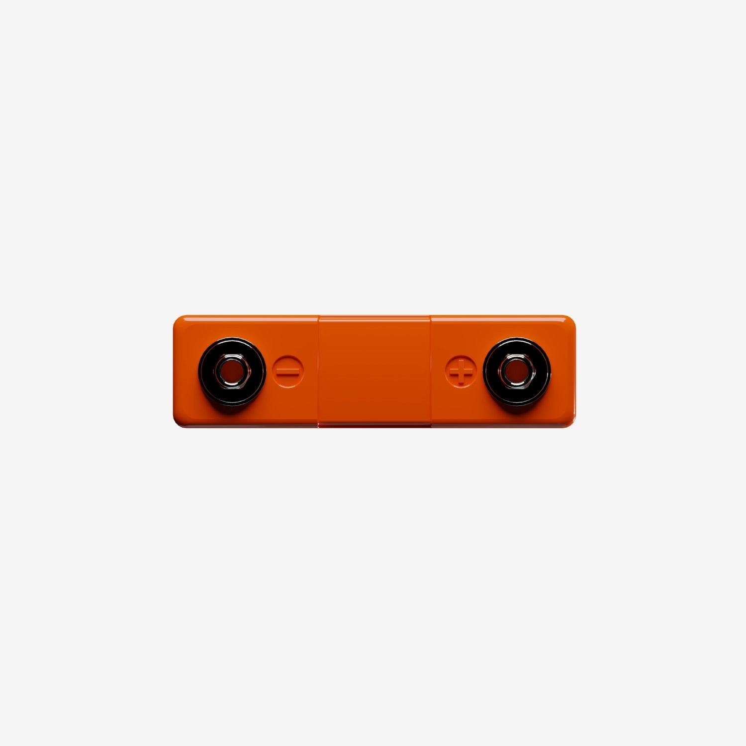

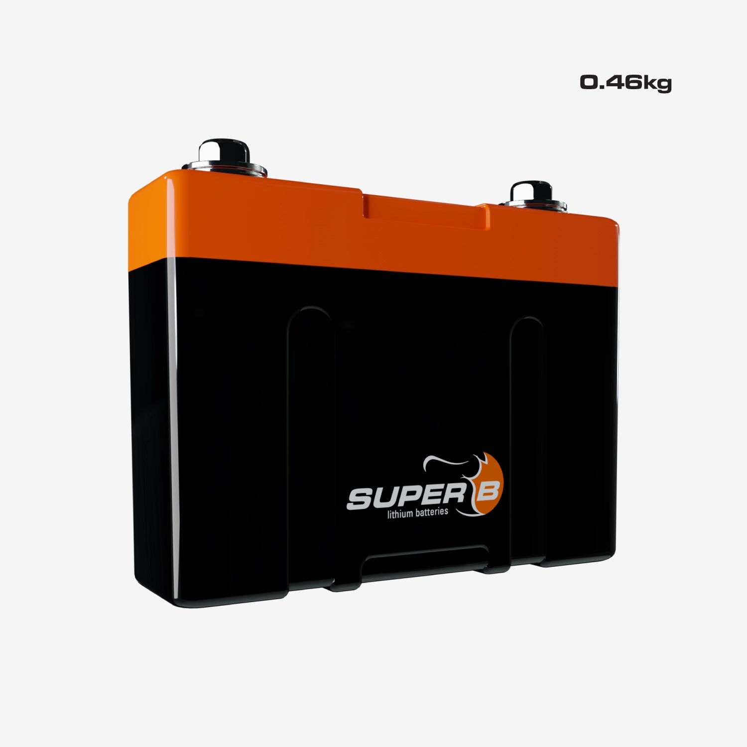

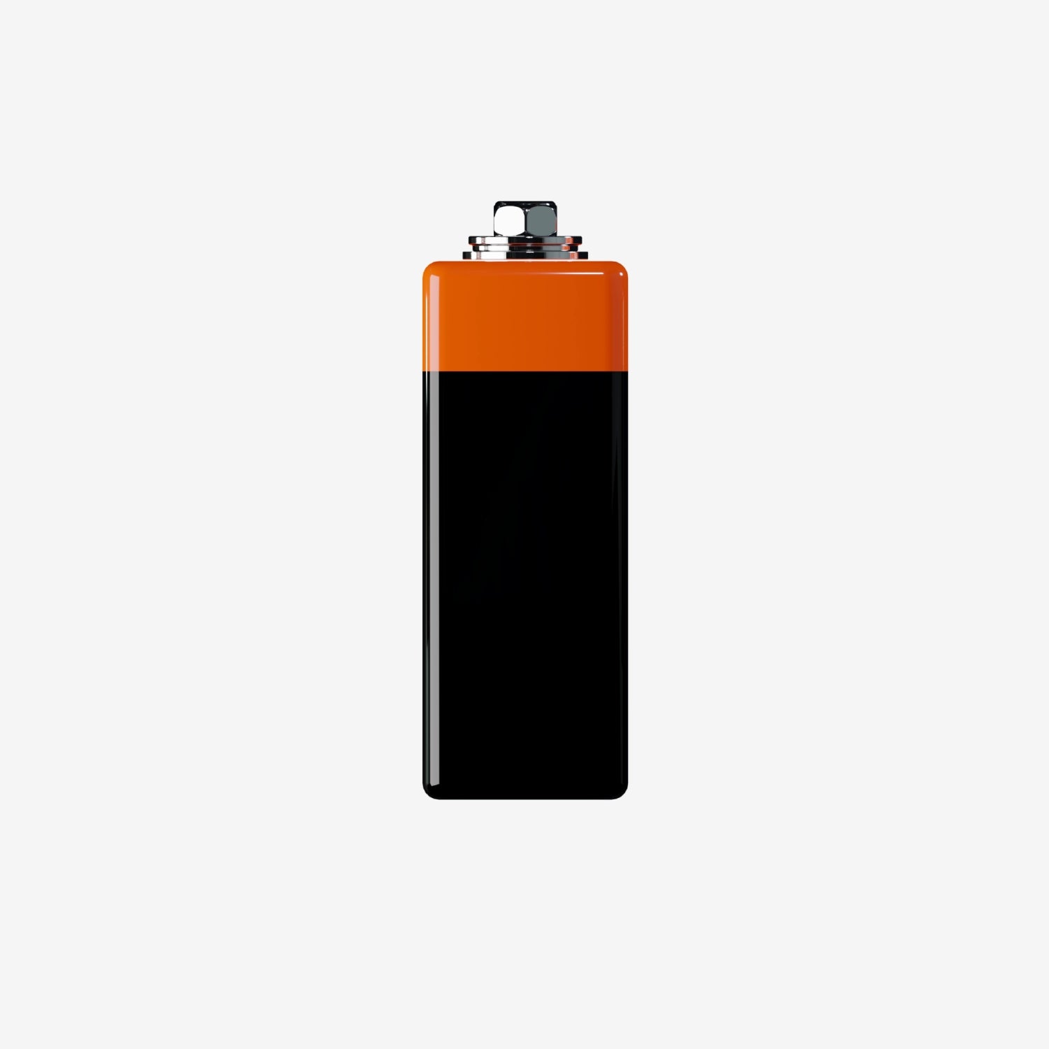

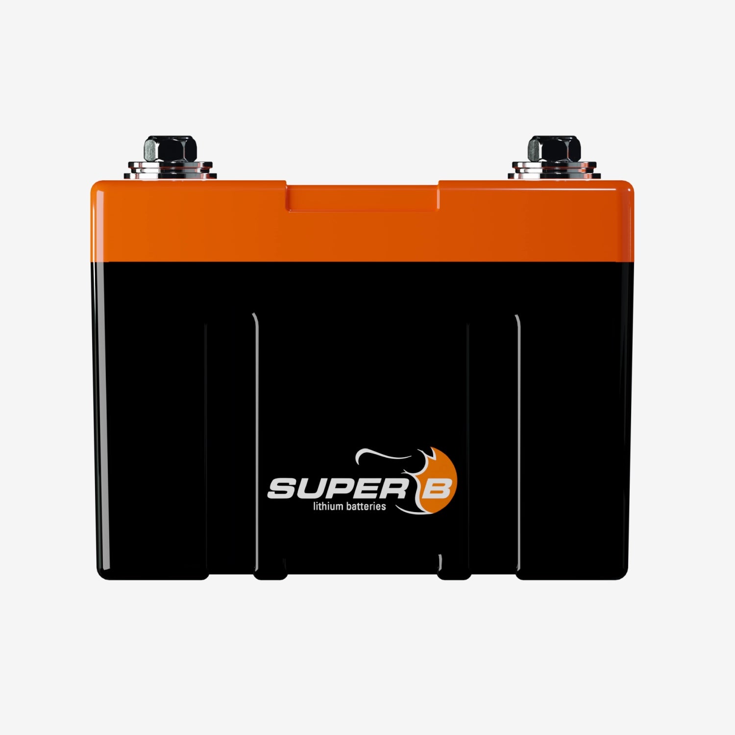

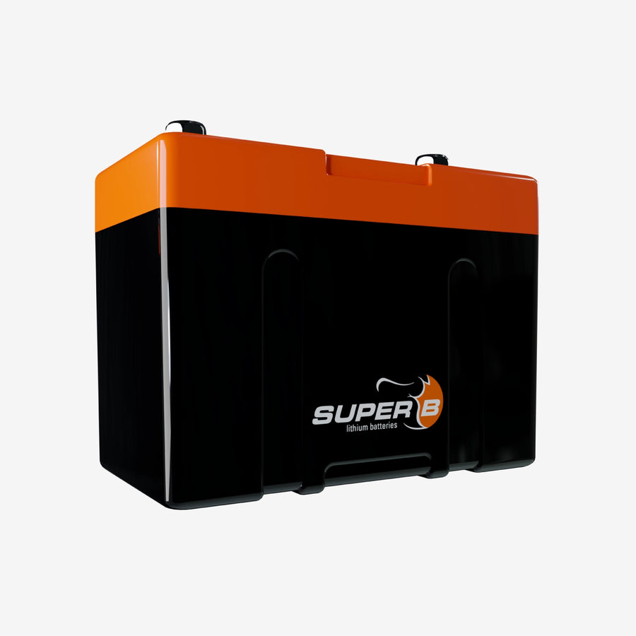

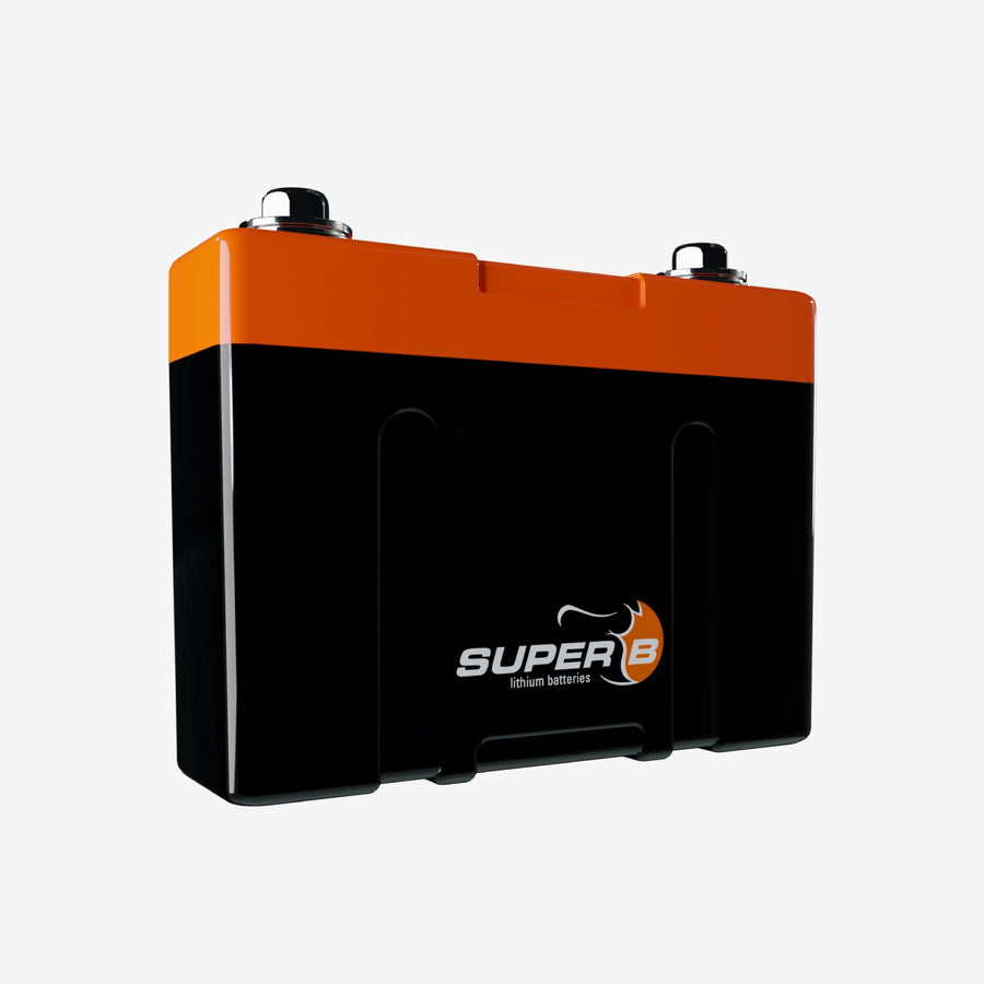

Super B Andrena 12V2.5Ah Lithium Battery
Light-weight, high-performance, safe, and reliable lithium power battery, specially developed for motorsports. This battery equals a lead-acid battery of 5 to 7Ah, provided the alternator’s maximum current doesn’t exceed the battery’s maximum charge current of 10A. Designed in a standard rally casing. Suitable for 12V systems and for use in extreme environments.
Lightweight Power
With a weight of only 0.46kg /1.0lbs, the Andrena 12V2.5Ah power battery saves up to 80% in weight in comparison to traditional lead-acid batteries and is only 1/3 of the size of a conventional battery. This improves not only the performance of your vehicle but also helps to increase the fuel economy.
The power battery offers a high level of power, fast charging, and long, maintenance-free service life. It also has a stable and flat discharge which means you have over 80% of the battery's capacity available and you can leave your vehicle unattended for a much longer period compared to a lead-acid battery.
Safe & Reliable
Super B batteries are based on lithium iron phosphate technology (LiFePO4). This is the safest lithium technology available today. On top of that our bespoke casing and electronics further increase safety and durability. Due to its high ingress protection class (IP69), the battery is completely dust-tight and waterproof. Therefore the battery can be used in the most extreme environment as well.
Performance
Fast charging
Lightweight
Long and maintenance-free lifespan
Compact size
Low self-discharge
High discharge rates
Safest Lithium Iron Phosphate Technology (LFP)
3 Year Warranty
A 3-year warranty offers the best peace of mind. It is the benefit of years of continuous engineering improvement and proven experience with all of our batteries in the harshest environments.
ELECTRICAL SPECIFICATIONS
Nominal Capacity 2.5Ah
Energy 32Wh
Nominal Voltage 12.8V
Open Circuit Voltage 13.2V
Self Discharge <3% per month
Cycle life >1000 (at 10C charge/discharge, 100% DoD)
EqPb (Equals lead-acid) 5 to 7Ah
MECHANICAL SPECIFICATIONS
Dimensions (LxWxH) 114 x 32 x 84mm | 4.49” x 1.26” x 3.30”
Weight 0.46 kg / 1.0lbs
Case Material PC - ABS
Ingress Protection IP69
Cell Type / Chemistry Cylindrical - LiFePO4
Charge Method CCCV
Charge Voltage 14.3V - 14.6V
Max Charge Current 10A
End of Discharge Voltage 8V
Discharge Current Continuous 40A
Discharge Pulse Current (1 sec) 136A (54C)
TEMPERATURE SPECIFICATIONS
Charge Temperature 0°C to 45°C1 | 32°F to 131°F1
Discharge Temperature -20°C to 55°C | -4°F to 131°F
Storage Temperature -20°C to 45°C | -4°F to 113°F
COMPLIANCE SPECIFICATIONS
Certifications CE, UN 38.3, UL 1642 (Cells)
Shipping Classification UN 3480
1 Do not charge below 0°C / 32°F
GENERAL PRODUCT SPECIFICATIONS
EAN-13 8718531360006
Battery Designation 4IFpR27/66
