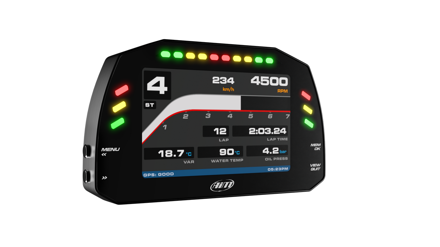

The MXsl has a 5″ compact colour display, configurable to show all the information coming from your ECU. It also has analogue/digital inputs, pre-defined math channels, and an optional GPS Module.
The main addition to the Aim MXsl dash display is the inbuilt power module; offering 10 high-power outputs that can be used to directly power components such as motors, lights, fans, pumps and other electrical devices without the need to use conventional relays and fuses.
MXsl Capabilities
The MXsl can detect short circuits, over-currents and open circuits while recording them for later diagnosis. The error information can also be displayed on the dash if required. Each power output can also be configured to be activated by a combination of math channels, analogue/digital inputs, push buttons or ECU fields.
You can automatically run external systems such as to switch on/off additional lights, to activate/de-activate a cooling fan or circulation pumps etcetera, when a certain event happens.

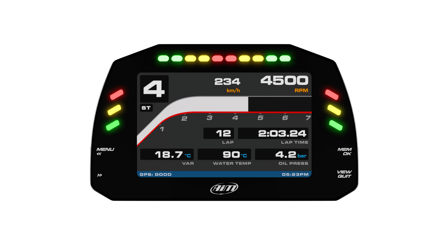

High Contrast TFT Display
The Aim MXsl has a high contrast TFT display which features an optimised backlighting system by using an ambient light sensor. This helps to maintain the optimum brightness for reading the display in all light levels.
As with other Aim dash displays, the data shown on the screen can be configured to show the precise information that the driver needs the most.
Multiple pages are also available to display further data and can be switched using the buttons on the dash or by wiring to a standalone button. Data which can be displayed include graphical dials for speed and RPM as well as vital engine parameters such as oil pressure/temperature, water temperature, battery voltage and more.
At the top of the unit, there is a row of fully configurable shift lights which can be set according to the user's specific requirements including individual RPM thresholds for each gear and the colour of the LEDs.

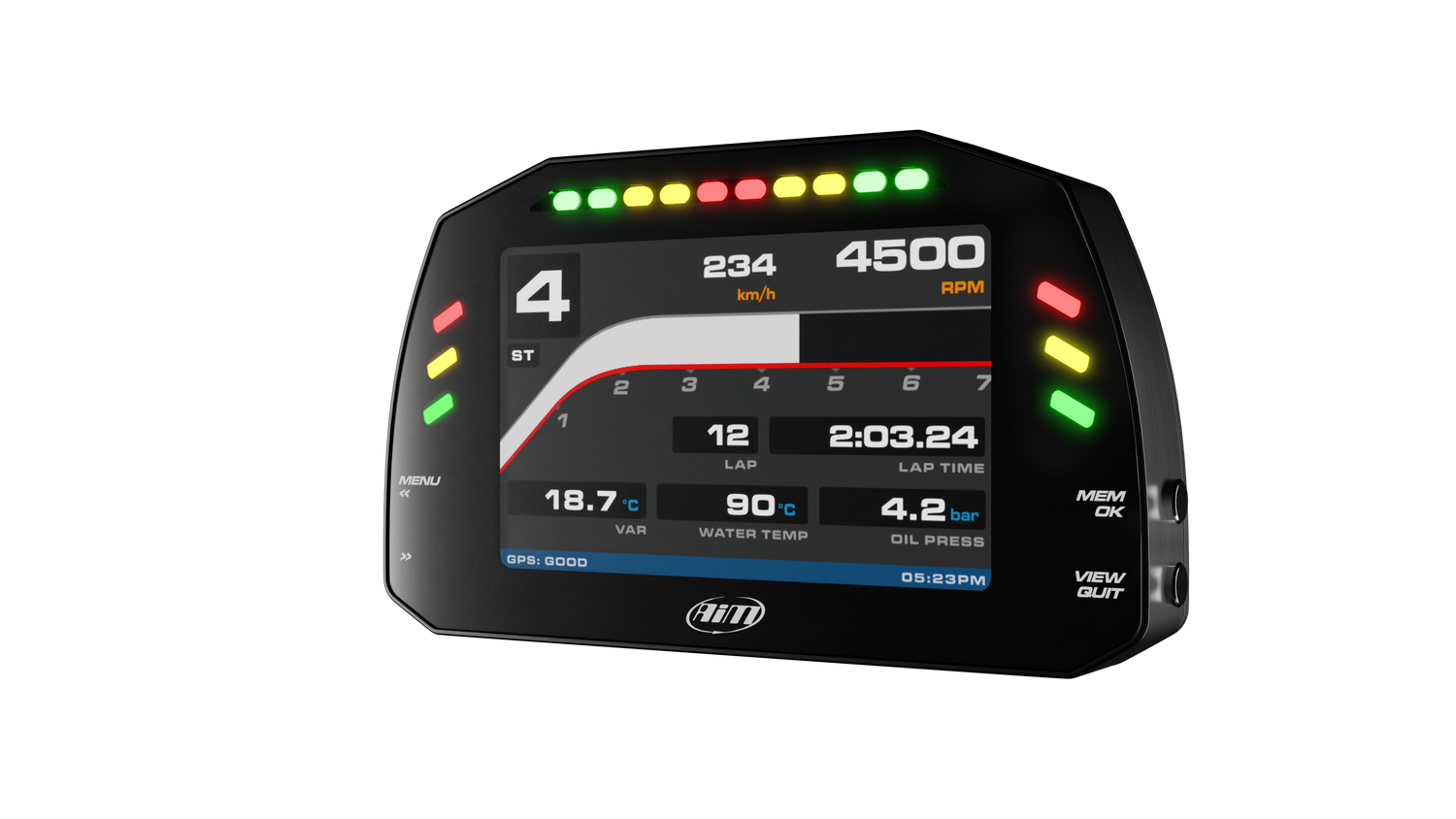

The Aim MXsl shows, together with the RPM scale, all the data you need: speed, water temperature, oil pressure, lap times, and more.
Choose from custom pages among a wide library of page styles, defining which data is shown, and swapping between the pages is easy using the push buttons.
טעינת וידאו: Pre-configured dash display screens for the MX Strada Series.
Pre-Configured Pages
The MXsl shows the RPM scale and all the data you need, like speed, water temperature and oil pressure, lap times and much more. You can customise pages to suit your requirements, including up to four additional fields. Define what data is shown with the end of scale and measure units. Swapping between the pages is easy; just use the push buttons.
