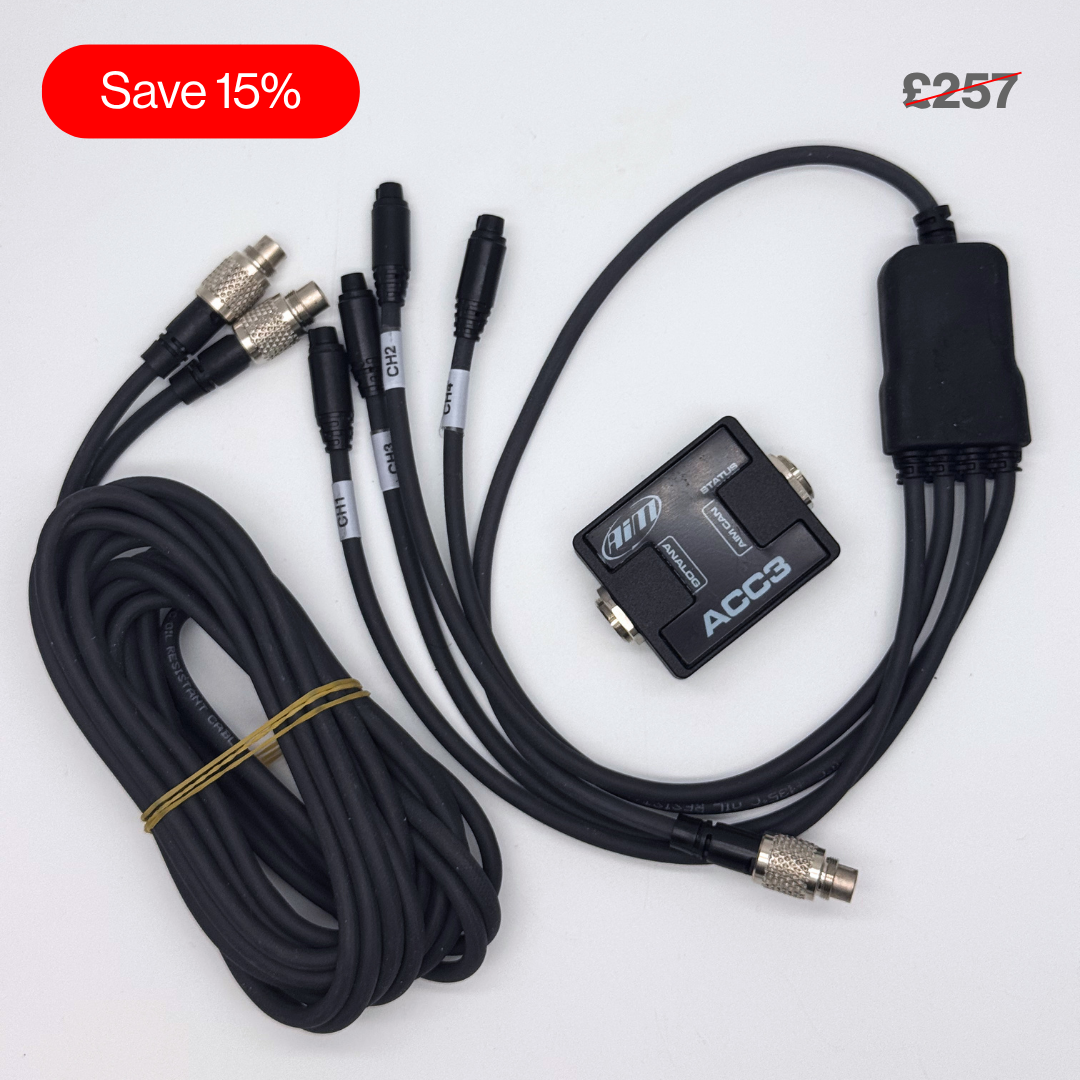

The Aim Analogue CAN Converter (ACC3) is a compact and powerful module designed to extend the data acquisition capabilities of your logger. Managing up to 4 channels at 200Hz each, the ACC3 allows you to capture and analyse additional sensor data with precision.
Why Choose the Aim ACC3
Fully compatible with the Aim Solo 2 DL, the analogue to CAN converter is an ideal solution for expanding your setup and unlocking more detailed performance insights.
Like all Aim devices, the Aim ACC3 is built for motorsport applications. Its compact design ensures easy installation across a range of racing vehicles, while its robust construction guarantees reliability in demanding environments. When combined with Race Studio 3 software, the ACC3 unlocks powerful configuration and analysis tools, including suspension analysis with Aim Eclipse sensors and video synchronisation with SmartyCam cameras.
Sensor Compatibility
- Thermocouples (K-type, using dedicated compensated cables)
- Thermo Resistors
- 0–5V Sensors
- 0–12V Sensors
In addition, both the ACC3 and ACC3 Open feature 2 speed inputs (internal pull-up for open drain/collector input), enabling even greater flexibility for data acquisition.
Channel Configuration
Once the appropriate harness has been selected, the analogue to CAN converter allows you to configure channels according to the connected sensors. Up to 4 type K thermocouples can be managed simultaneously, giving you precise temperature monitoring across multiple areas of your engine or vehicle.
Suspension Analysis
The ACC3 is also designed to work with Aim Eclipse sensors. When paired with Aim linear potentiometers, data can be processed through the advanced suspension analysis tool in Race Studio 3 - providing a complete picture of chassis dynamics for deeper performance evaluation.

The Aim ACC3 is a compact and reliable module that is used to convert analogue sensor inputs into a CAN bus signal, allowing up to 4 analogue channels.
What are the differences between the Aim ACC3 and the ACC3 Open?
Although the Aim ACC3 and the ACC3 Open are both analogue to CAN converters, their differences lie in their compatibility. The ACC3 Open offers broader compatibility with non-Aim systems, allows custom CAN protocol configuration via USB, and serves as a flexible, open-system logger interface, whereas the standard ACC3 is primarily designed as a direct plug and play expansion for Aim ecosystems.
- Data/Dash Loggers: Solo 2 DL, MyChron Series, EVO4S/EVO5, and MX Series dashes.
- Sensors: K-type thermocouples, thermo resistors, 0-5V sensors and 0-12V sensors.
- Expansion Modules: SmartyCam cameras, LCU-One Lambda controllers and CAN expansion modules.
