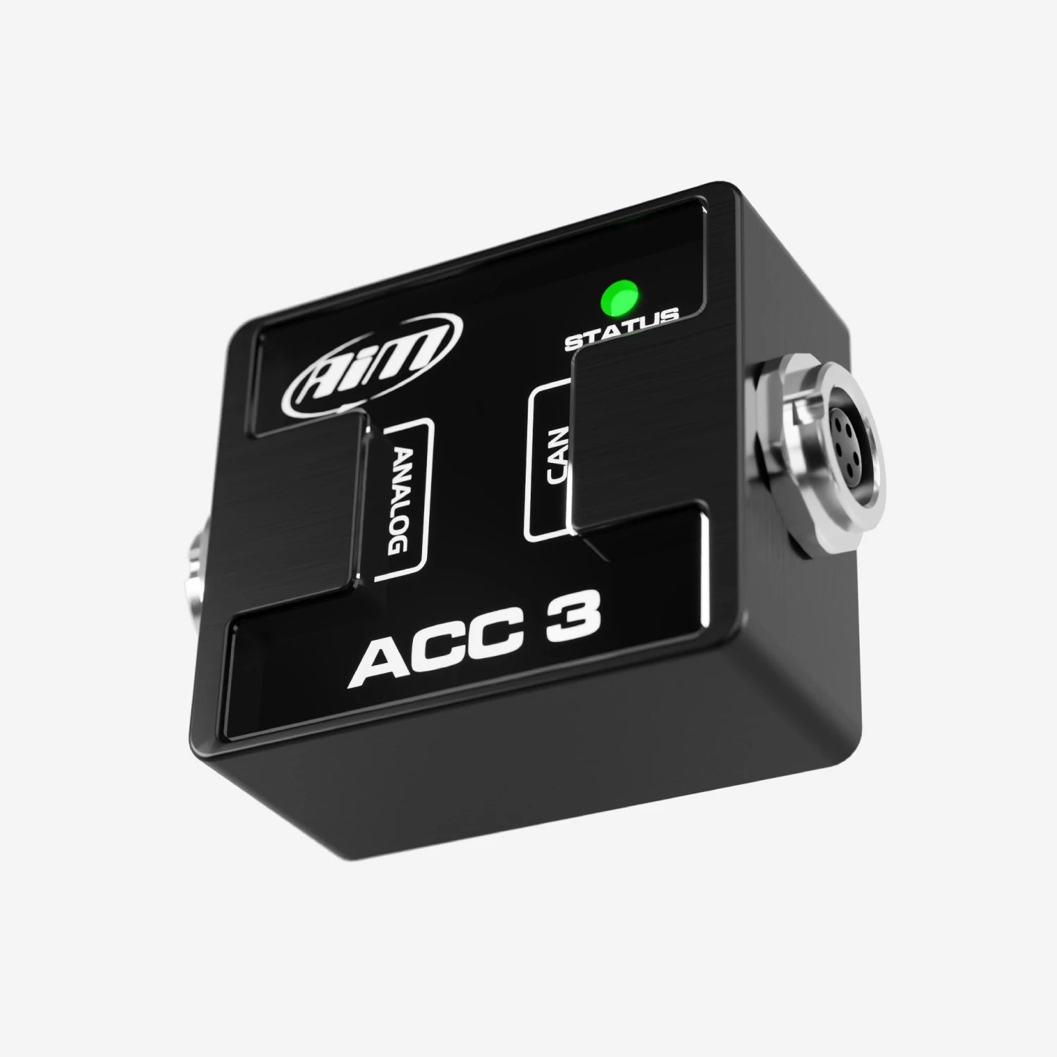

The Aim Analogue CAN Converter (ACC3) is a compact and powerful module designed to extend the data acquisition capabilities of your logger. Managing up to 4 channels at 200Hz each, the ACC3 allows you to capture and analyse additional sensor data with precision.
Why Choose the Aim ACC3
Fully compatible with the Aim Solo 2 DL, the analogue to CAN converter is an ideal solution for expanding your setup and unlocking more detailed performance insights.
Like all Aim devices, the Aim ACC3 is built for motorsport applications. Its compact design ensures easy installation across a range of racing vehicles, while its robust construction guarantees reliability in demanding environments. When combined with Race Studio 3 software, the ACC3 unlocks powerful configuration and analysis tools, including suspension analysis with Aim Eclipse sensors and video synchronisation with SmartyCam cameras.

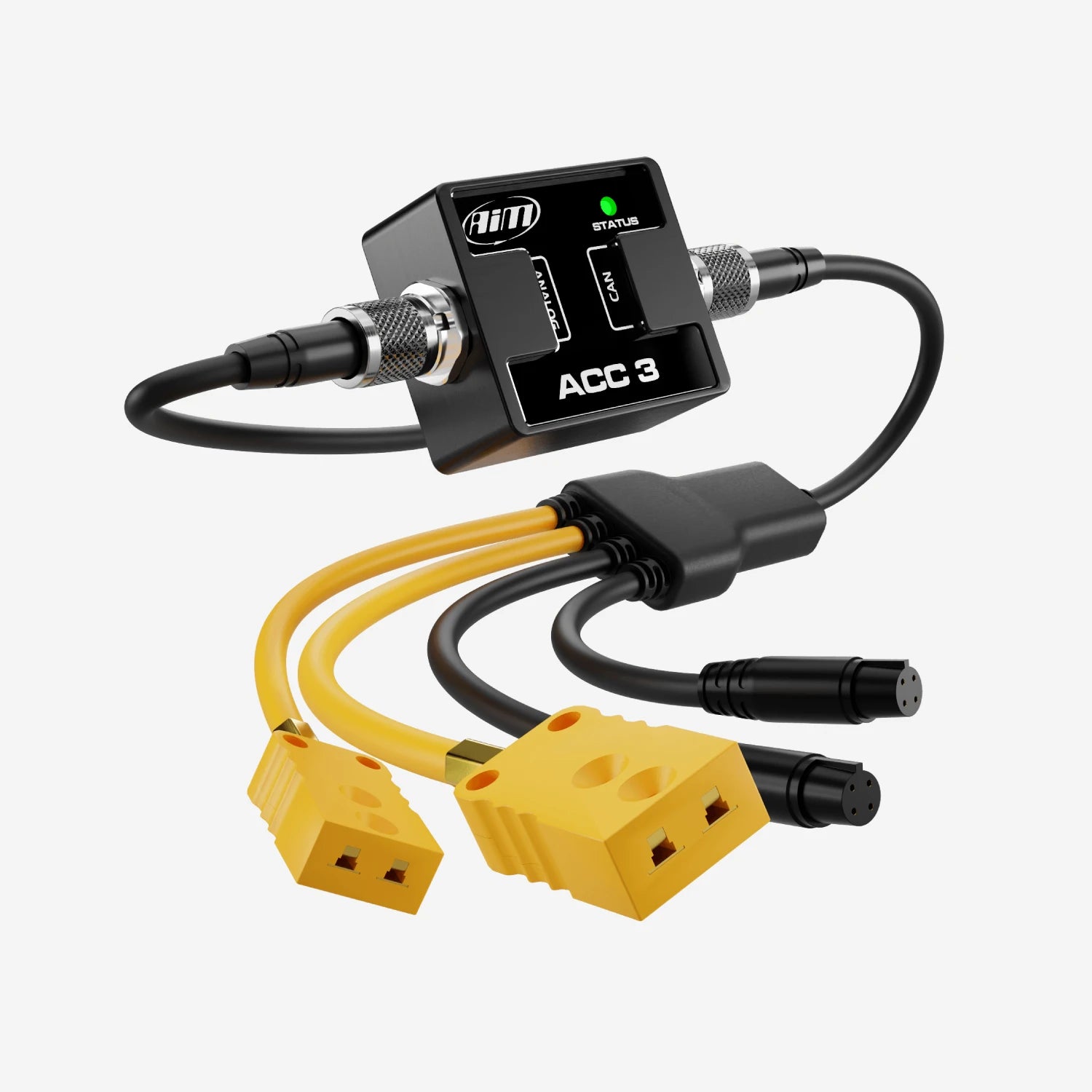

Channel Configuration

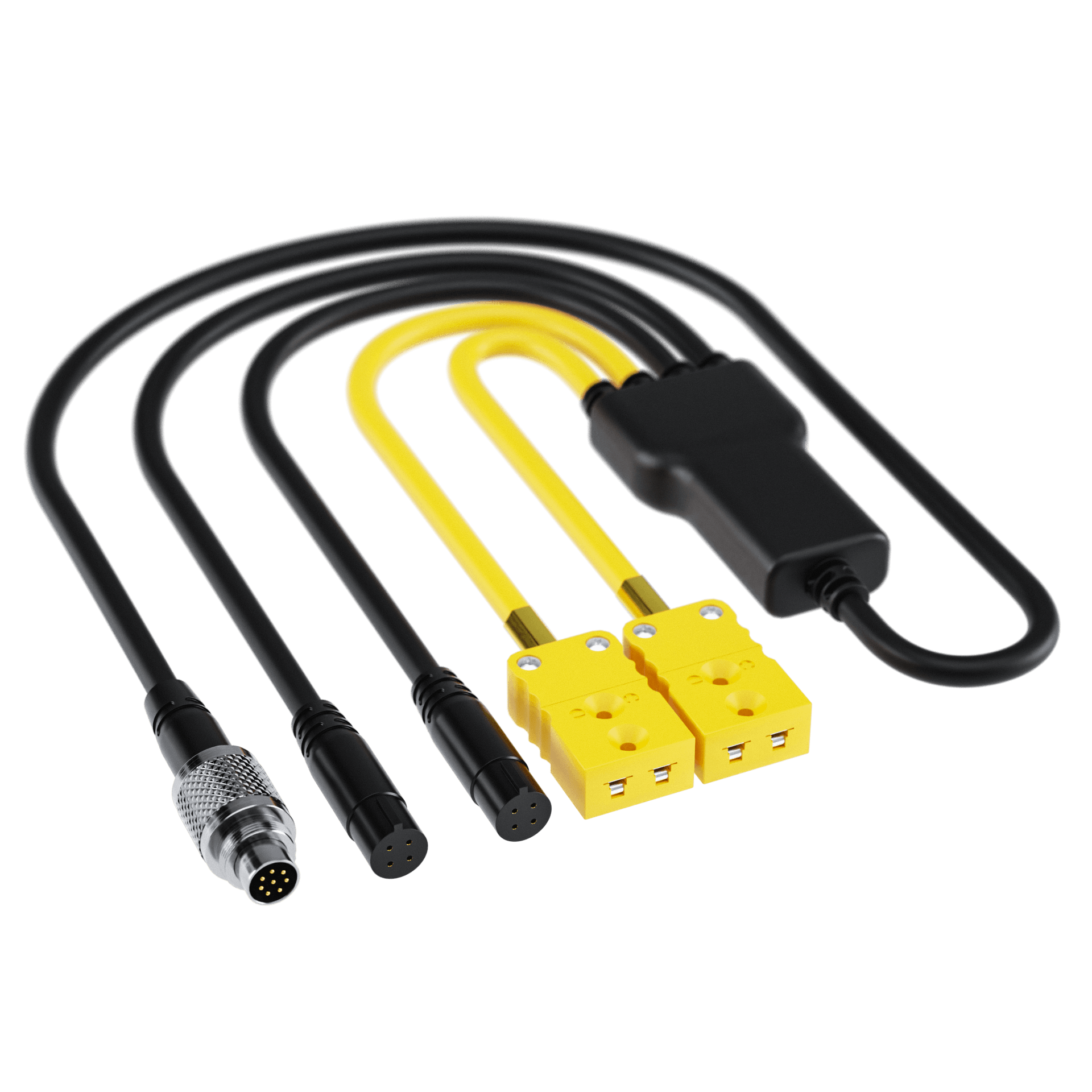

Once the appropriate harness has been selected, the analogue to CAN converter allows you to configure channels according to the connected sensors. Up to 4 type K thermocouples can be managed simultaneously, giving you precise temperature monitoring across multiple areas of your engine or vehicle.
Suspension Analysis

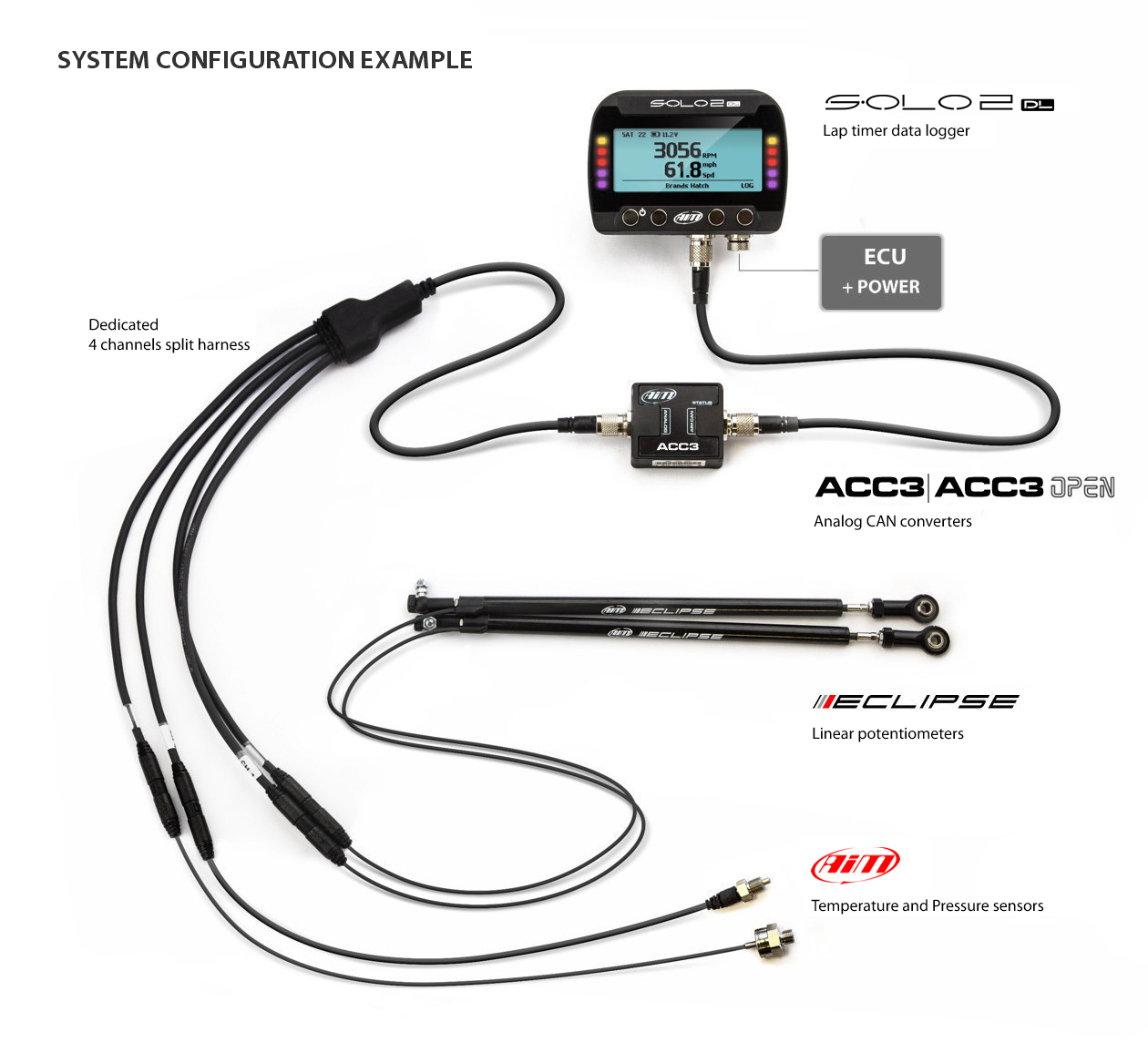

The ACC3 is also designed to work with Aim Eclipse sensors. When paired with Aim linear potentiometers, data can be processed through the advanced suspension analysis tool in Race Studio 3 - providing a complete picture of chassis dynamics for deeper performance evaluation.

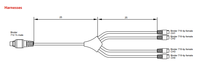

Harness Options
ACC3 harness diagram

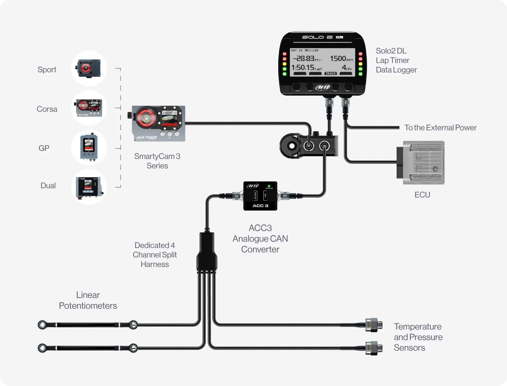

ACC connection example with Solo 2 DL and sensors

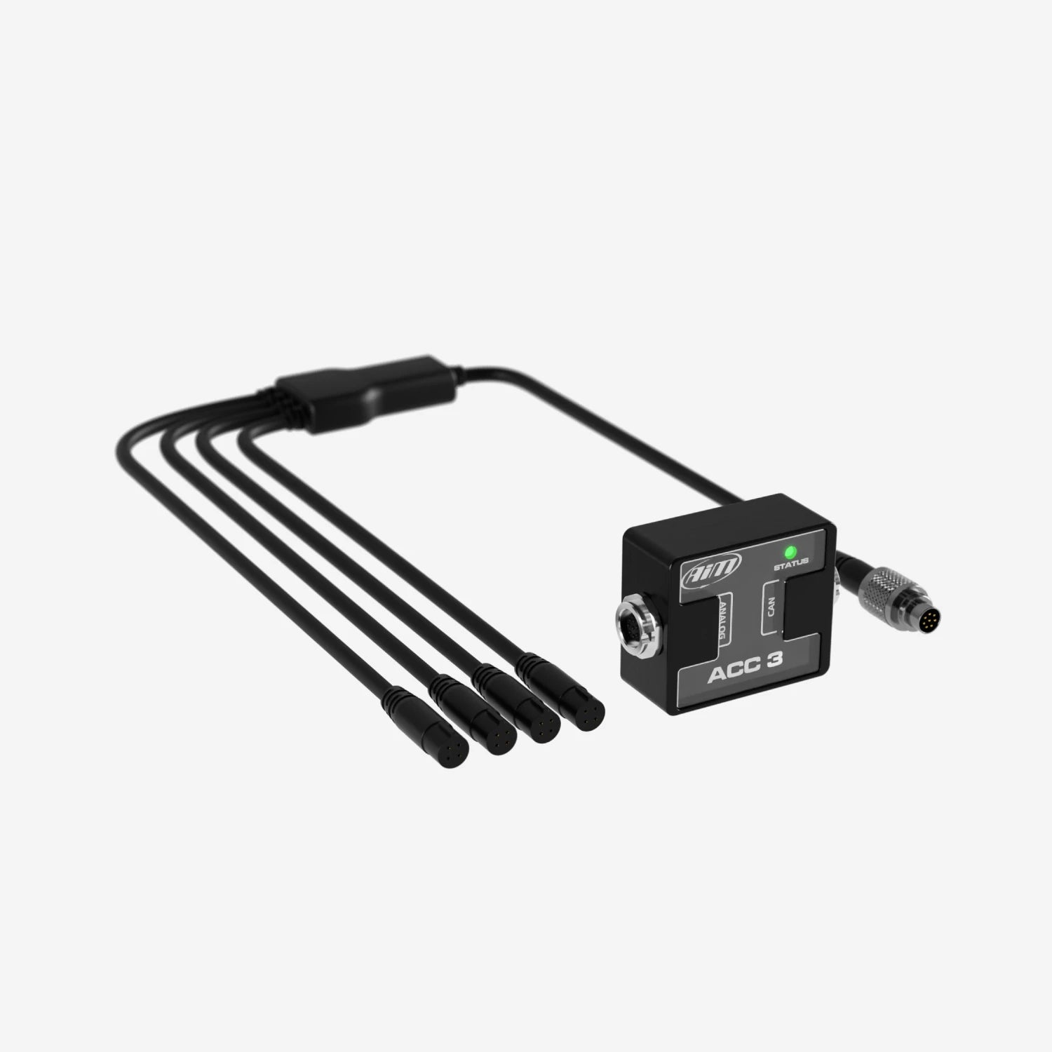

The Aim ACC3 is a compact and reliable module that is used to convert analogue sensor inputs into a CAN bus signal, allowing up to 4 analogue channels.
