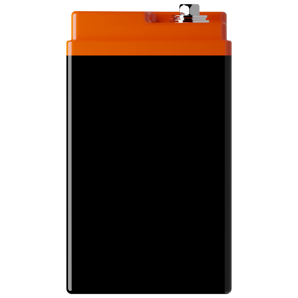

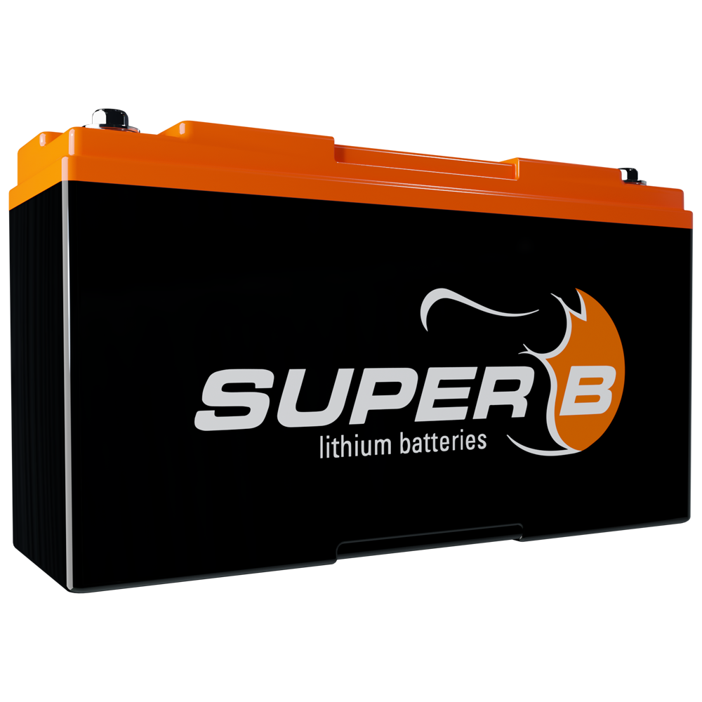

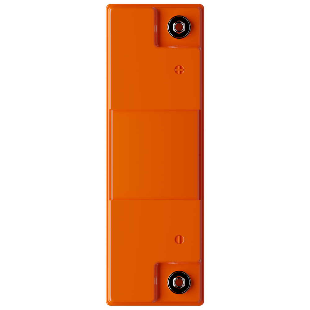

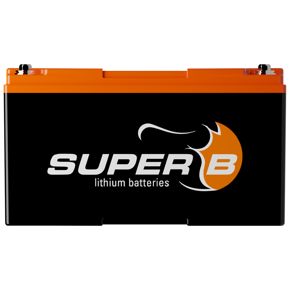

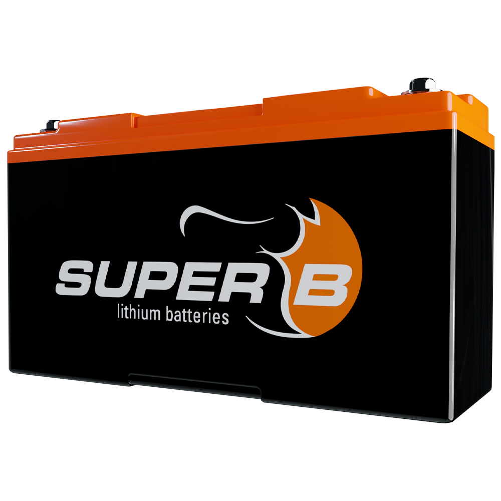

Super B Andrena 12V25Ah Lithium Battery equals a lead-acid battery of 100 to 130Ah, provided the alternator’s maximum current doesn’t exceed the battery’s maximum charge current of 77A. It is a 12V lithium iron phosphate battery, delivering 25Ah (320Wh) of capacity for reliability, high performance and results. Designed in a standard rally casing, the Super B Andrena 12V25Ah Lithium Battery is specifically made for setups that have larger engines or ones that run more electronics, including those of motorcycles, off-road vehicles and cars.
Why Choose the Super B Andrena 12V25Ah Battery
As the Andrena Battery is very lightweight and compact, it can fit with ease in any vehicle and eliminates the need to constantly check on it due to its low maintenance features. The fast-charging aspect of the battery, combined with the minimal self-discharge rate, means that the battery life is long-lasting and quick to refill, ensuring that usage of the Super B Andrena 12V25Ah Lithium Battery is maximised. With lithium iron phosphate (LiFePO4) technology, combined with its waterproofness, it is the safest and most reliable battery on the market.
Lightweight Power
The Super B Andrena 12V25Ah Lithium Battery is compact in size, measuring in at 249 x 96 x 141mm and weighing 4.3kg, so it is perfect for vehicles that need a smaller power source with high energy capacity.
At only 1/3 of the size of traditional lead-acid batteries, the Super B Andrena 12V25Ah Lithium Battery not only simplifies maintenance and installation in tight engine bays, but it also improves fuel economy and performance, delivering sharper handling, quicker acceleration and less strain on suspension components.
High-Performance
The Super B Andrena 12V25Ah Lithium Battery delivers exceptional power with a stable and flat discharge curve, meaning over 80% of its capacity is usable. It supports high continuous and pulse discharge currents, making it ideal for demanding motorsport applications.

Electrical Specifications
  • Nominal Capacity: 25Ah
  • Energy: 320Wh
  • Nominal Voltage: 12.8V
  • Open Circuit Voltage: 13.2V
  • EqPb (Equals lead-acid): 100 - 130Ah
Mechanical Specifications
  • Dimensions (LxWxH): 249 x 96 x 141mm / 9.8” x 3.78” x 5.55”
  • Weight: 4.3kg / 9.5lbs
  • Case Material: PC - ABS
  • Ingress Protection: IP69
  • EAN-13: 8718531360082
  • Battery Designation: 4IFpR27/66-10
  • Charge Method: CCCV
  • Max Charge Current: 77A
  • Discharge Current Continuous: 385A
  • Discharge Pulse Current (1 sec): 1045A (42C)
