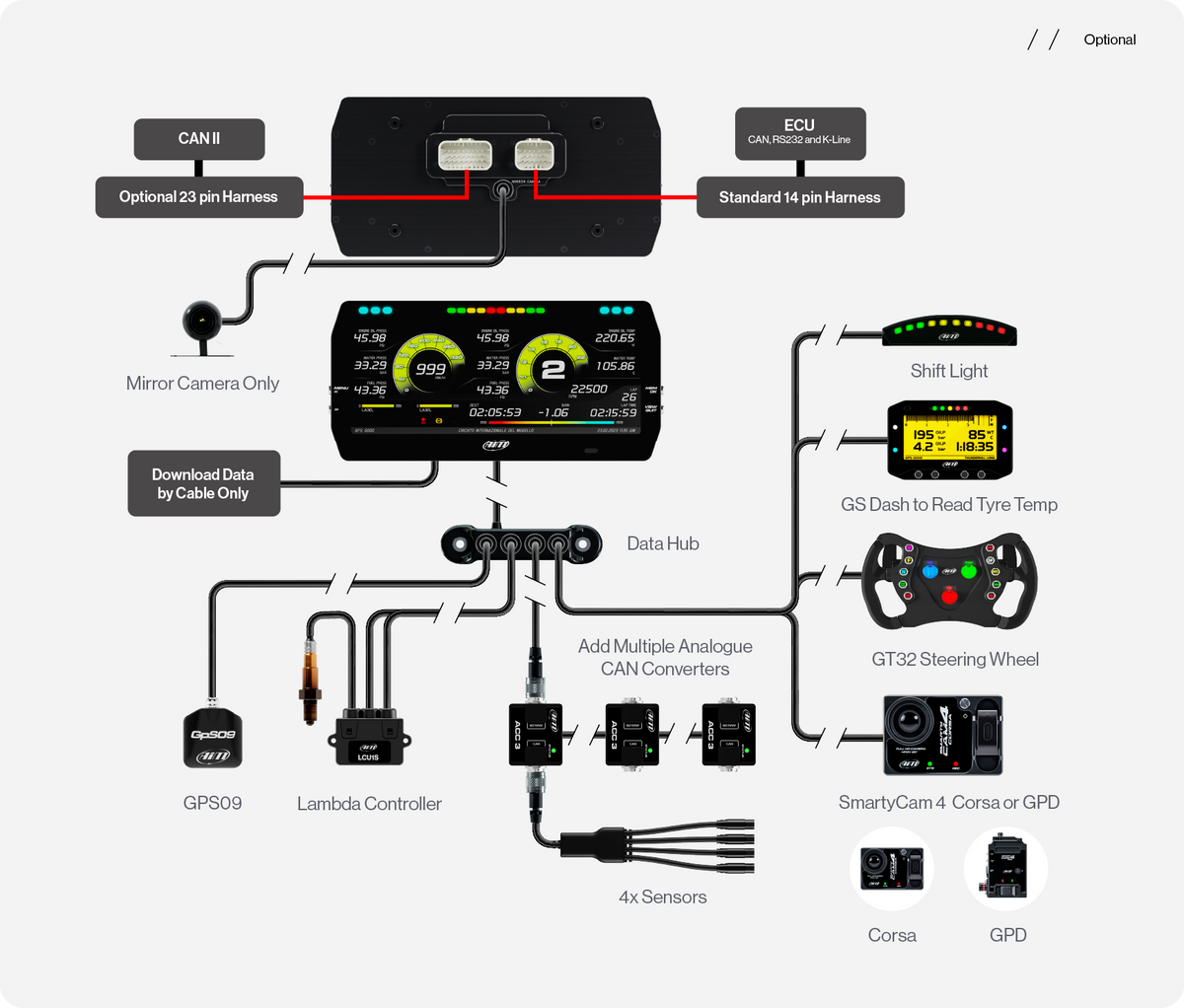

The MXT 1.3 Strada is available with a choice of connections. Choose either the OBDII or K-Line CAN, depending on whether you want to connect to the car's ECU or OBDII port or directly to the ECU through the CAN channel.

Selected gear information can be sourced by gear potentiometer, ECU stream message or it can be calculated in real time by the MXT Strada through speed and RPM. Each mode requires a specific gear configuration.

To connect and configure your SmartyCam with MXT Strada, you need to connect the devices, set up the configuration in Race Studio 3, and then transmit the configuration to the device. First, ensure your SmartyCam has power and a formatted SD card. Next, launch Race Studio 3 on your PC, which will detect the devices. Then, go to the "Configurations" page to create a new configuration or edit an existing one and add the "SmartyCam Stream" layer. In this layer, you will associate the necessary functions with the channels and transmit the configuration to the device.

Use a dedicated OBDII wiring harness and configure the MXT Strada with Race Studio 3. The process involves a physical connection followed by software setup to identify your car's specific ECU protocol. More information can be found here.
