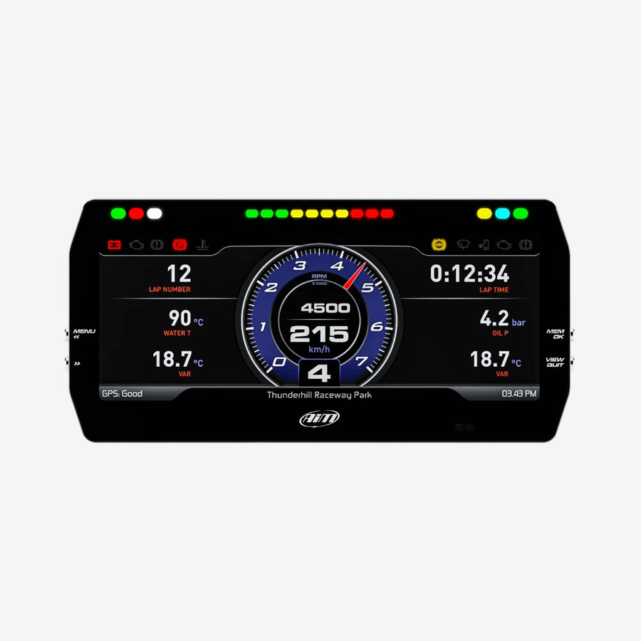

Display with Race Icons

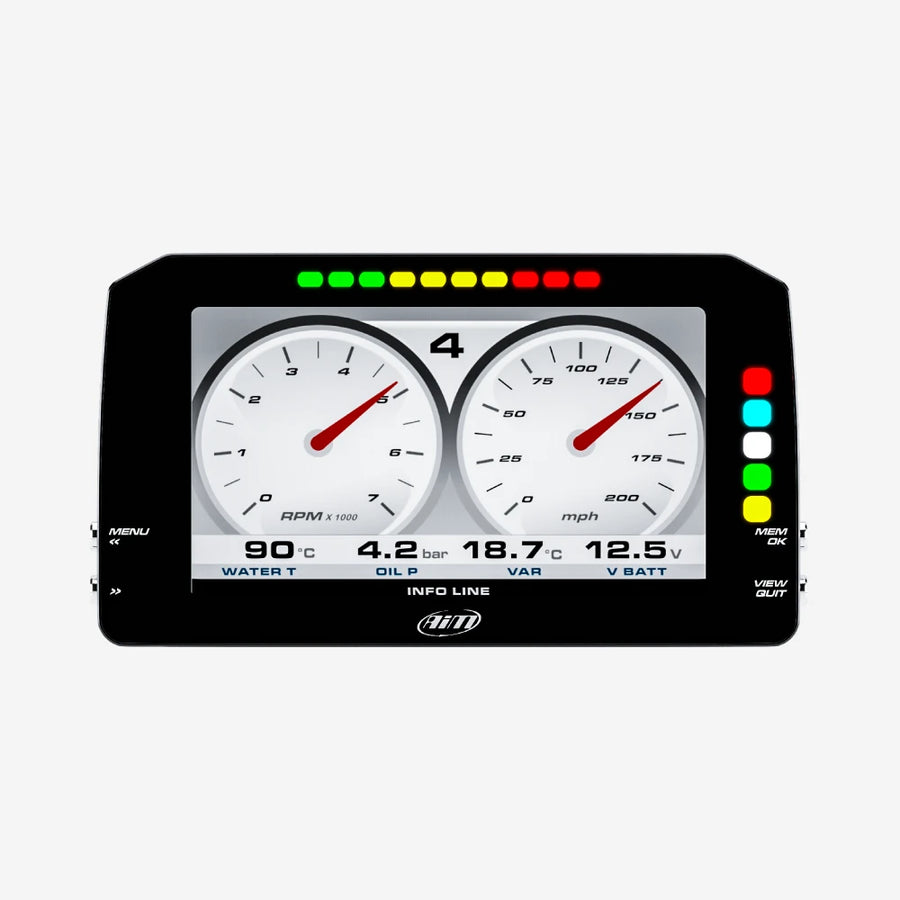

The MXG 1.3 Strada has a 7" TFT high contrast colour display. The visual quality is optimised by the ambient light sensor, which keeps the backlight at the best brightness levels. Race icons allow you to apply conditions to the LED icons.
Pre-Configured Pages
The MXG 1.3 Strada shows the RPM scale and all the data you need, like speed, water temperature and oil pressure, lap times and much more. You can customise pages to suit your requirements, including up to four additional fields. Define what data is shown with the end of scale and measure units. Swapping between the pages is easy; just use the push buttons.

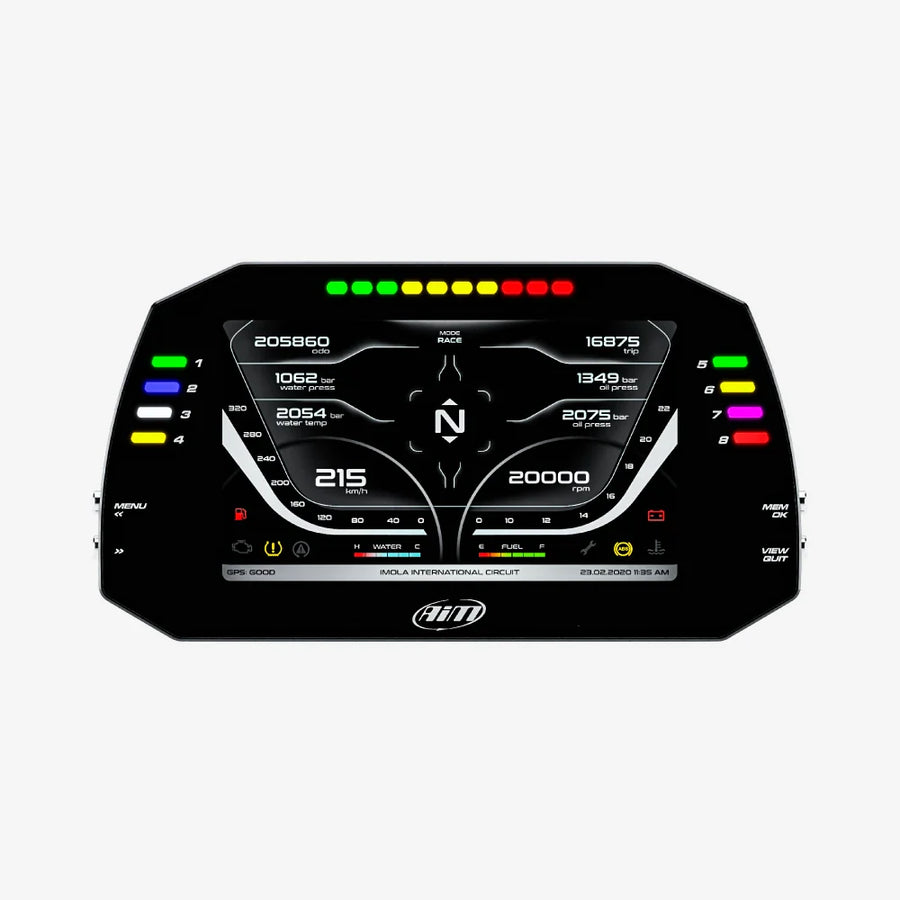

The MXG Strada comes with 8 customisable RGB LEDs, which are determined by inputs from the car's ECU or other sensors. The MXG Strada with race icons can be configured with alarms for gear position, lap time improvement, throttle position, low fuel, low oil pressure, low oil level and other customised alarms that have been set.
