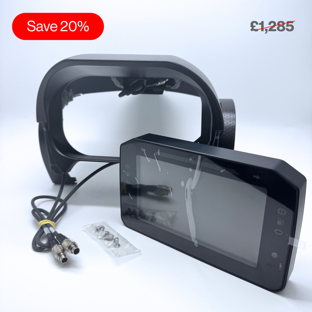

    This MX2E comes back to us as a trade-in, fully equipped and ready to take on its second life. The dash is in full working order and has been meticulously checked by our technicians.

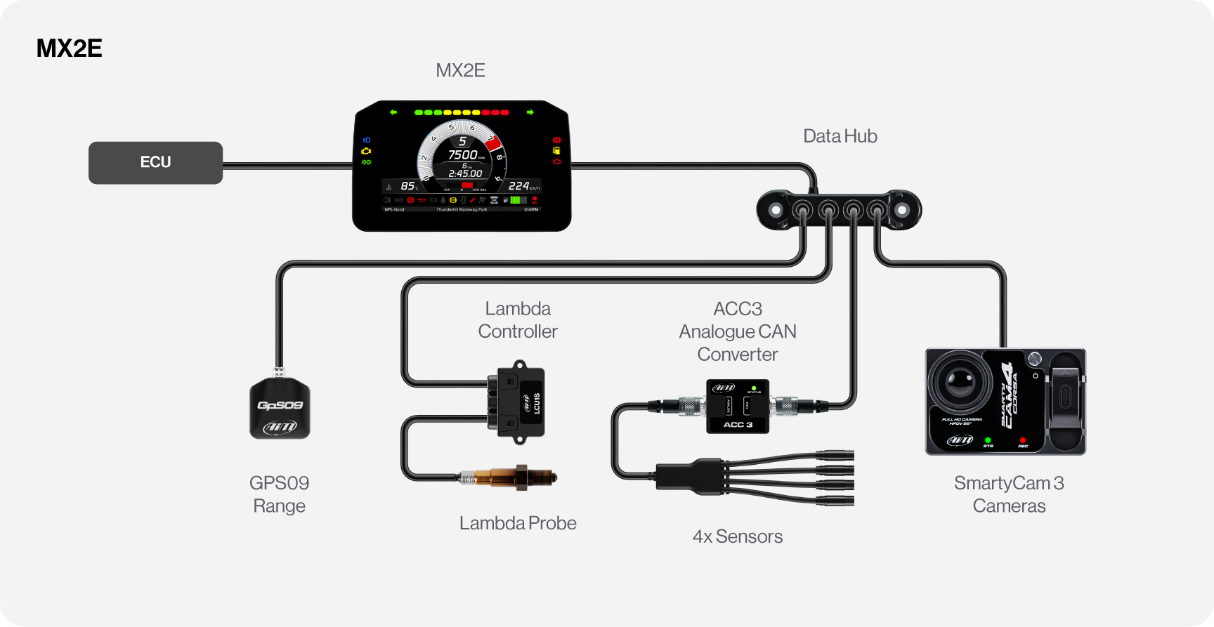

    The MX2E plug & play dash logger is compatible with various expansions and modules to enhance performance and expand on data collection. Compatible expansions include:
    • Lambda Controller: Monitor your air-fuel ratio for optimal engine performance.
    • Channel Expansion: Add more sensors to capture additional data points.
    • SmartyCam HD Cameras: Integrate video with data overlay for comprehensive analysis. Analogue camera input also allows you to swap your display into a mirror camera through push button command or event management.

    • MX2E Dash Logger
    • Cluster
    • GPS Module
    • Screws & Washers
    • Adapter Harness (optional if required)
