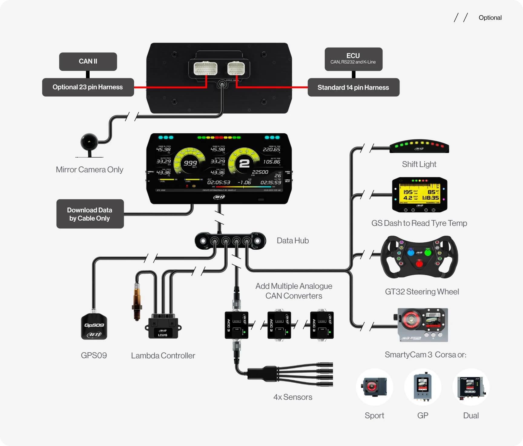

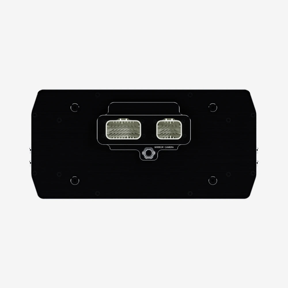

The MXT 1.3 Strada is available with a choice of connections. Choose either the OBDII or K-Line CAN, depending on whether you want to connect to the car's ECU or OBDII port or directly to the ECU through the CAN channel.
Digital Outputs
The MXT 1.3 Strada features 2x 1A-max digital outputs configurable to be activated/deactivated depending on the value of the analogue/digital inputs or on the impulses coming from the car's ECU. This allows you to automatically run external systems, such as switching on/off additional lights, to activate/deactivate a cooling fan or circulation pumps when a certain event happens.

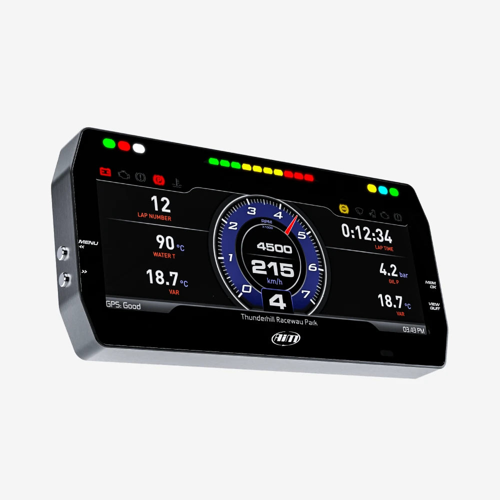

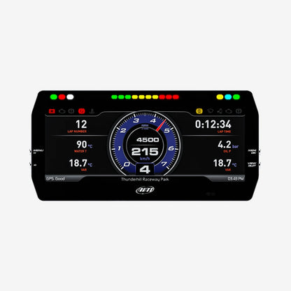

The MXT 1.3 Strada has a 10" TFT high contrast colour display. The visual quality is optimised by the ambient light sensor, which keeps the backlight at the best brightness levels. Race icons allow you to apply conditions to the LED icons.
Pre-Configured Pages
The MXT 1.3 Strada shows the RPM scale and all the data you need, like speed, water temperature and oil pressure, lap times and much more. You can customise pages to suit your requirements, including up to four additional fields. Define what data is shown with the end of scale and measure units. Swapping between the pages is easy; just use the push buttons.

14-Pin Standard Wiring
