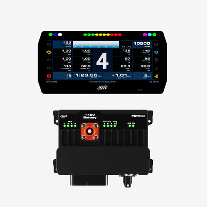

The Aim PDM08 system combines advanced power management, real time data display, and precision GPS tracking into a single integrated solution. Its 8-channel power distribution module replaces traditional fuse boxes and relays, while the fully configurable TFT display presents critical information through customisable layouts and intuitive race icons. When paired with the onboard GPS Module, the PDM kit delivers accurate lap timing and track-mapping capabilities for a complete, race-ready electronics package.

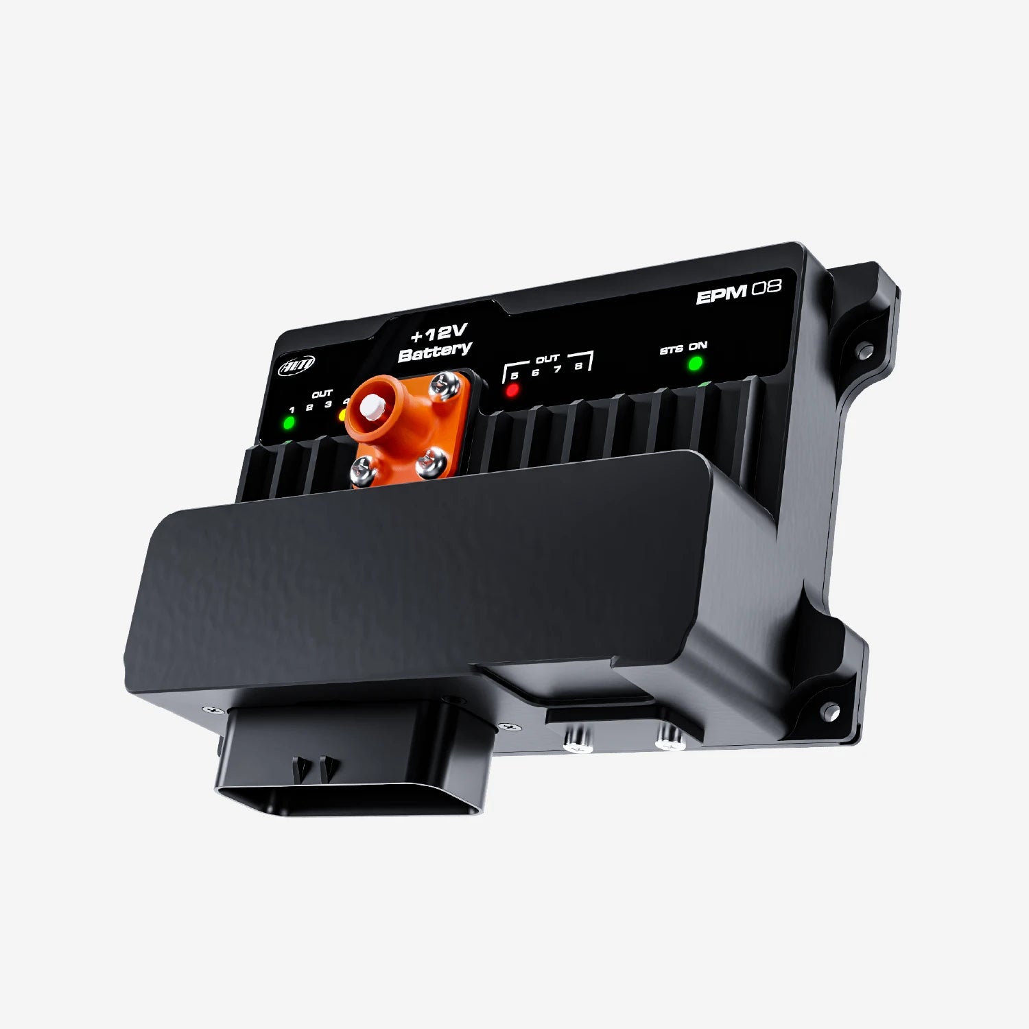

Aim PDM08 Power Distribution Module
Why Choose the PDM08 Race Dash Display Kit
The Aim PDM08 is an 8-channel advanced power distribution module designed to power a multitude of vehicle circuits, removing the need for traditional fuse boxes and relays. It allows for a simplified wiring harness with increased reliability and control functions. Paired with a TFT Display with Race Icons, a fully configurable display with a range of layouts to choose from, and an optional GPS Module that provides easy lap timing and lap position for track mapping, the PDM08 kit is the ultimate setup for full vehicle control and performance improvement.
The PDM08 features 8 high-side outputs: 1x with series diode rated up to 20A, 1x rated up to 25A, and 6x rated up to 15A, with a total continuous max current of 100A. Each output provides feedback to the data logger to provide vital information such as open circuits, short circuits, high/low voltage, and the number of fault retries. The time between the retries is user-definable. All outputs can be configured as PWMs for a soft start/stop. All of the PDM circuits can be set up and monitored via the Race Studio 3 software.

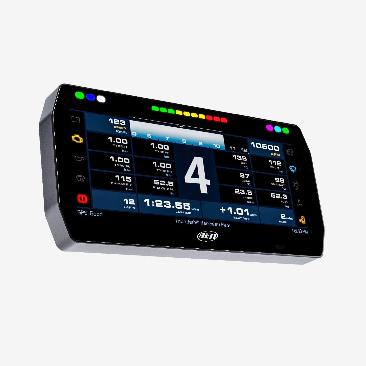

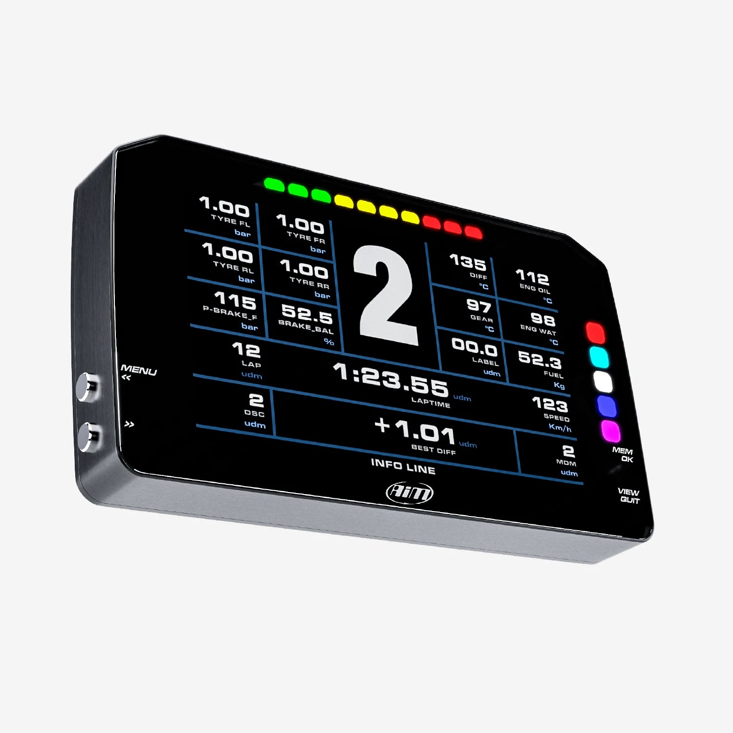

3 variations of PDM Dash Display in 5, 6 and 10-inch

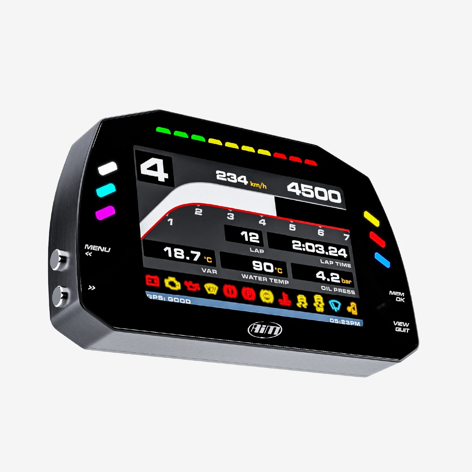

PDM Dash Displays with Race Icons
All versions have fully user-configurable displays and offer a range of layouts, and are available with "Road" or "Race" icons. Race icons with this particular kit allow you to apply conditions to the LED icons.
Load video: Delta times LED display feedback on the 5 inch PDM Display
Pre-Configured Pages
The Aim PDM Display can show the RPM scale and all the data you need, like speed, water temperature and oil pressure, lap times and much more. You can customise pages to suit your requirements, including up to four additional fields. Define what data is shown with the end of scale and measure units. Swapping between the pages is easy; just use the push buttons.

Data from Race Studio 3 showing the configurable dash displays
By connecting an Aim PDM08 to your Aim PDM Display - giving it the power to log your data - you can download your data and with Race Studio 3; create, modify, delete, import and export configurations of:

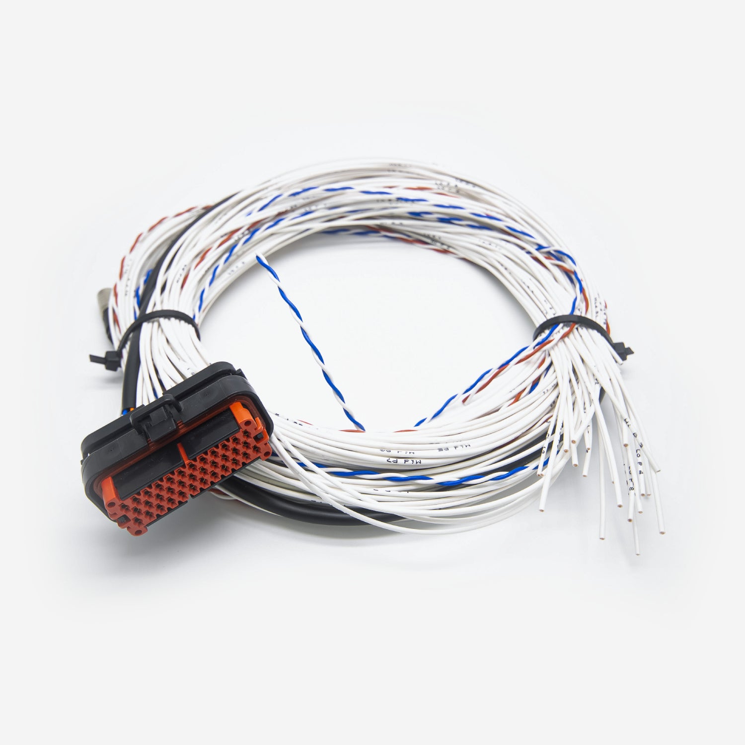

Optional Wiring Solutions
  • LEDs: 8 RGB LEDs + 1 PDM ON + 1 PDM STS (Status)
  • Inputs: 6 fully configurable (max 500Hz each), pullup + 12V, + 5V, pull down & analogue/digital
  • Speed Inputs: 2
  • Lin Bus: 1
  • CAN Connections: 3
  • Internal Memory: 4GB
  • External Analogue Camera Input: No
  • Connectors: 1 AMP connector, 1 Amphenol SurLok connector & 1 Rosenberger connector
  • Body: Anodised aluminium
  • Dimensions: 161 x 100.6 x 50.6mm
  • Weight: 500g
  • Waterproof: IP65
Power Outputs
  • 1 with a series diode rated up to 20A
  • 1 rated up to 25A
  • 6 rated up to 15A
  • Protected For: over-voltage, under-voltage, undercurrent, over-temperature
  • Total Max Current: 100A
SKU: PDM-8
Aim PDM Display
  • Display: 5" / 6" / 10" TFT
  • Waterproof: IP65

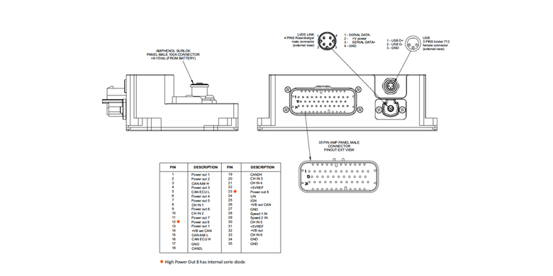

Pinouts

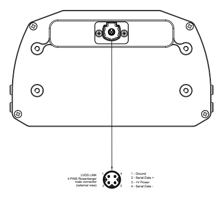

MXS 5 inch PDM display pinout 6" PDM Display Diagram GPS09 pinout
  • PDM08
  • Valgt skjerm
  • Black 35-Pin Plug & Pins
  • SurLok Power Connector
  • PDM08 LVDS Connector Cable
  • Download Cable
  • CAN Expansion Cable
PDM08 User Guide
PDM08 Tech Sheet
5" PDM Display Tech Sheet
6" PDM-skjerm teknisk ark
10" PDM-skjerm teknisk ark
GPS09 Pinout
