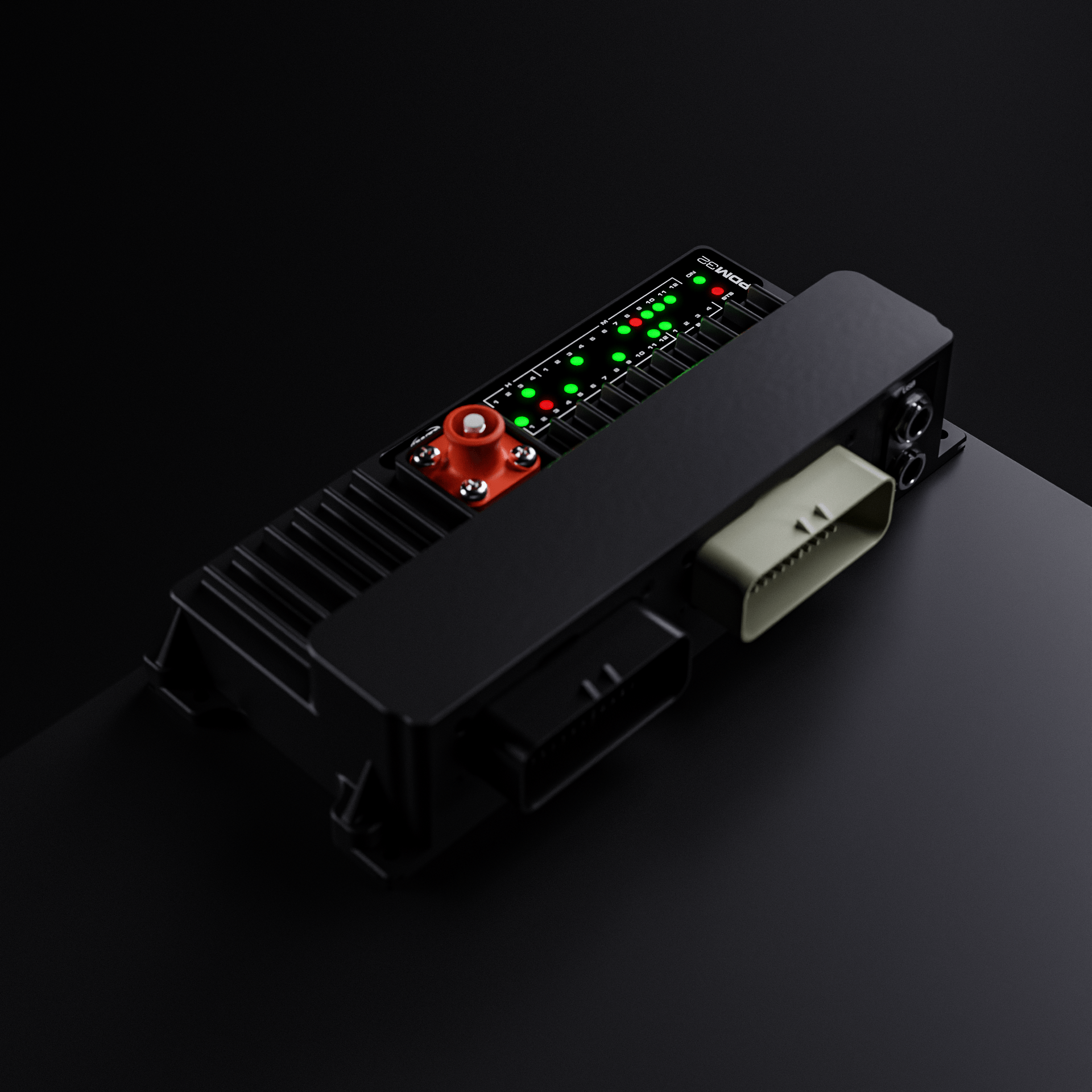

PDM32 Power Distribution Module
The PDM32 features 28 high-side outputs and 4 half-bridge outputs: 4x rated up to 20A (high power), 12x rated up to 15A (mid-power), 12x rated up to 10A (low power), and 4x rated up to 35A (half-bridge), with a total continuous max current of 120A. Each output provides feedback to the data logger to provide vital information such as open circuits, short circuits, high/low voltage, and the number of fault retires. The time between the retires is user-definable. All outputs can be configured as PWMs for a soft start/stop. All of the PDM circuits can be set up and monitored via the Race Studio 3 software.
