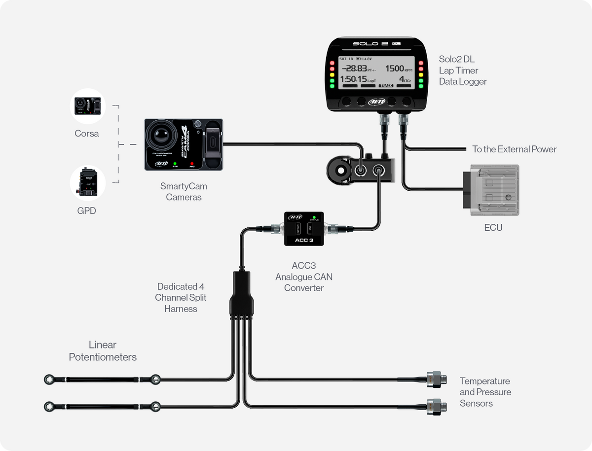

ACC diagram
ACC3 pinout
Harness Options
ACC3 harness diagram
Connections
ACC connection example with Solo 2 DL and sensors
