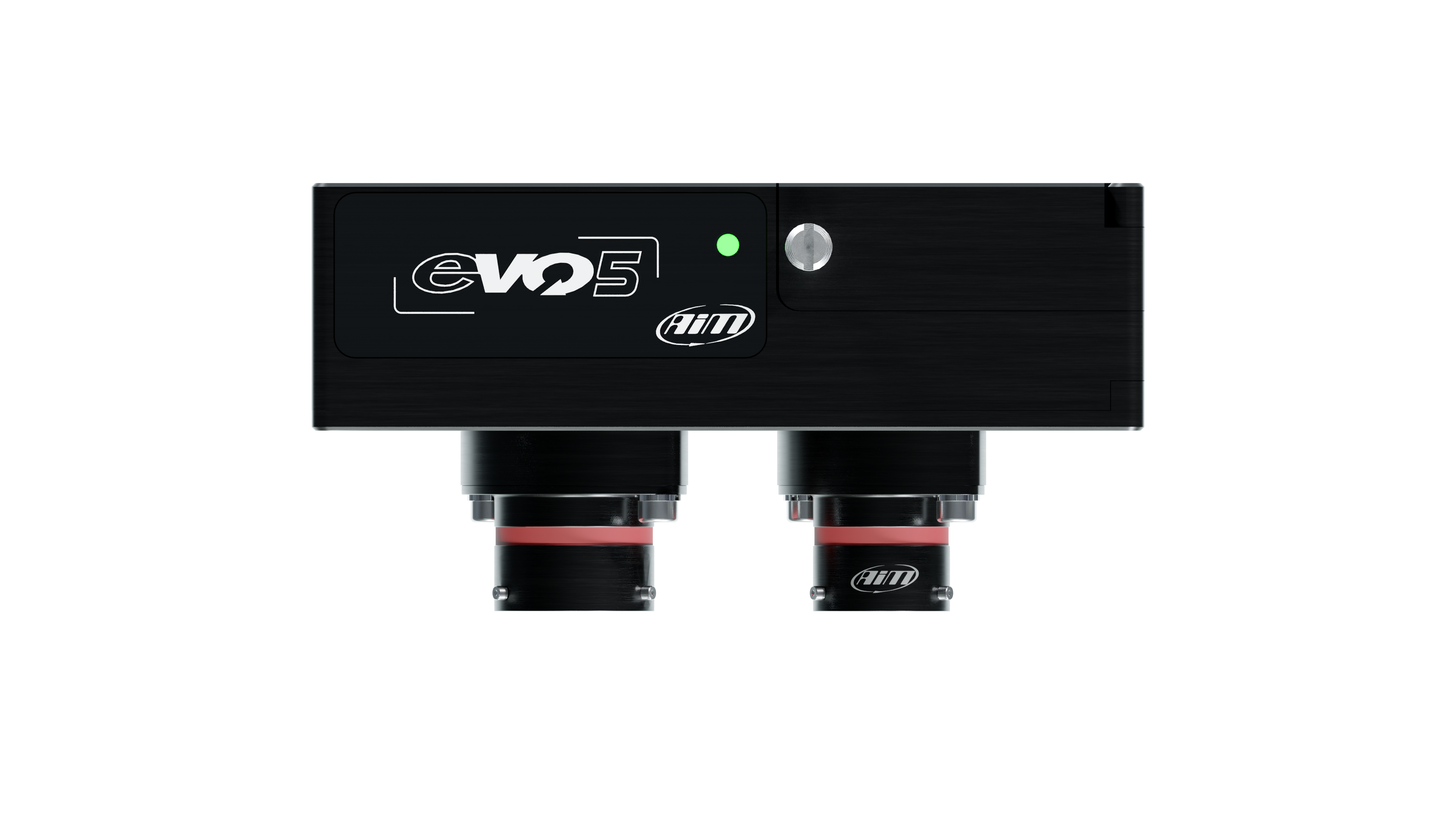

    The Aim EVO5 Motorcycle World SSP600 FIM kit has been specifically designed for World SSP600 bikes.
    Two multi-channel connectors GPS Module included
    ECU connection to over 1000+ ECUs CAN output
    Aim EVO5 Data Logger
    Aim has designed a specific connection for the World SSP600 bike ECU for the EVO5. The specially designed connection kit contains a six pin male Sumitomo connector, Sumitomo connector pins, rubber wire seals and 2 dummy plugs, this kit will allow you to read data from the ECU via CAN, while at the same time powering the system.

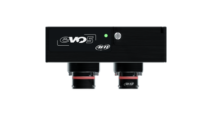

    EVO5 is the evolution of the traditional Data Logger, with its compact aluminium body, EVO5 can be easily placed in any vehicle. Its configuration with Race Studio 3 software is simple and immediate.
    The incoming data from your ECU via CAN, the internal accelerometer and gyro, and the GPS Module are all recorded by the EVO5. The unit can also accept digital or analogue inputs. Sensors can be connected to 8 configurable analogue channels, to the RPM input and up to 4 wheel speed inputs.

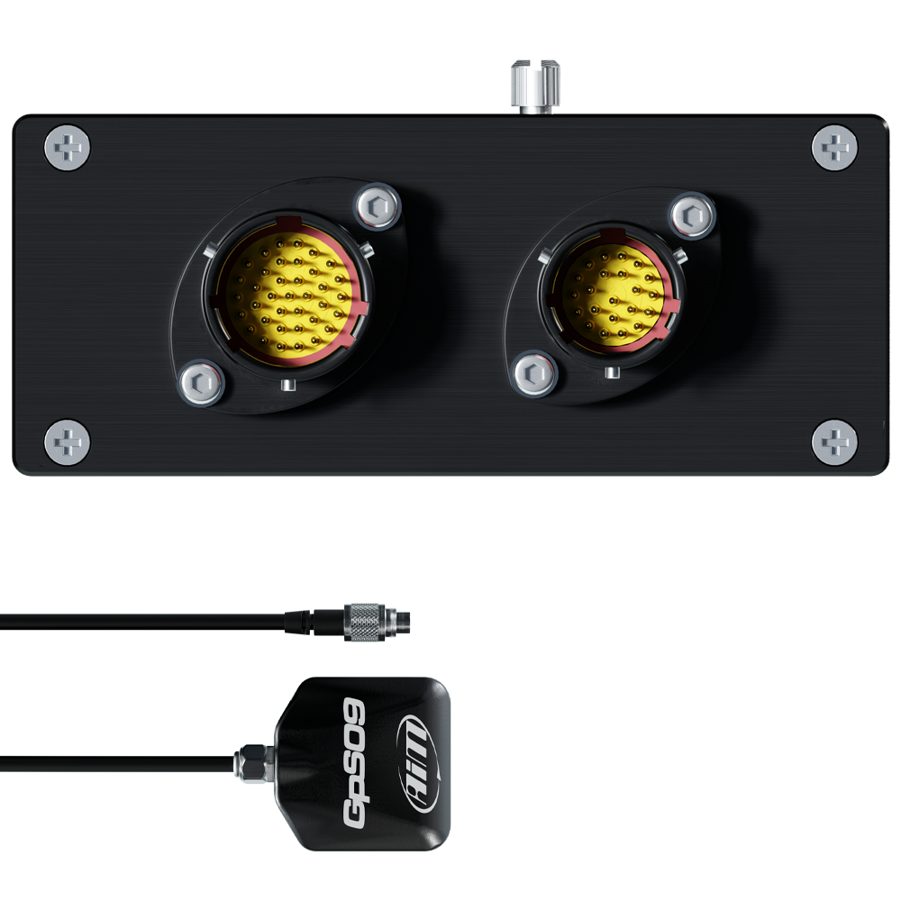

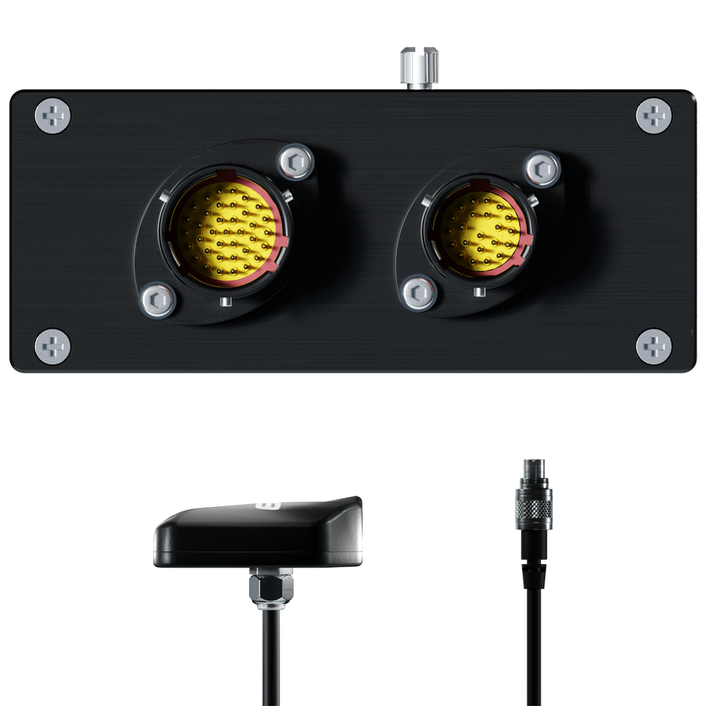

    Two Multi-Channel Motorsport Connectors
    Straightforward, the 37 pins connector harness supplied with the kit offers your main applications such as power, CAN, etc
    A second 22 pin connector harness is available for functions like CAN2 and digital outputs. This harness is sold separately. See Accessories Tab
