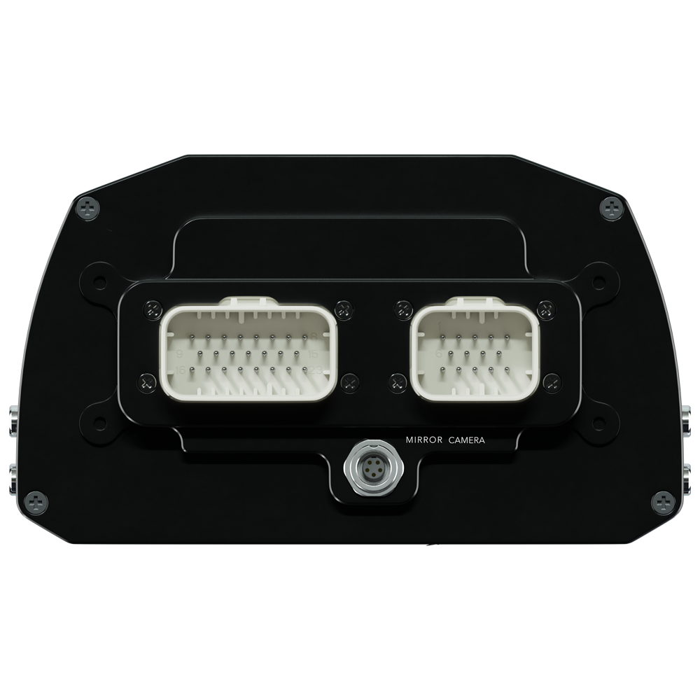

The MXS 1.3 Strada has a choice of ECU connections. Choose between the OBDII or K-Line CAN. Depending on whether you want to connect to the motorcycle's ECU using the OBDII port or directly to the ECU through the CAN channel.
Connecting the MXS 1.3 Strada dash to your motorcycle's ECU is simple; you can sample and display dozens of channels. This is usually the quickest and easiest setup, needing only 2 cable connections to the ECU instead of multiple connections to analogue sensors.

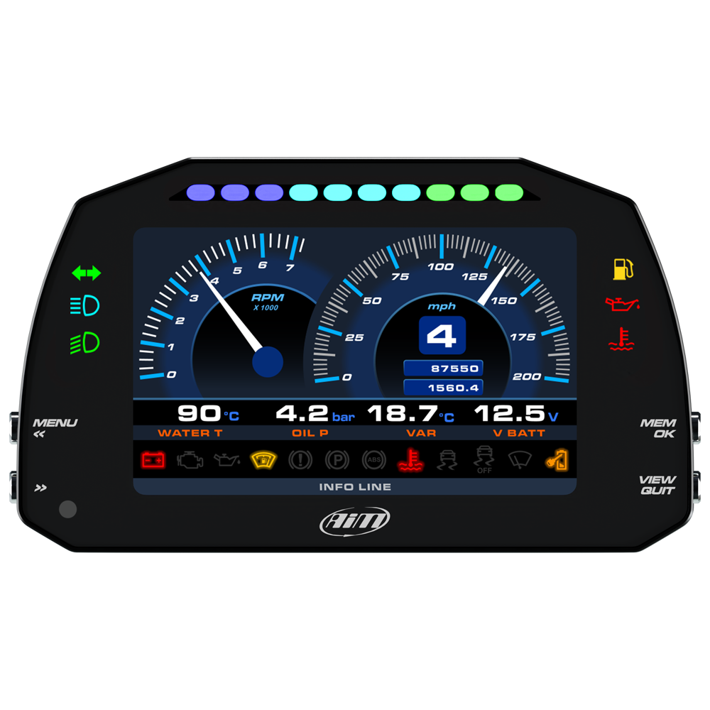

Display with Road Icons
The MXS 1.3 Strada has a 5" TFT high contrast colour display. The visual quality is optimised by the ambient light sensor, which keeps the backlight at the best brightness levels for riding on the road.
