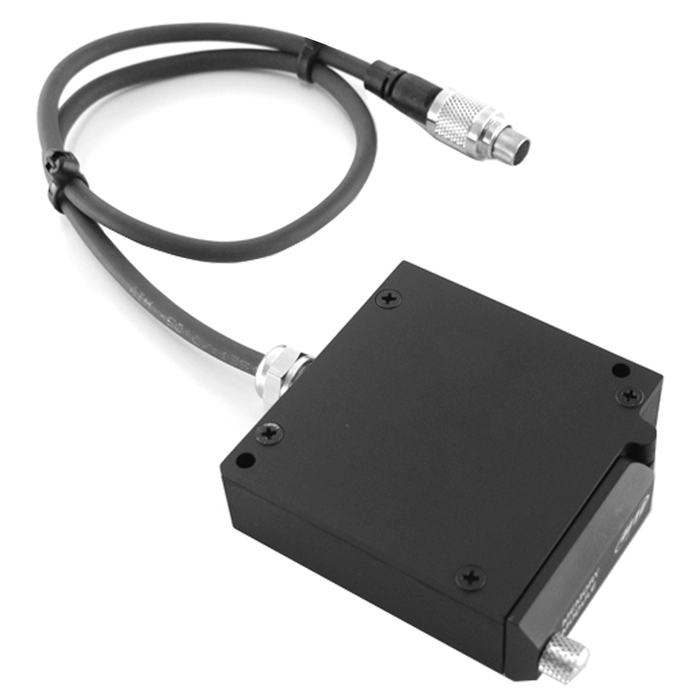

The AiM Memory Module is a small SD Card holder connected via CAN bus to the MXL2, MXS, MXP, MXG dashes, also suitable for the EVO4S EVO5 data loggers.
Suitable for MX series, EVO4S, EVO5 Massive data storage
LED recording indicator Enhance your logger performance
AiM SD Card Memory Module

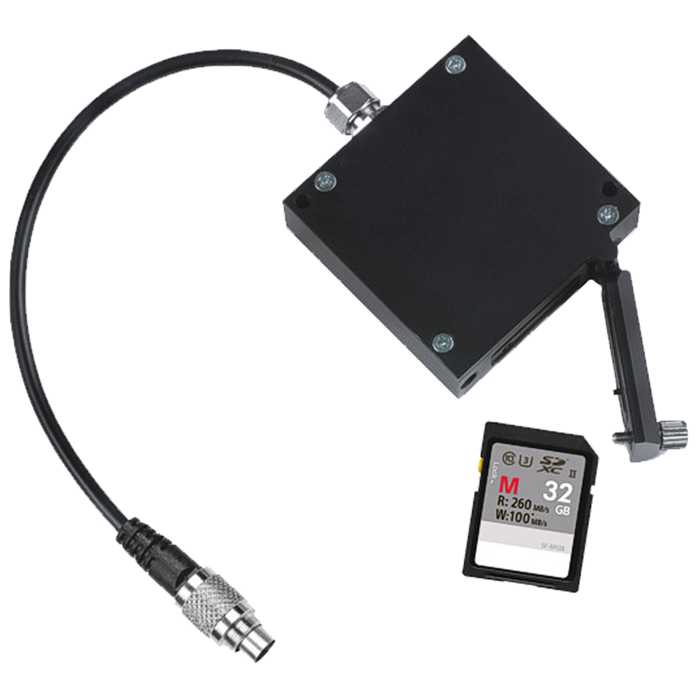

Connect the Module to the logger; This will save data in the logger and on the SD card with no configuration needed.
The SD card can be removed and replaced during pit stops while the vehicle engine is still on. Making it easy to get the data during races or extended tests when time is limited.
When the session is over, remove the SD card from the Module, put it into your PC, and download the data using Race Studio 3.
The Module features a front LED showing its recording data.
The Memory Module can support 32GB SD cards (not included)
