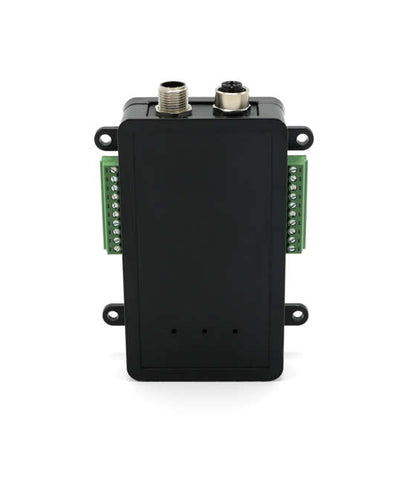

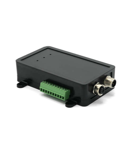

    The Battery Communication Interface (BCI) is a device that gathers data from multiple Super B lithium batteries and represents them as one single battery system.
    • Product Features
    • Control pre-charge functionality. Therefore, an additional contactor
      and resistor is needed tailored to the application
    • Protocol conversions (depending on BCI software version)
    • Control charger by CAN or charge enable signal (depending on BCI software version)
    • Manage the heaters of Super B Li-ion batteries outfitted with heating elements
