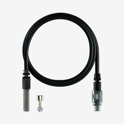

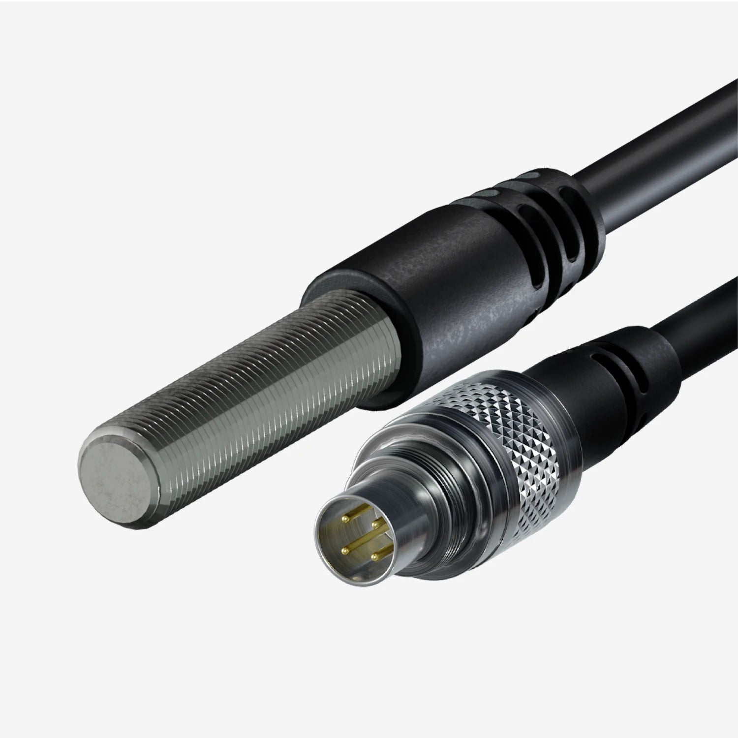

    Rear Speed Pick Up Sensor
    The AiM wheel speed non-contact sensor for MyChron Displays.
    Key Features:
    • 712 4 pin male connector
    • Speed Sensor
    • Magnetic
    • Free Race Studio 3 download
    Rear Speed Wheel Sensor
    The Aim axle rear speed pickup sensor is suitable for use with the MyChron 6 and MyChron 6 2T, as well as our older MyChron Kart Dash/Data Logger models.

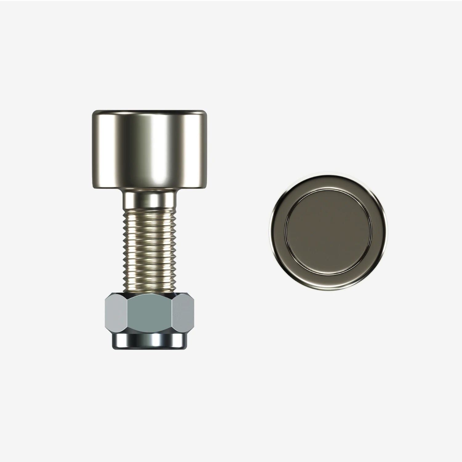

    The rear axle speed sensor has an M10 thread and is supplied with nuts to be mounted on a bracket (not supplied).
    It is supplied with a magnetic trigger bolt and is to be installed at 3.5mm from the magnet.

      Sensor Electrical Characteristics:
      • Power Tension: 6-24 VDC
      • Power Supply: 13.5 mA
      • Output Signal Type: Pulse 0-5 volt
      • Max Current Output: 20 mA
      • Max Operating Frequency: 100kHz
      • Max Sensibility Distance: 20mm
      • Recommended Distance: 10mm
      • Number of Pulses for Wheel Revolution: 1
      Sensor Mechanical Characteristics:
      • Operating Temperature Range: From -20 to +85° C
      • Cable Length: 1700mm
      Whats In The Box
      Aim Axle Rear Speed Pickup Sensor
      • Rear Speed Wheel Sensor
      • 3 Nuts
      • 1 Screw
