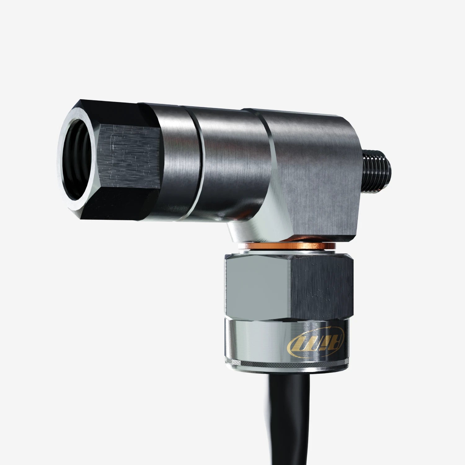

The Aim Brake Pressure Sensor Kit is suitable for brake pressure readings, measuring pressures up to 100 bar on OTK karts. This brake pressure sensor sits within the brake line and measures exactly how much pressure passes through the kart's brake pedal.
Why Choose the Aim Brake Pressure Sensor Kit

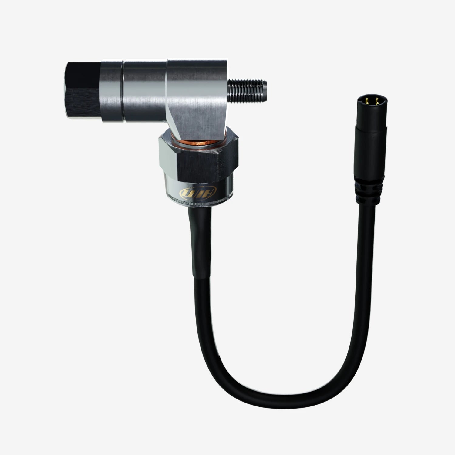

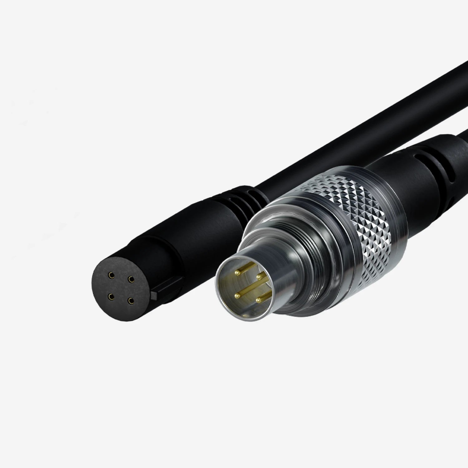

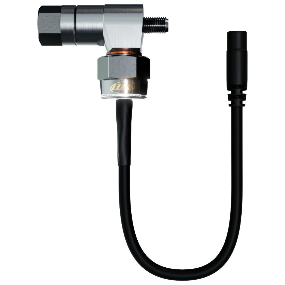

With an M10 0-100 bar brake pressure sensor, a stainless steel OTK kart T-piece mount and a 4-pin 719 female to 712 male binder patch lead, this kit provides everything you need to monitor brake pressure directly on your MyChron 4/5 Lap Timer. Ultimately, the Brake Pressure Sensor Kit helps you understand how much pressure you are applying to the pedal under braking and will help improve braking performance.
How the Brake Pressure Sensor Works

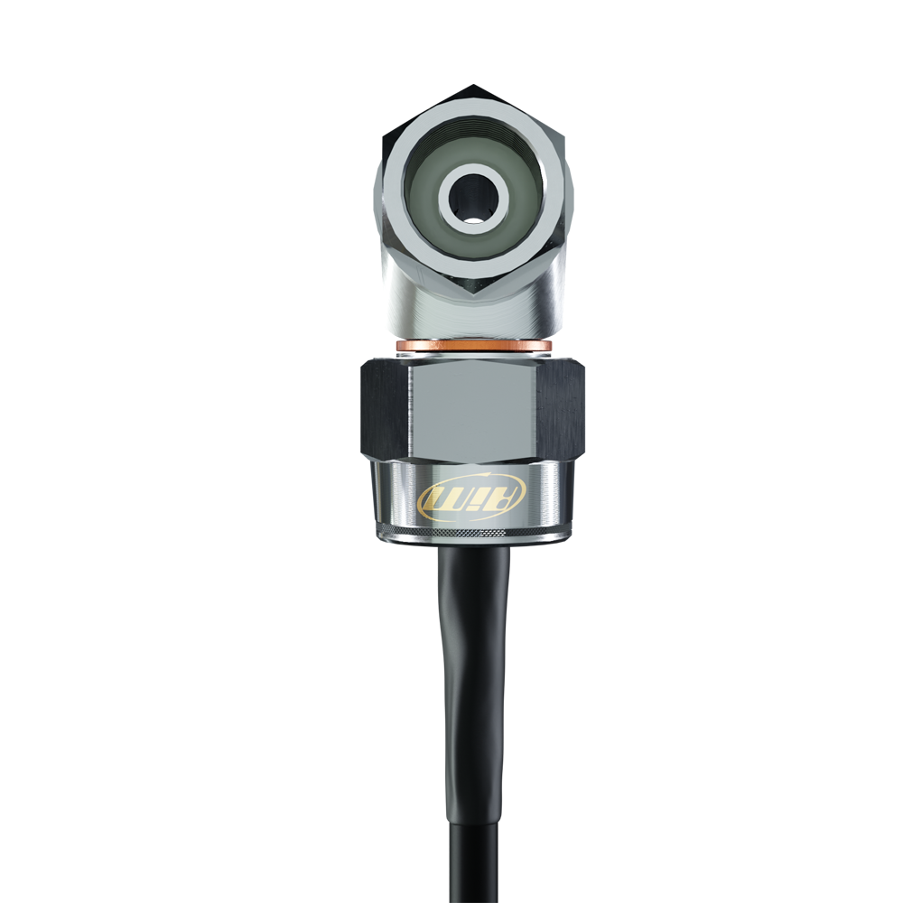

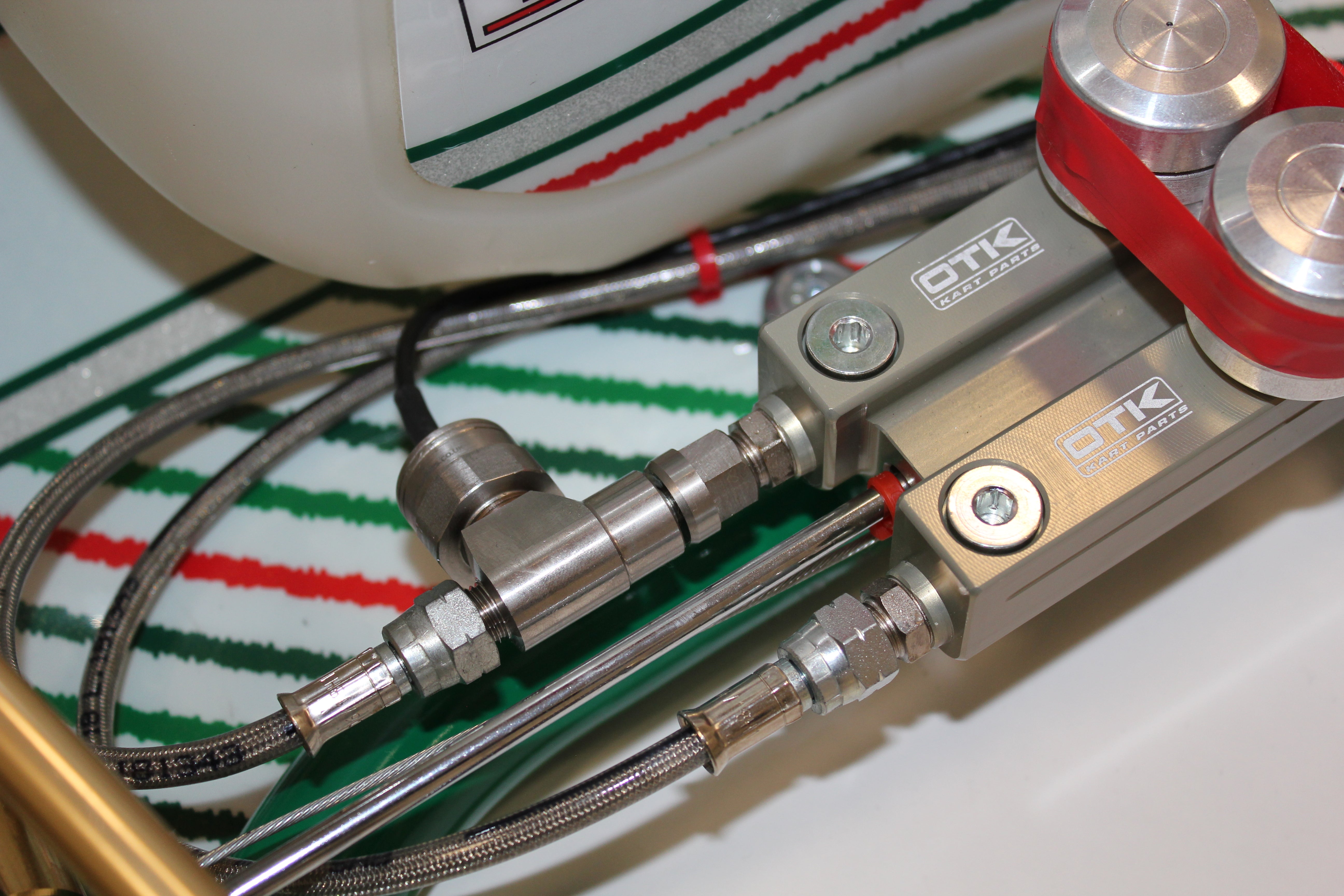

The Aim Brake Pressure Sensor is installed directly into the hydraulic brake line, usually at a calliper or master cylinder. As you apply the brakes, hydraulic pressure builds up in the line. The sensor detects this pressure and converts it into a voltage signal, which is then sent to your Aim dash or data logger. That voltage is interpreted as a pressure value (up to 100 bar), giving you a live readout of exactly how hard you’re pressing the brakes at any given moment.

The Pressure Sensor Kit comes with everything you need to monitor brake pressure on an OTK kart: a brake pressure sensor, a T-piece mount and a patch lead to connect the system to an Aim MyChron 4, MyChron 5, MyChron 4 2T, MyChron 5 2T, MyChron 5S, MyChron 5S 2T or MyChron Expansion.

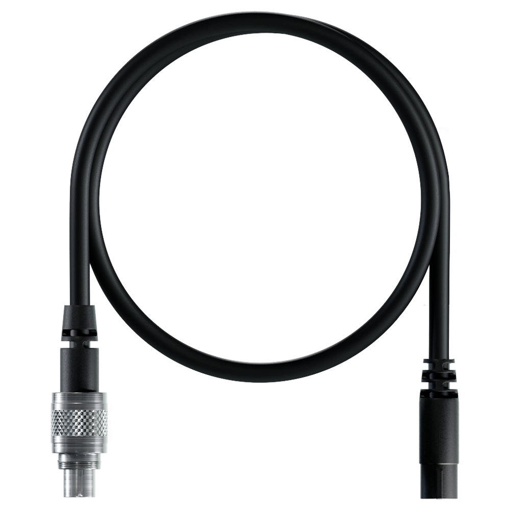

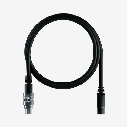

  • Patch Lead: 712 - 719 4-pin binder

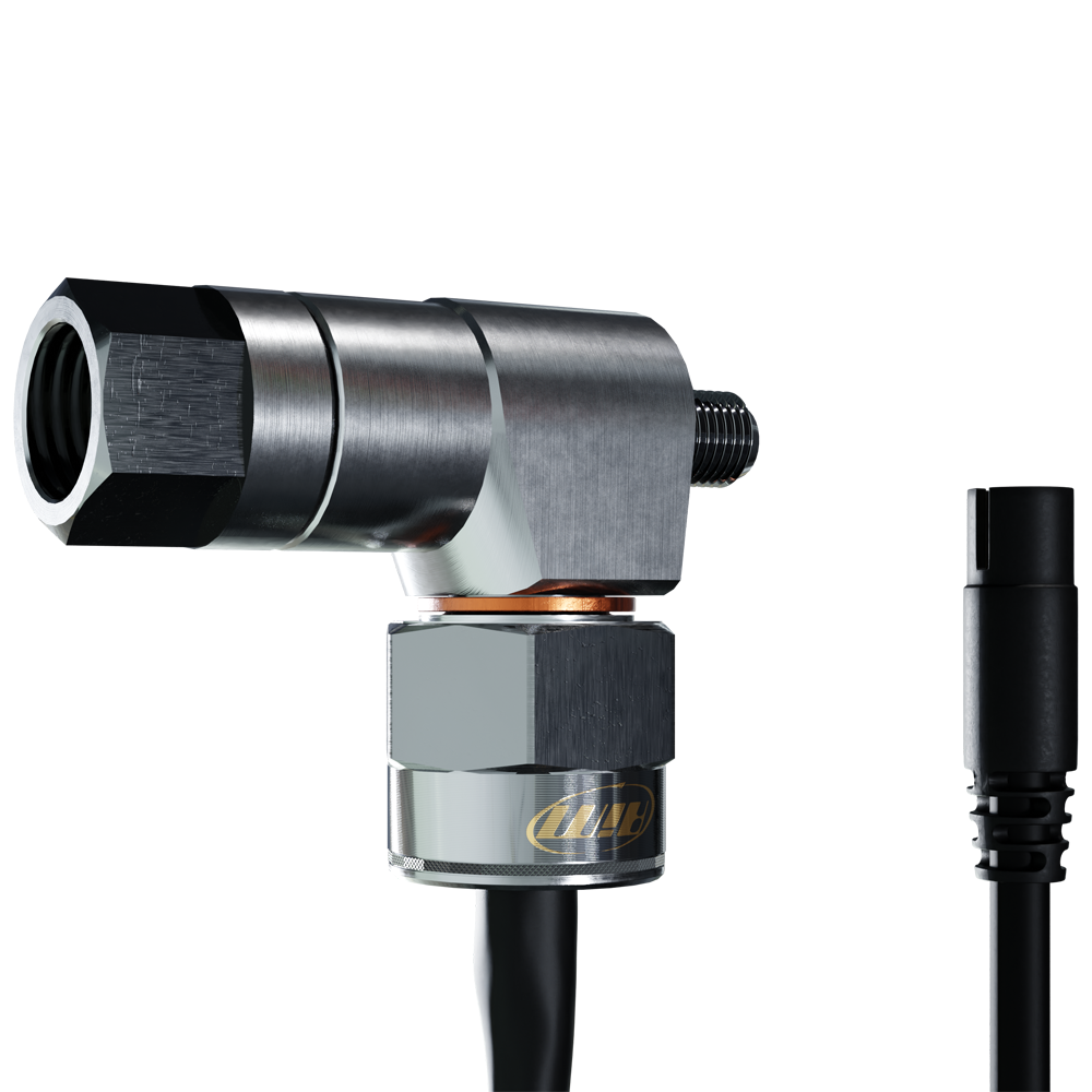

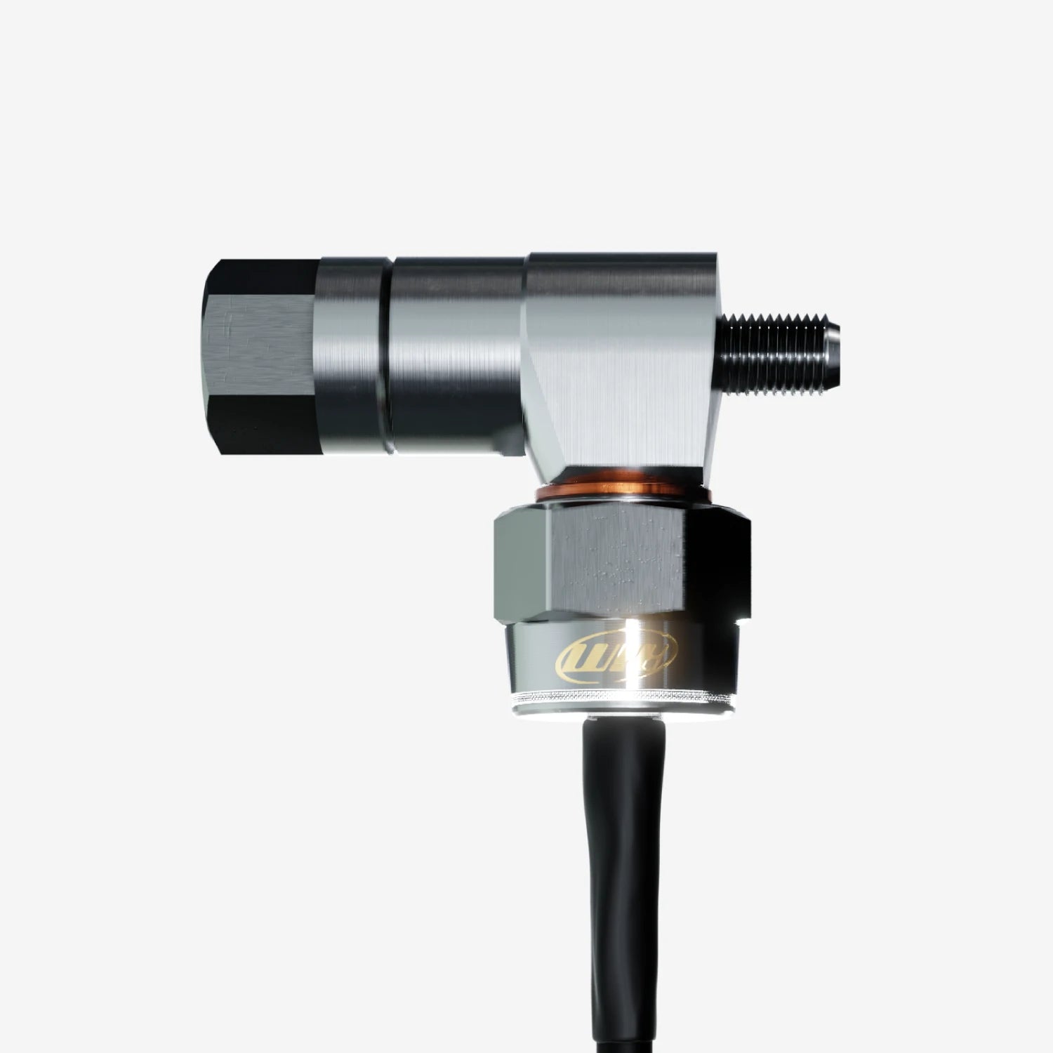

  • Pressure Sensor M10
  • Kart Brake Pressure T-Piece - AimShop.com
    Brake Pressure Sensor T-Piece
  • Aim 712-719 Male to Female 4 Pin Patch Lead - AimShop.com
    712-719 Male to Female Patch Lead
