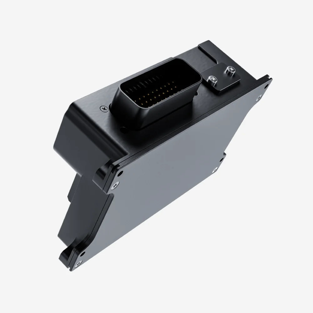

The Expansion Power Module adds power outputs to your installation. They are available in two variants, the EPM08 with 8 power outputs, and the EPM32 with 02 power outputs.
Why Choose the EPM08?
The EPM08 allows for 8 power outputs and is compatible with the Aim MXS Series and the Steering Wheel 4. With 6 fully configurable analogue inputs at 500Hz each, digital inputs, and a max current of 100A, they are perfectly suited for adding extra power to your PDM08.
Connectivity

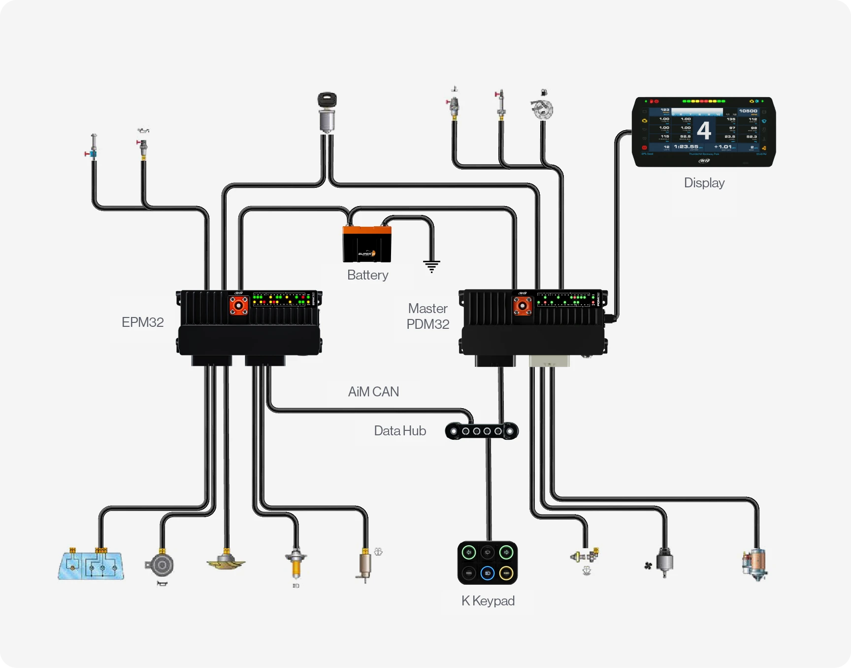

The Aim EPM range includes powerful systems such as the 8-channel EPM and the versatile 32-channel EPM, giving you the flexibility to choose the ideal setup for your specific needs. Featuring 2 CAN networks, these expansion power modules are controlled by the Aim Exp connection.
The EPM connects to an existing Aim PDM, Steering Wheel 4, or a dash display/logger from the Aim MX range. These devices control the vehicle's power without the need for fuses or relays, with outputs that can deliver up to 35A individually.
If connected to a logger, they will also allow the recording and analysis of where every amp is used. A Strada dash will also allow the power control, but without the logging ability.

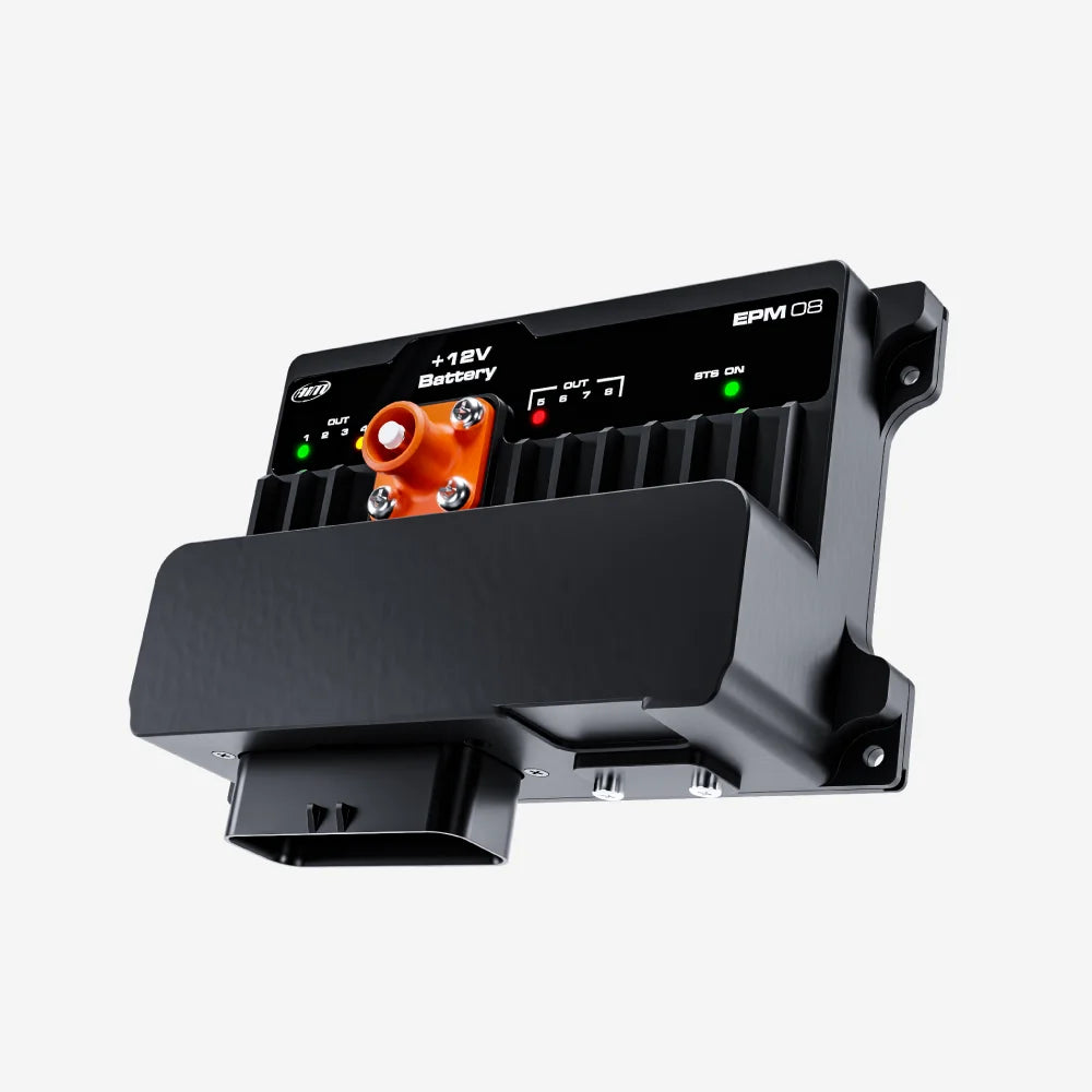

  • Connector: 1 AMP connector + 1 Amphenol Surlok connector
  • LEDs: 8 RGB LEDs + 1 EPM ON + 1 EPM STS (status)
  • Body: Anodised aluminium
Inputs
  • Analogue Inputs: 6 fully configurable analogue inputs (0-5V; 0-12V) recorded at max 500Hz each
  • Digital Inputs: Pull-up/pull-down
Power Outputs
  • 1 with series diode rated up to 20A (high side)
  • 1 rated up to 25A (high side)
  • 6 rated up to 15A (high side)
  • Protected For: overvoltage, undervoltage, short circuit, overcurrent and overtemperature
  • Total Max Current: 100A

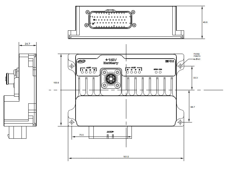

  • Dimensions: 161 x 100.6 x 50.6mm
  • Weight: 370g

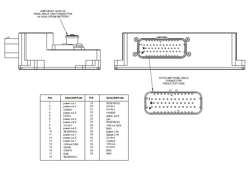

EPM08 diagram
EPM08 pinout
