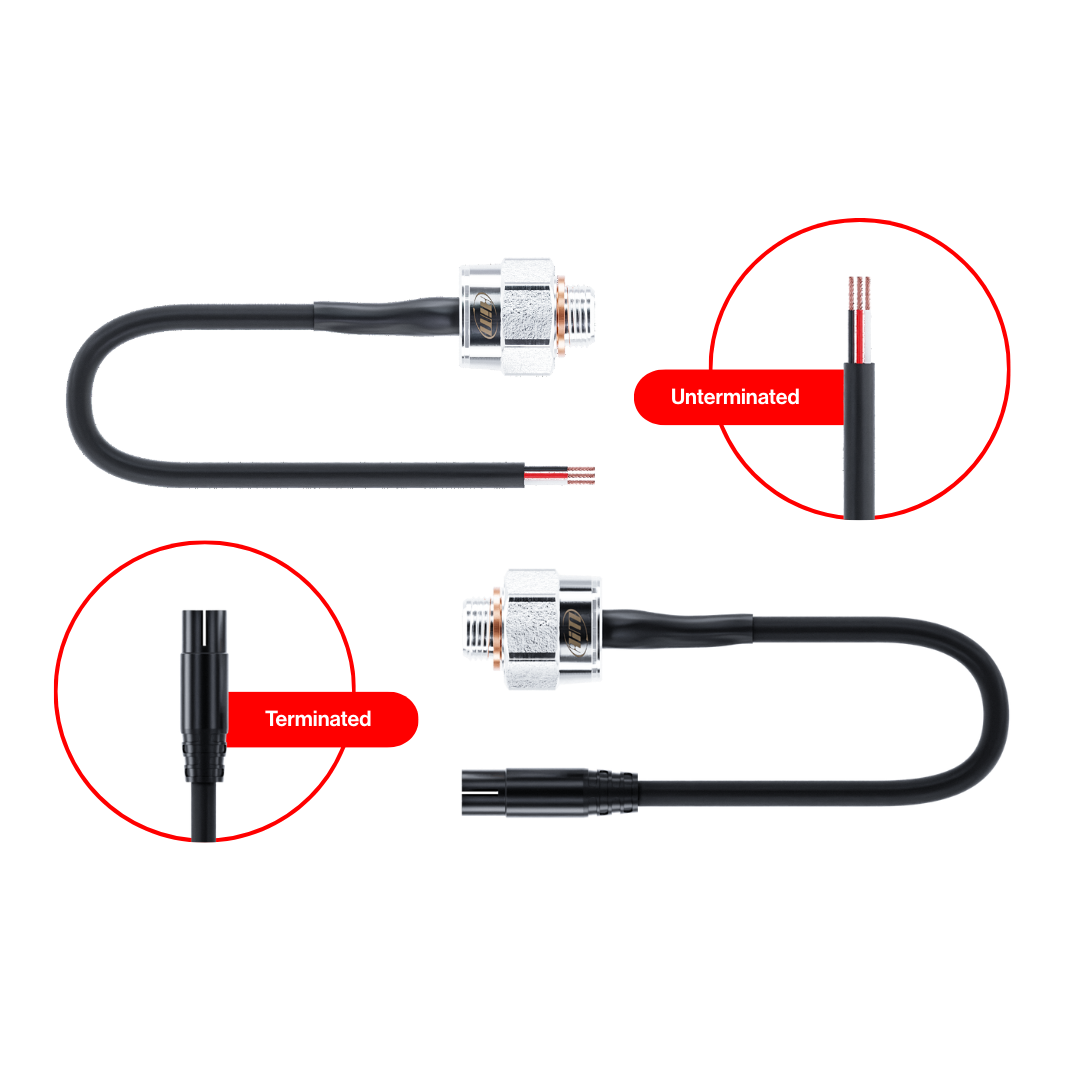

The Aim 0-15 PSI Pressure Sensor is available in 1/8 NPT and is fitted with a 4-pin 719 male binder connector to suit Aim loggers, dash loggers, lap timers and dash displays. Many aspects affect various engine pressures, so knowing your engine has the correct amount of pressure is paramount to longevity and performance.

We also offer unterminated sensor that are designed to work seamlessly with Bosch, MoTeC, Cosworth, or other manufacturer hardware, making it easy for you to integrate the reliable and efficient Aim Pressure Sensors into any setup.
