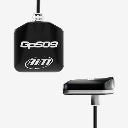

GPS09 activates instant lap tracking, recognising start/finish lines and details effortlessly. Please Note: The GPS09 has no inertial platform.
Why Choose the Aim GPS09 Module
The Aim GPS09 Module guarantees precision and reliability, working with almost 20 satellites to improve its performance.
With an average of less than half a metre tolerance, the absolute precision of the GPS09 Module determines the exact vehicle position. The satellite signal uses rapidly locked moments after switching on the device, and there is no risk of missing signals due to noise or interference in the system.
On the Track
The GPS Module is fast in satellite signal acquisition and reliable in adverse situations. GPS Manager allows you to set track start/finish lines and splits, and to download a comprehensive track database. With the GPS09 Module, you get important information, i.e. chassis analysis, track position, etc, as well as position, speed, cornering in-line and lateral G and automatic lap times.
With a Point to Point Mode available, maximise rally stage precision for superior cornering. This mode is designed to elevate control and manoeuvrability, enhancing your overall driving experience through challenging stages. With Point to Point Mode, every turn becomes an opportunity to showcase skill and finesse on the track.
The Aim GPS09 Module delivers real-time lap insights for peak racing performance. Capture lap and split times with comprehensive telemetry during track sessions, and optimise based on theoretical best laps for actionable insights when needed.

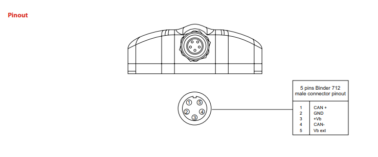

GPS09 pinout
GPS09 Pinout

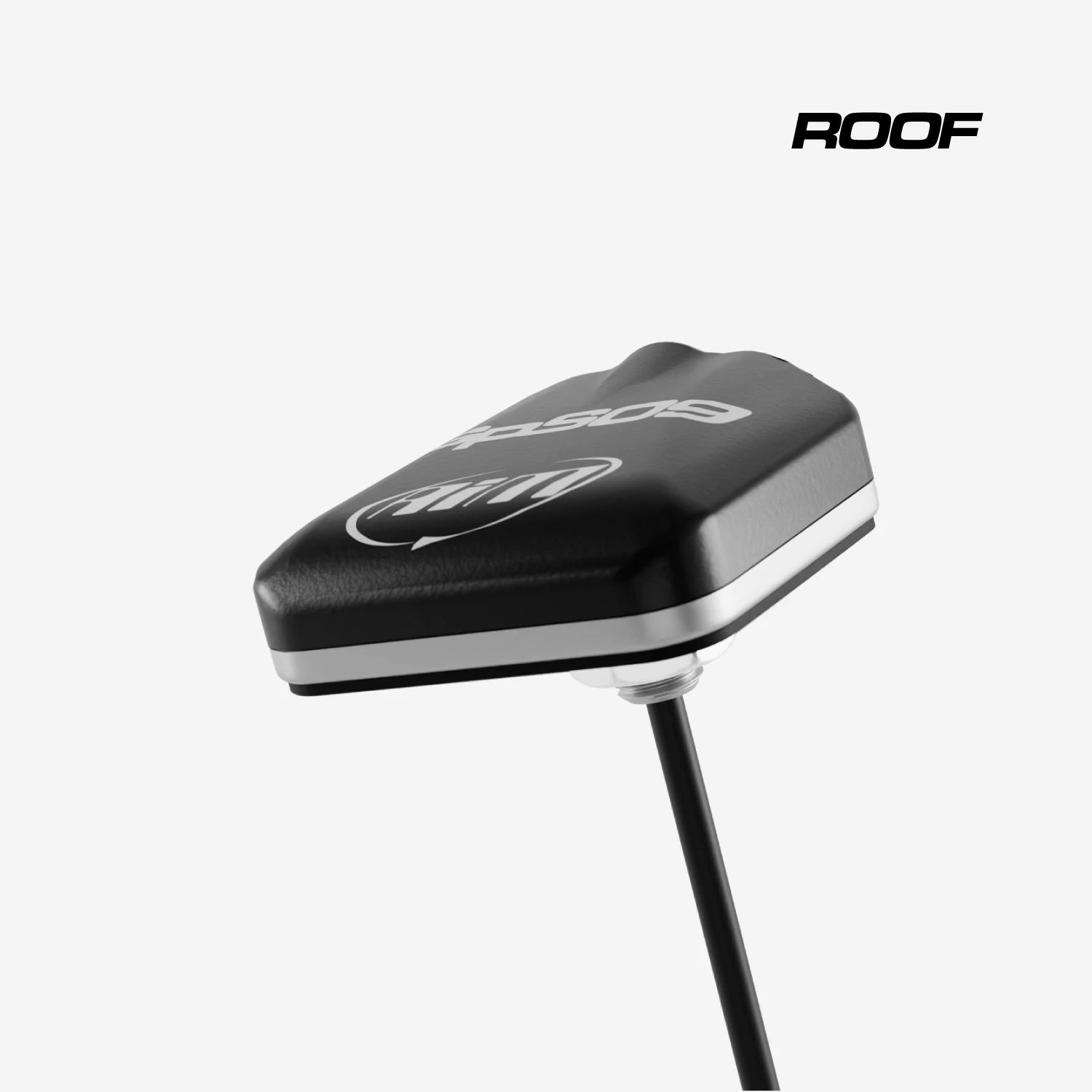

How do you install the GPS09 Module?

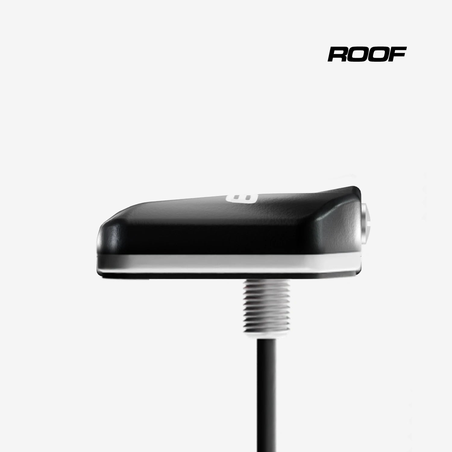

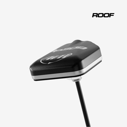

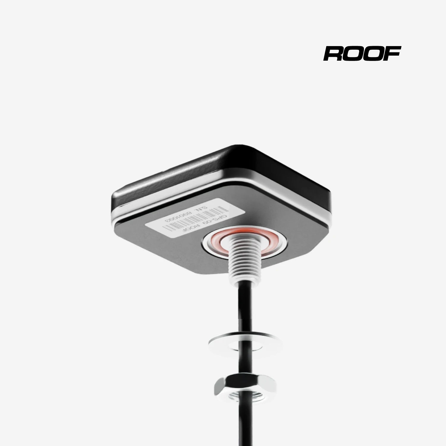

Installing the Aim GPS09 Module involves mounting the antenna on a metal-free, unobstructed surface like the roof or top of the dash for maximum satellite visibility, then simply connecting it via a CAN cable to your Aim logger or dash.
