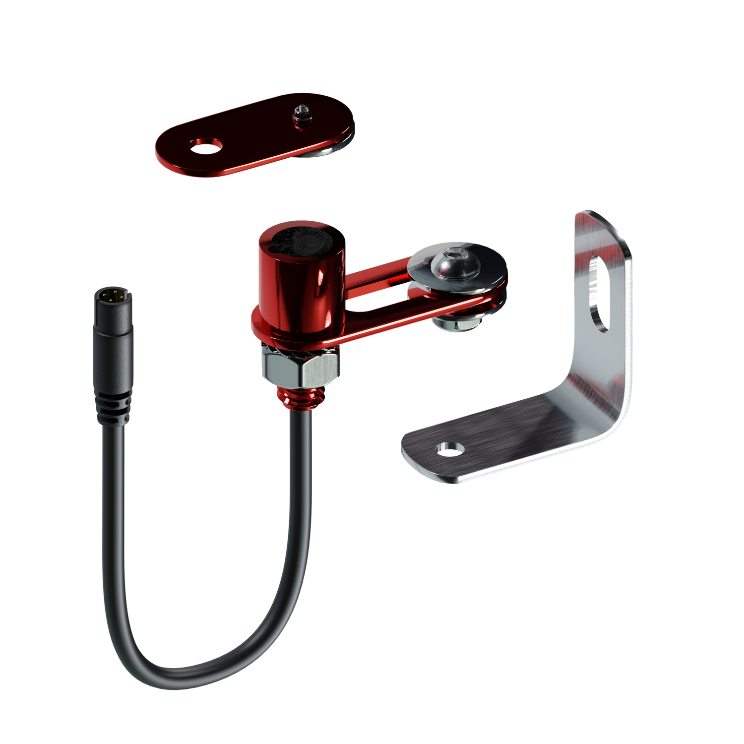

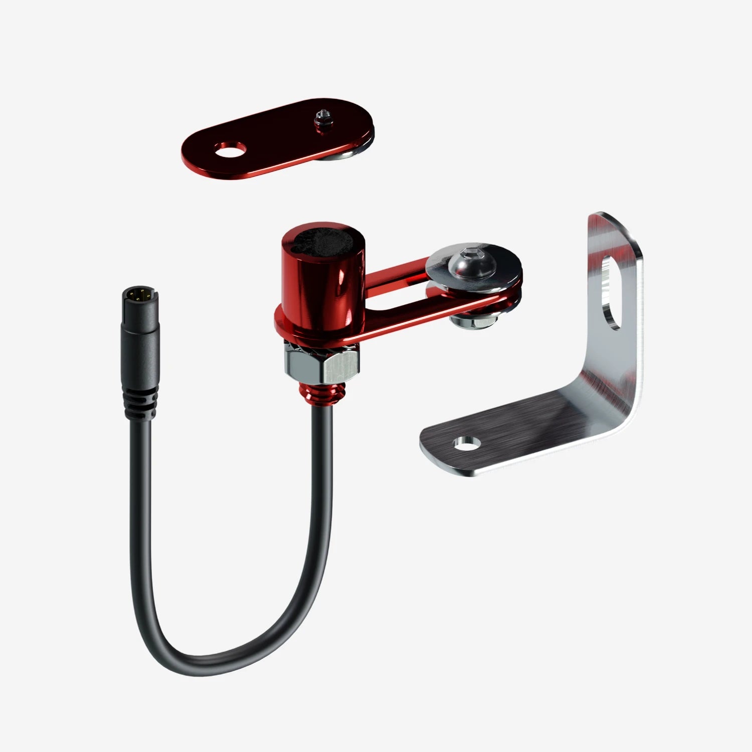

    AiM Kart Brake/Accelerator Pedal Position Sensor
    The AiM Brake/Accelerator pedal position sensor provides a precise indication of pedal position.
    Gives a precise indication of the pedal position Compatible with MyChron 4 & MyChron 5
    Complete with brackets and fittings

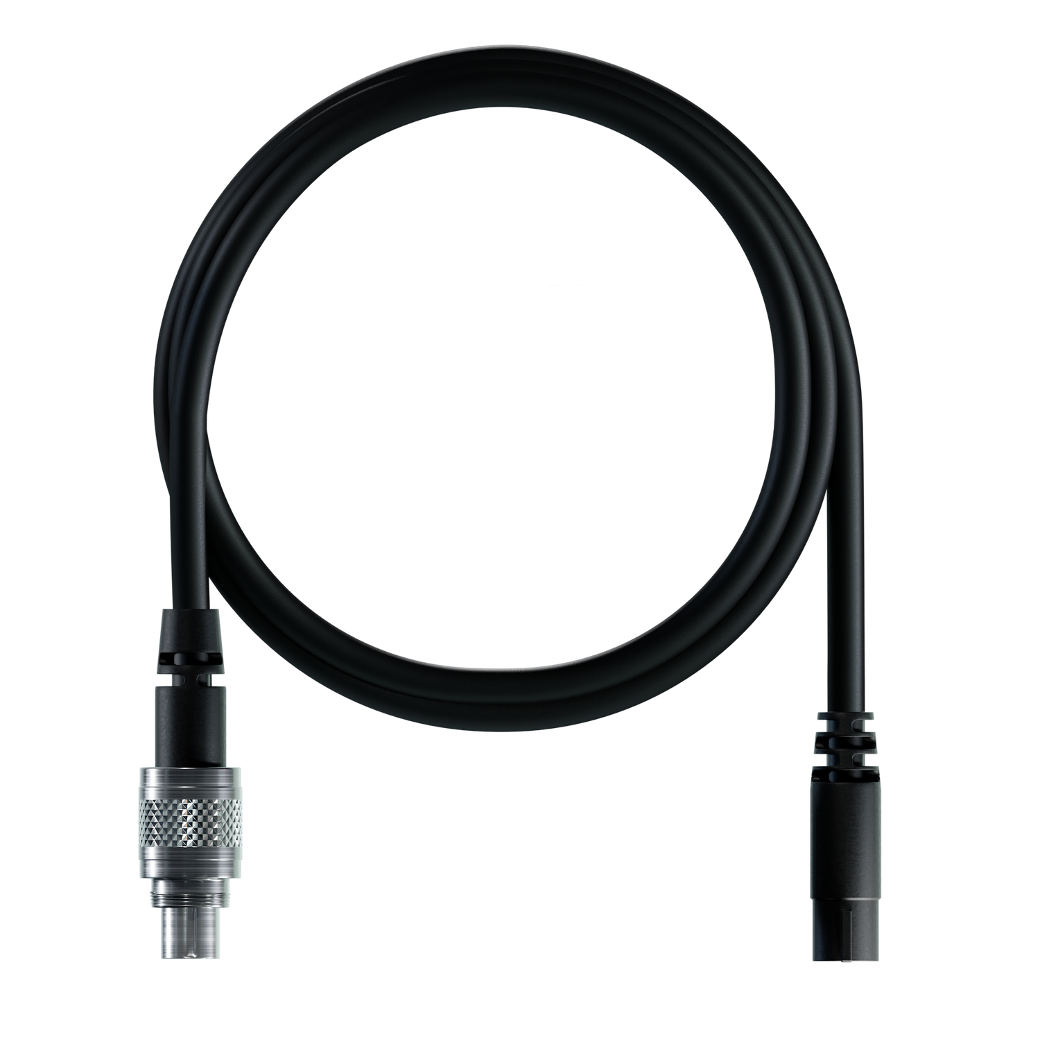

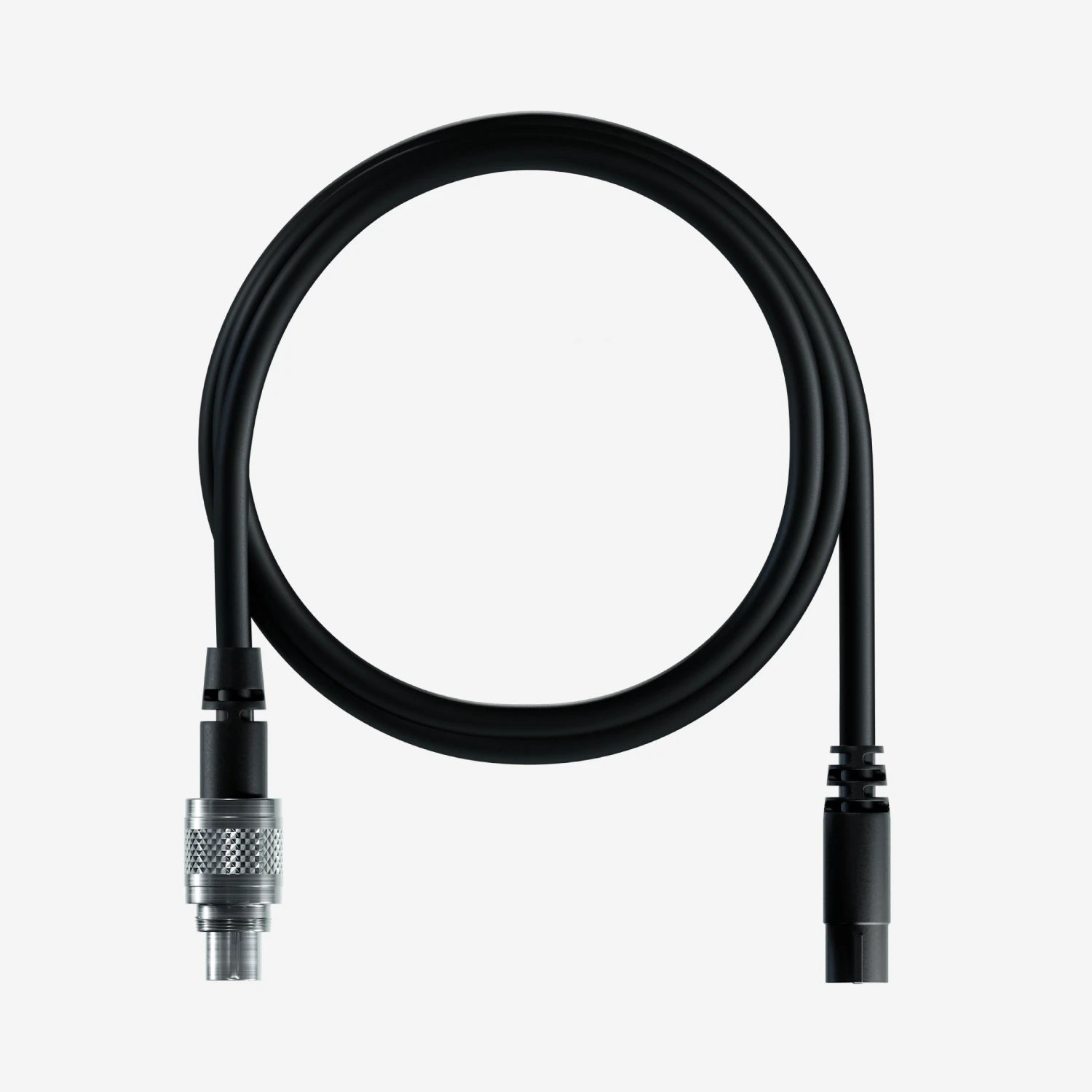

    The AiM non-contact throttle/brake position sensor is suitable for all AIM MyChron kart dash/data loggers (MyChron5 S, MyChron5 and MyChron4 (both single and two temp versions). The sensor comes complete with the patch lead required to connect the sensor to the MyChron expansion box, the standard method of connecting additional sensors to your system.
    The position sensor can be used for the throttle or the brake pedal, representing critical support for kart drivers. Providing a precise indication of timing and intensity of acceleration or braking allowing you to understand if the driver is accelerating/braking at the right moment and with the correct strength. An essential fact to evaluate driver behaviour and improve their performance.
    Main Functions
    Measures travel and show all values in percentage in a 0 to 100% range.
    An effortless way to evaluate a drivers behaviour and improve their performance
    Provides a precise indication of timing and intensity of braking and acceleration
    Robust and water-resistant

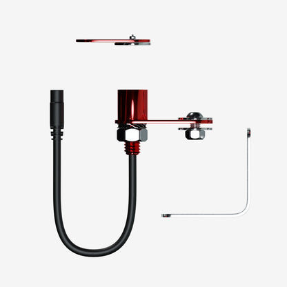

    The sensor measures the distance between two points using a pedal position sensor. I
    t gives an exact indication of the pedal position, measures its travel and shows all values in percentage in a 0 to 100% range.

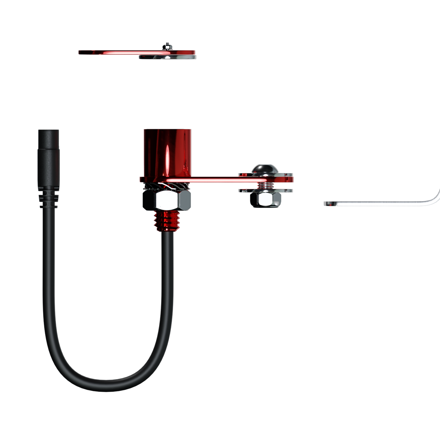

    AiM Kart Brake & Accelerator Pedal Position Sensor

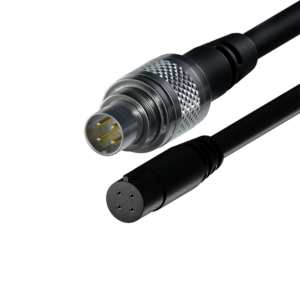

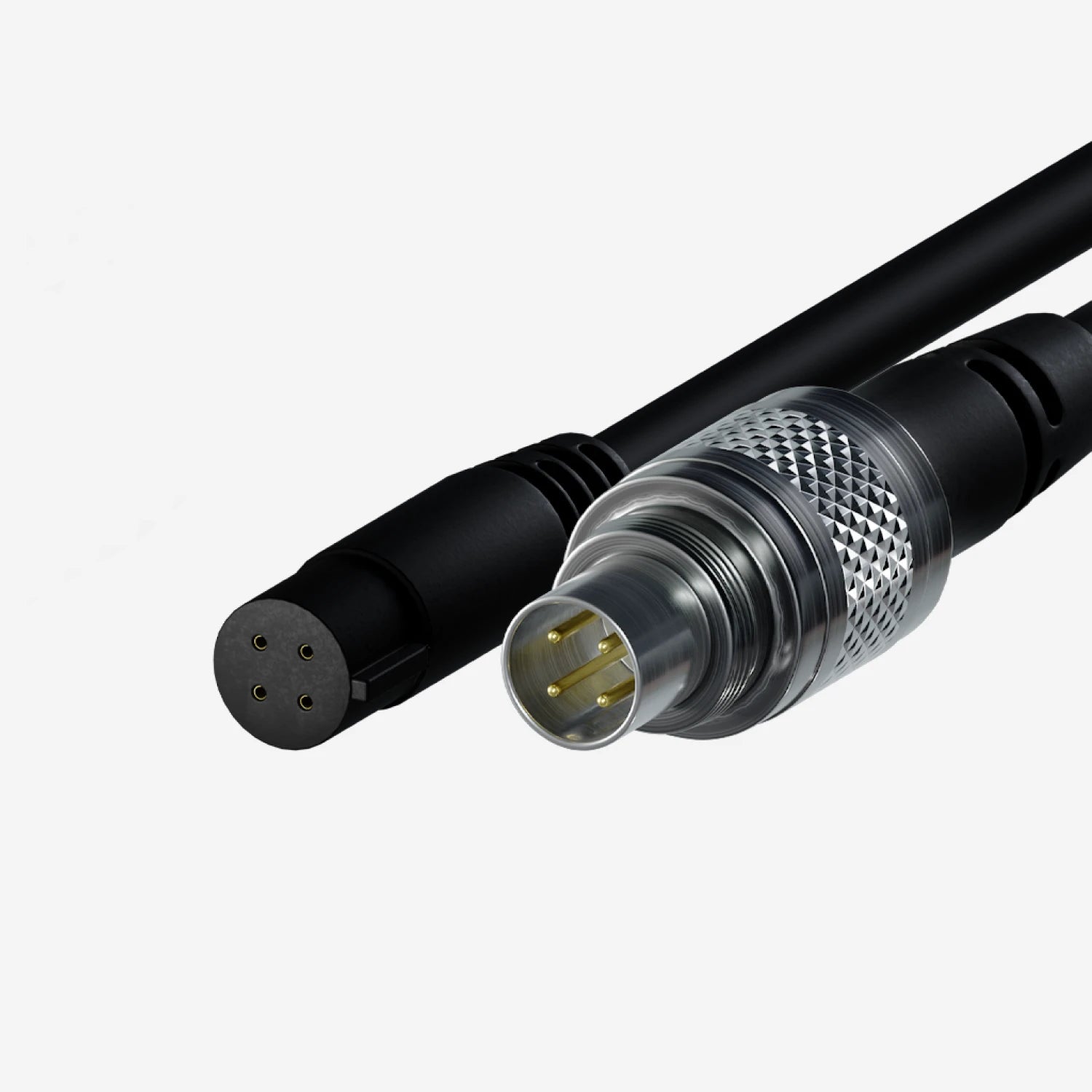

    • The sensor comes with a 25cm cable with a 4 pins Binder 719 male connector
    • Binder Connection Pin:
    • 1 - Analogue signal 0-5V
    • 2 - GND
    • 3 - Not connected
    • 4 - V reference (4.5V)
    • 1 Sensor
    • 1 150cm patch lead
    • 1 Bracket including one magnetic bracket
    • 1 L bracket
    • 2 washers
    • 1 M6 x 16 Allen screw
    • 1 nut
