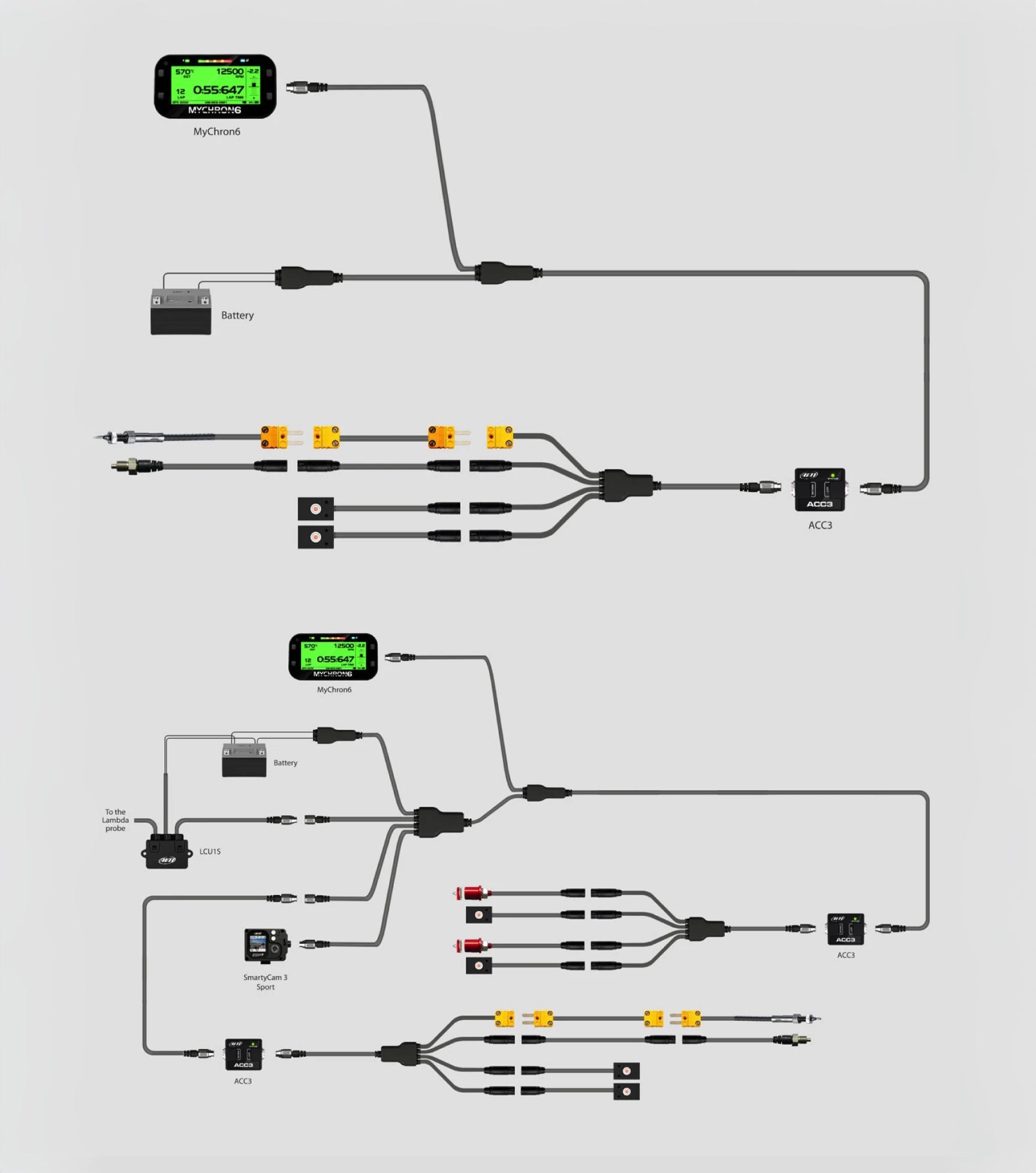

Once the appropriate harness has been selected, the analogue to CAN converter allows you to configure channels according to the connected sensors. Up to 4 type K thermocouples can be managed simultaneously, giving you precise temperature monitoring across multiple areas of your engine or kart.
Suspension Analysis
The ACC3 is also designed to work with Aim Eclipse sensors. When paired with Aim linear potentiometers, data can be processed through the advanced suspension analysis tool in Race Studio 3 - providing a complete picture of chassis dynamics for deeper performance evaluation.
The ACC3 adds four channels and a CAN bus for integration with the LCU-One S Lambda Controller, SmartyCam 3, or Tyre Temperature Kit, and runs on external power. LCU-One S provides adaptable fuel monitoring, and SmartyCam 3 Sport records synchronised video and telemetry for analysis in Race Studio 3.
Please Note: You will need the MyChron ACC3 Split Harness to connect the MyChron to the ACC3.

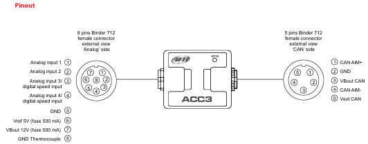

- Data/Dash Loggers: Solo 2 DL, MyChron Series, EVO4S/EVO5, and MX Series dashes.
- Sensors: K-type thermocouples, thermo resistors, 0-5V sensors and 0-12V sensors.
- Expansion Modules: SmartyCam cameras, LCU-One Lambda controllers and CAN expansion modules.
