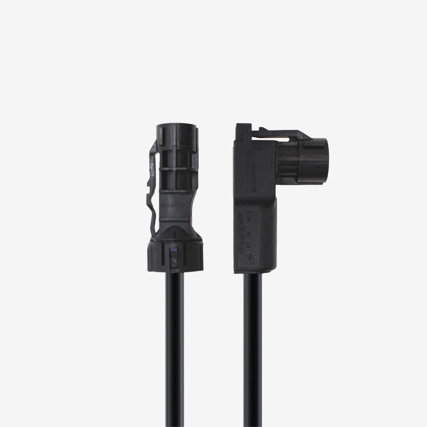

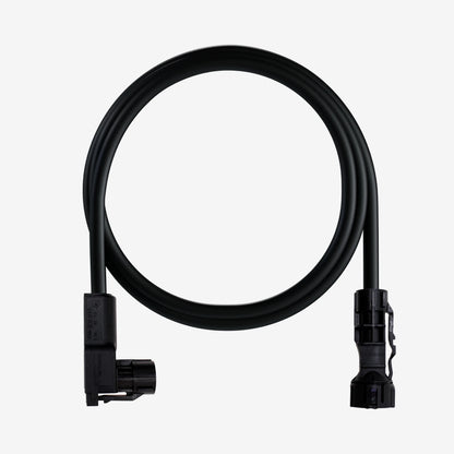

The Aim LVDS connector cable offers a high-speed link solution for connecting your PDM08 module to a remote dash display, transferring full TFT information and status LED activity while also receiving data from the display’s light sensor. The LVDS connector cable uses Rosenberger connectors for IP67 class connection and allows high immunity noise levels. It makes wiring clean, reliable and suited for racing environments. The cable also powers the remote display directly, eliminating the need for a separate power feed and simplifying installation.
Why Choose the Aim PDM08 Dash LVDS Connector Cable
Perfect for use with the PDM08 system, the LVDS connector cable is available in two lengths (2m or 4m) to suit different vehicle layouts and ensures perfect compatibility with Aim remote display setups. Please refer to the Downloads Tab for user guides and all the information and connection advice needed.
