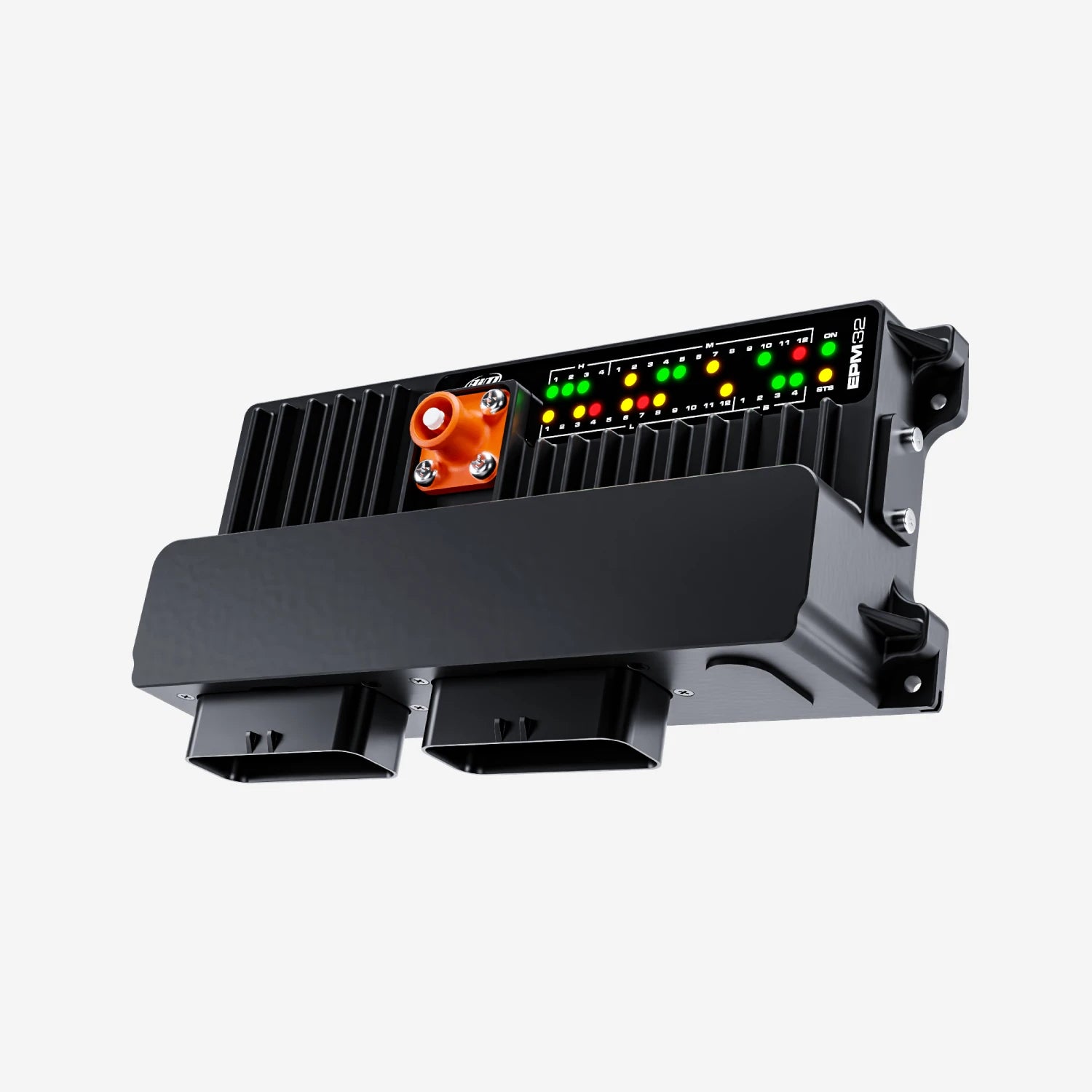

The Aim PDM32 is a 32-channel advanced power distribution module designed to power a multitude of vehicle circuits, removing the need for traditional fuse boxes and relays. It allows for a simplified wiring harness with increased reliability and control functions. Paired with a TFT Display with Road Icons, a fully configurable display with a range of layouts to choose from, and a GPS Module that provides easy lap timing and lap position for track mapping, this kit is the ultimate setup for full vehicle control and performance improvement.

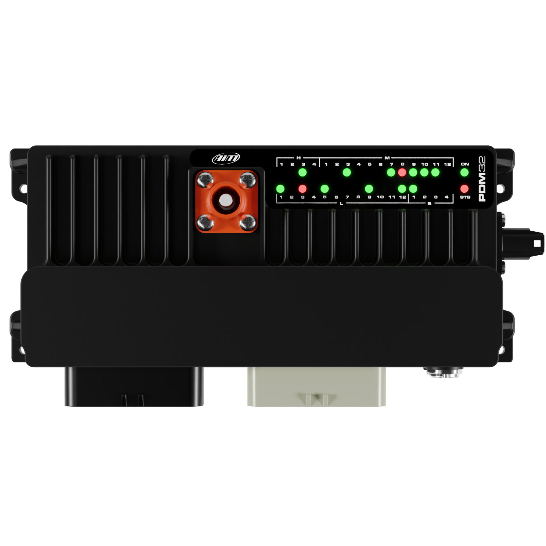

PDM32 Power Distribution Module
The PDM32 features 28 high-side outputs and 4 half-bridge outputs: 4x rated up to 20A (high power), 12x rated up to 15A (mid-power), 12x rated up to 10A (low power), and 4x rated up to 35A (half-bridge), with a total continuous max current of 120A. Each output provides feedback to the data logger to provide vital information such as open circuits, short circuits, high/low voltage, and the number of fault retires. The time between the retires is user-definable. All outputs can be configured as PWMs for a soft start/stop. All of the PDM circuits can be set up and monitored via the Race Studio 3 software.
The PDM also features 8 analogue/digital inputs, 4x digital-only inputs and 2x speed inputs, and can receive and record data from the following sources:

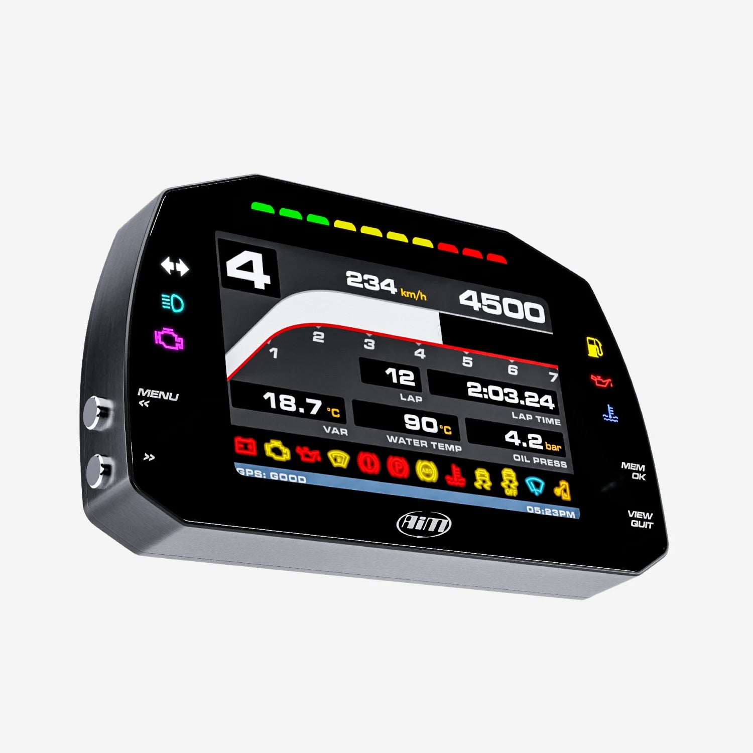

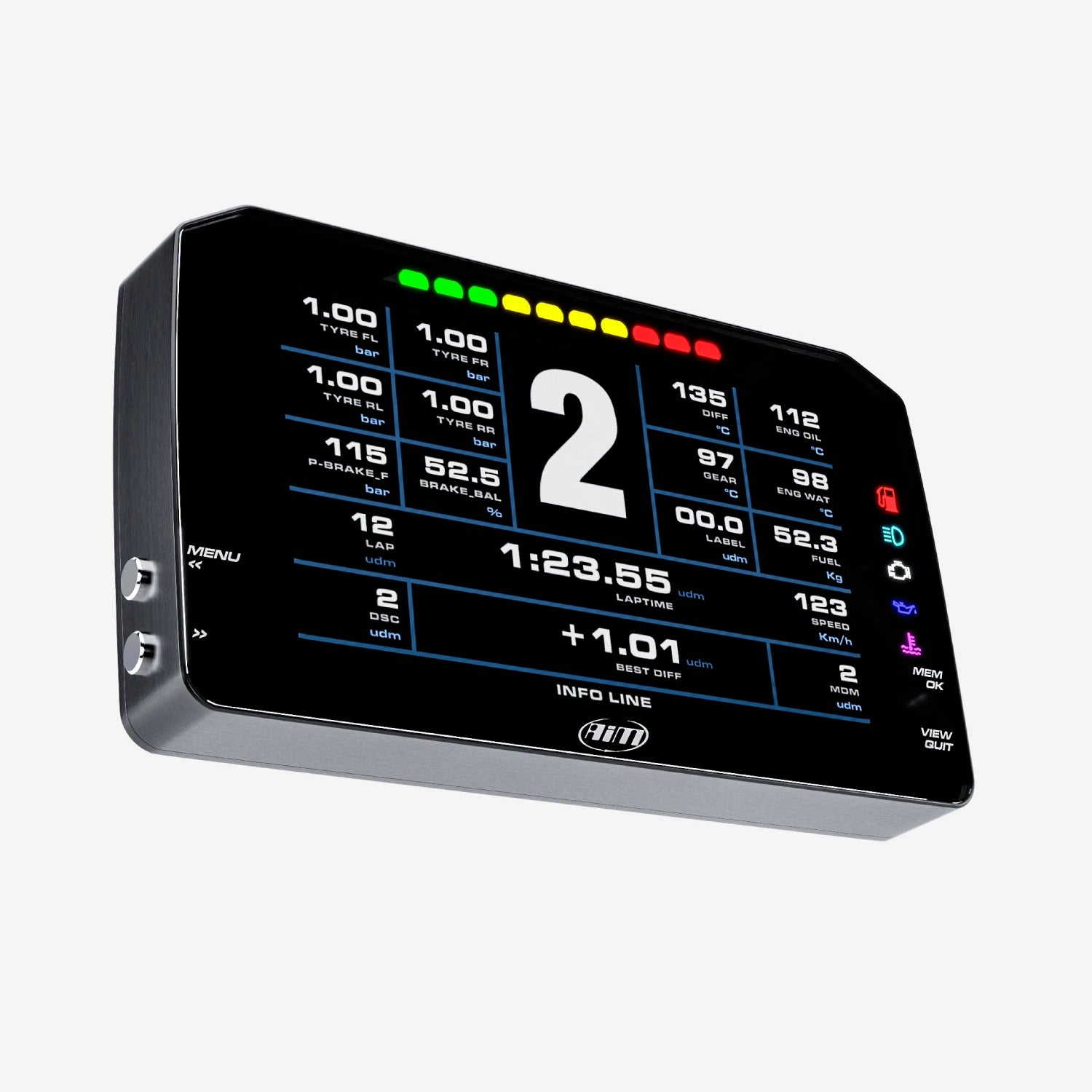

PDM Dash Display with Road Icons

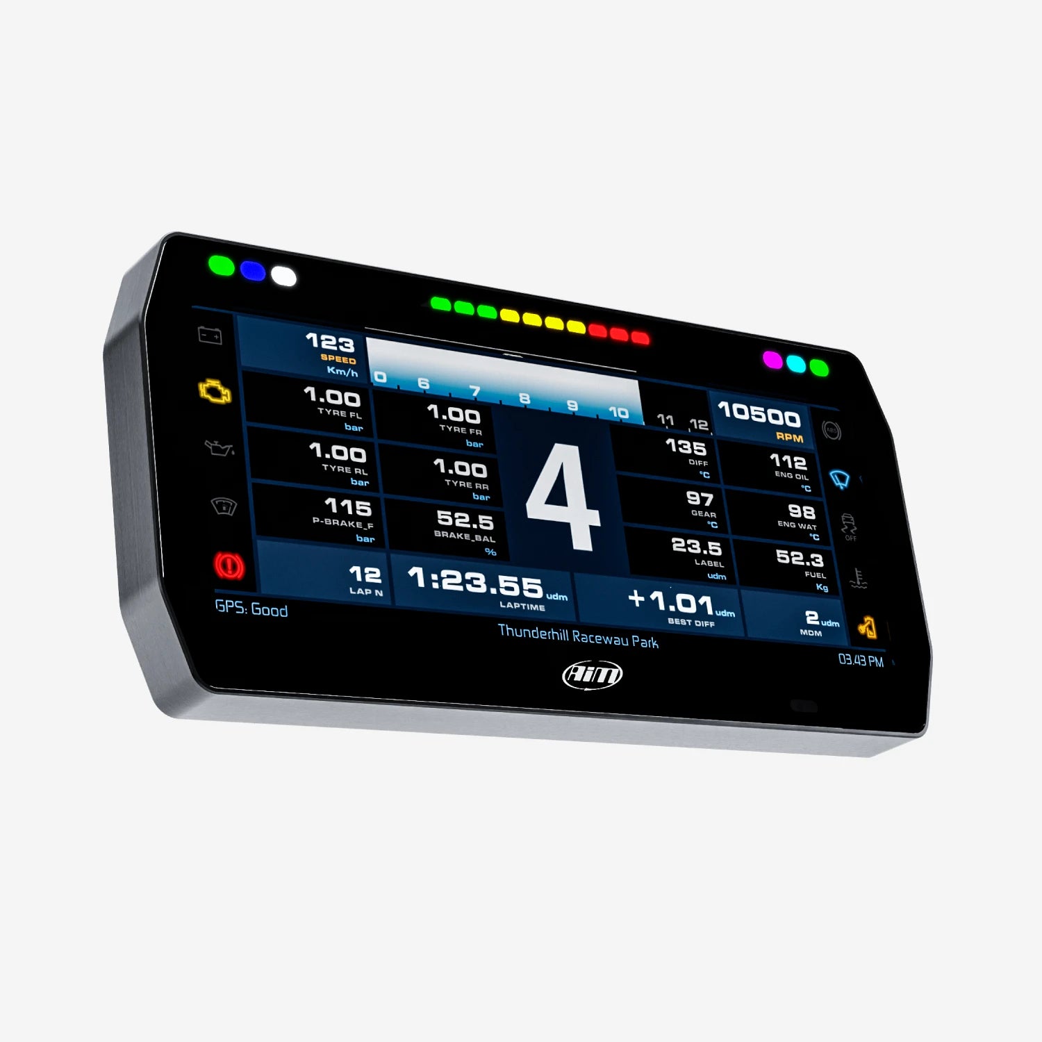

All versions have fully user-configurable displays and offer a range of layouts, and are available with "Road" or "Race" icons. Road icons with this particular kit allow you to apply conditions to the LED icons, such as fuel, engine, oil, lights, indication and more.

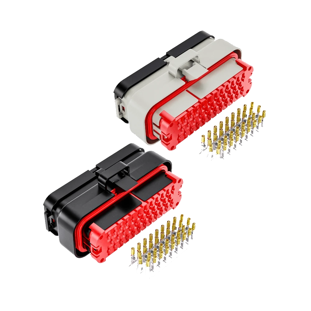

Grey & Black 35-Pin Plug & 70 Gold Pins
