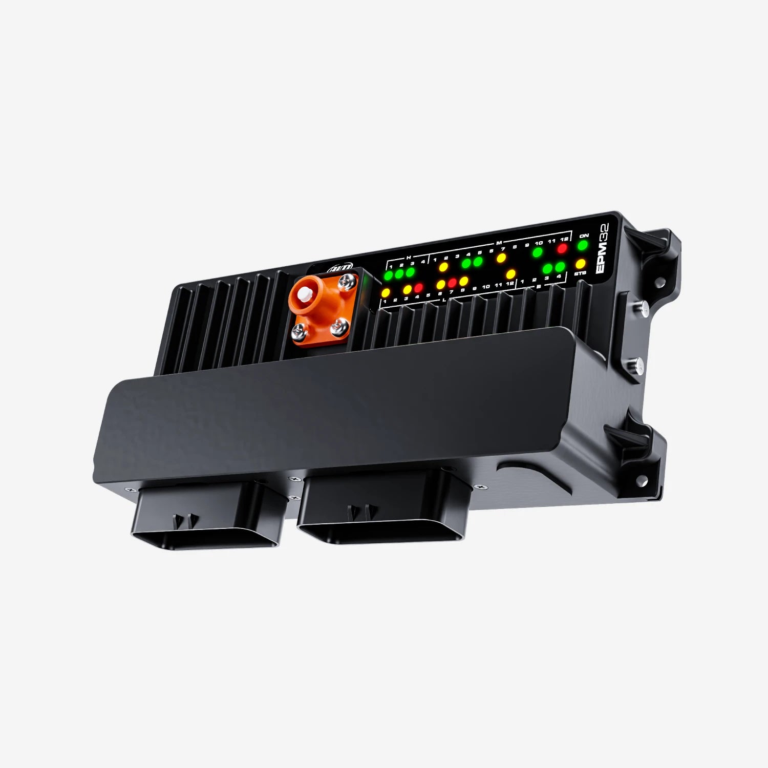

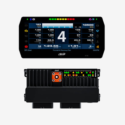

The Aim PDM32 is a 32-channel advanced power distribution module designed to power a multitude of vehicle circuits, removing the need for traditional fuse boxes and relays. It allows for a simplified wiring harness with increased reliability and control functions. Paired with a TFT Display with Road Icons, a fully configurable display with a range of layouts to choose from, and a GPS Module that provides easy lap timing and lap position for track mapping, this kit is the ultimate set-up for full vehicle control and performance improvement.
PDM32 Power Distribution Module
The PDM32 features 28 high-side outputs and 4 half-bridge outputs: 4x rated up to 20A (high power), 12x rated up to 15A (mid-power), 12x rated up to 10A (low power), and 4x rated up to 35A (half-bridge), with a total continuous max current of 120A. Each output provides feedback to the data logger to provide vital information such as open circuits, short circuits, high/low voltage, and the number of fault retires. The time between the retires is user-definable. All outputs can be configured as PWMs for a soft start/stop. All of the PDM circuits can be set up and monitored via the Race Studio 3 software.

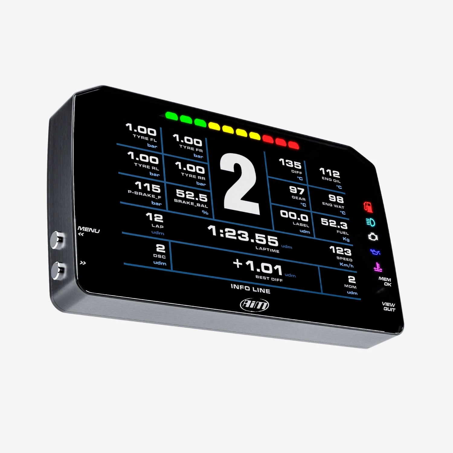

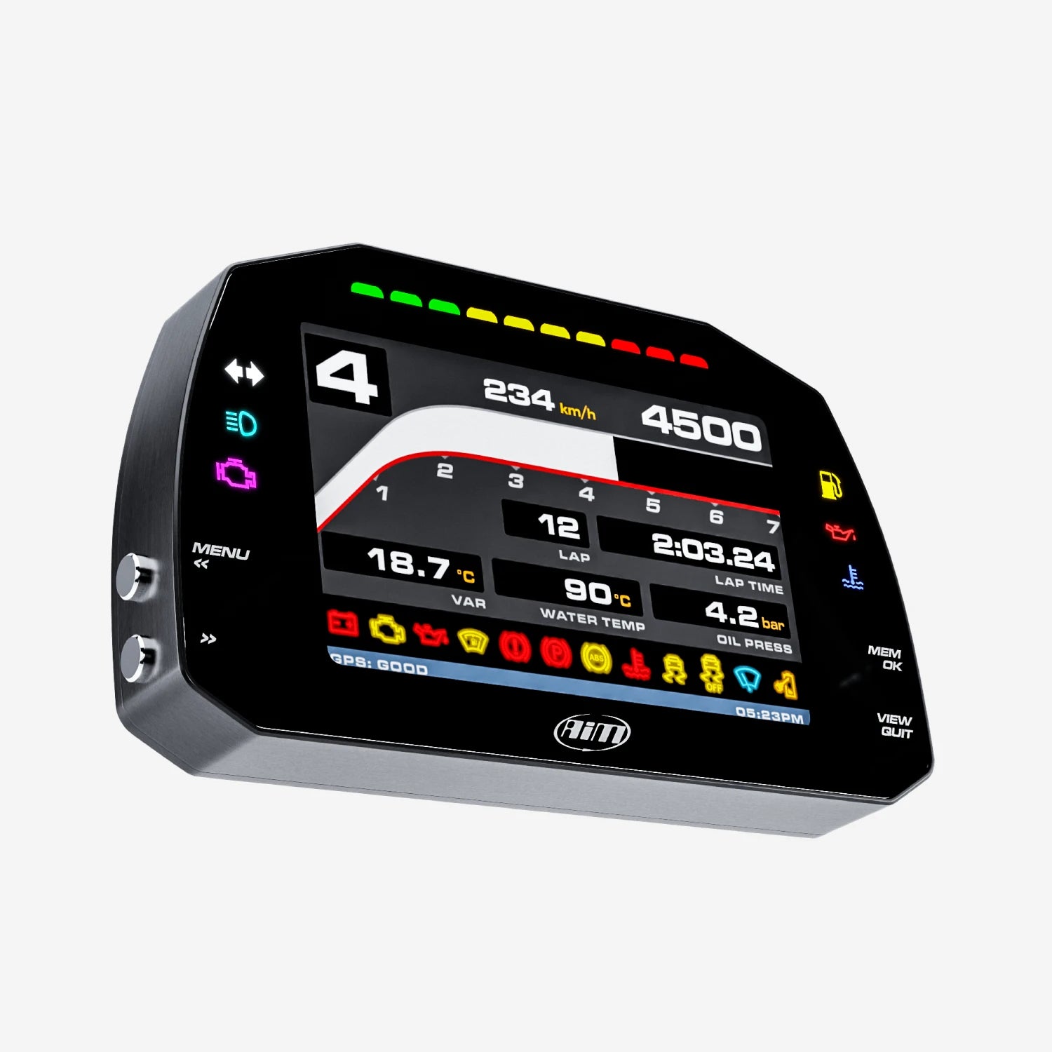

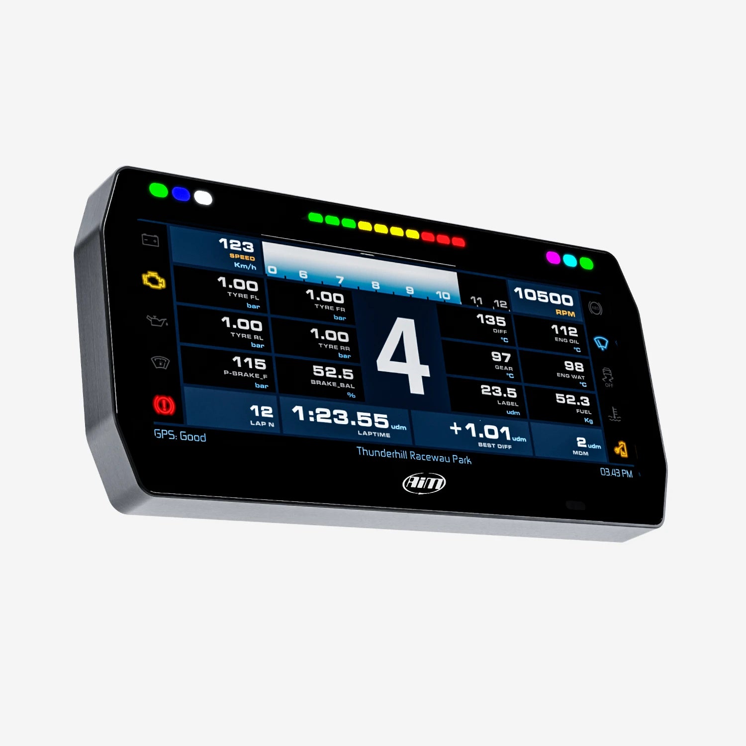

3 variations of PDM Dash Display in 5, 6 and 10-inch
PDM Dash Displays with Road Icons
All versions have fully user-configurable displays and offer a range of layouts, and are available with "Road" or "Race" icons. Road icons with this particular kit allow you to apply conditions to the LED icons, such as fuel, engine, oil, lights, indication and more.
Load video: Delta times LED display feedback on the 5 inch PDM Display
Pre-Configured Pages
The Aim PDM Display can show the RPM scale and all the data you need, like speed, water temperature and oil pressure, lap times and much more. You can customise pages to suit your requirements, including up to four additional fields. Define what data is shown with the end of scale and measure units. Swapping between the pages is easy; just use the push buttons.

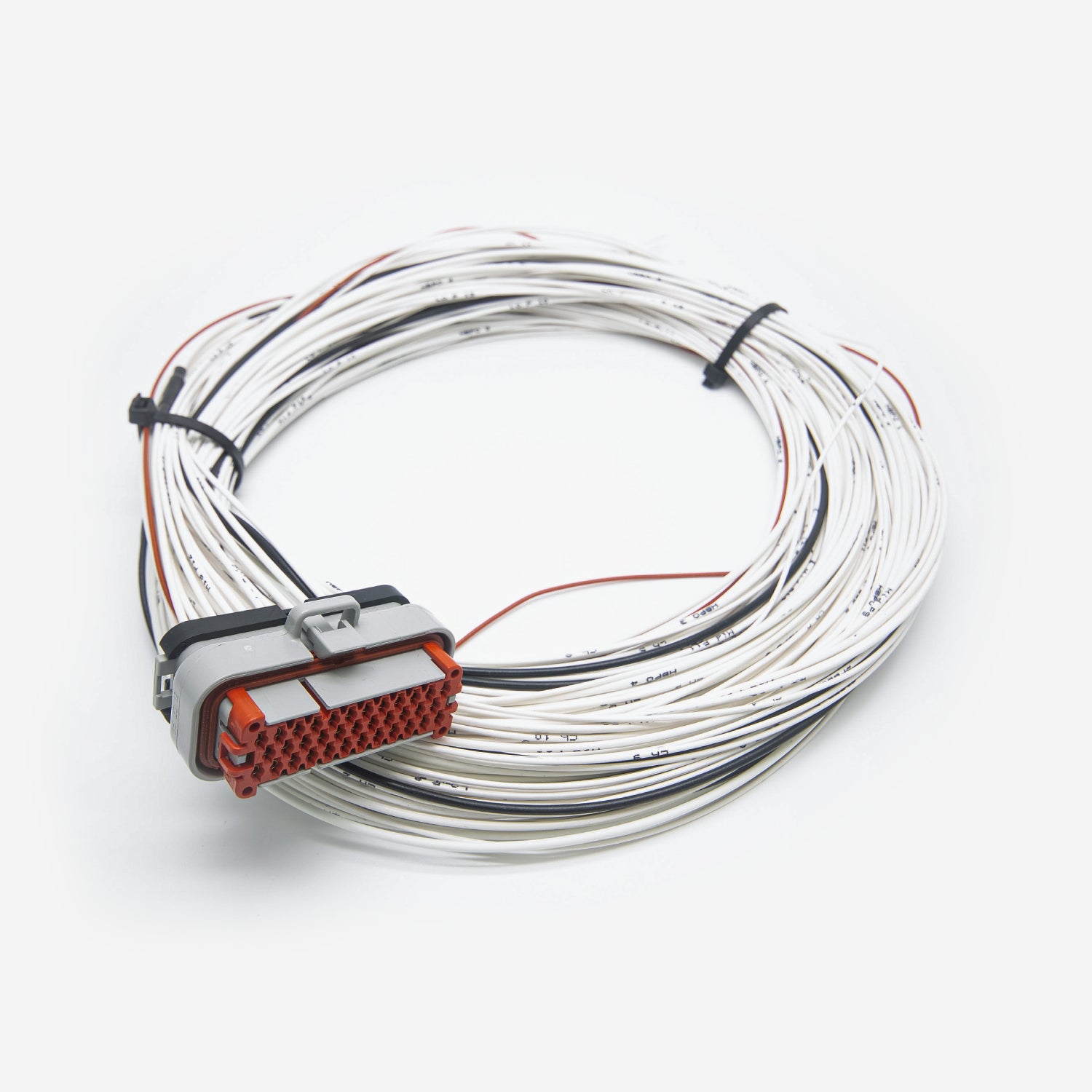

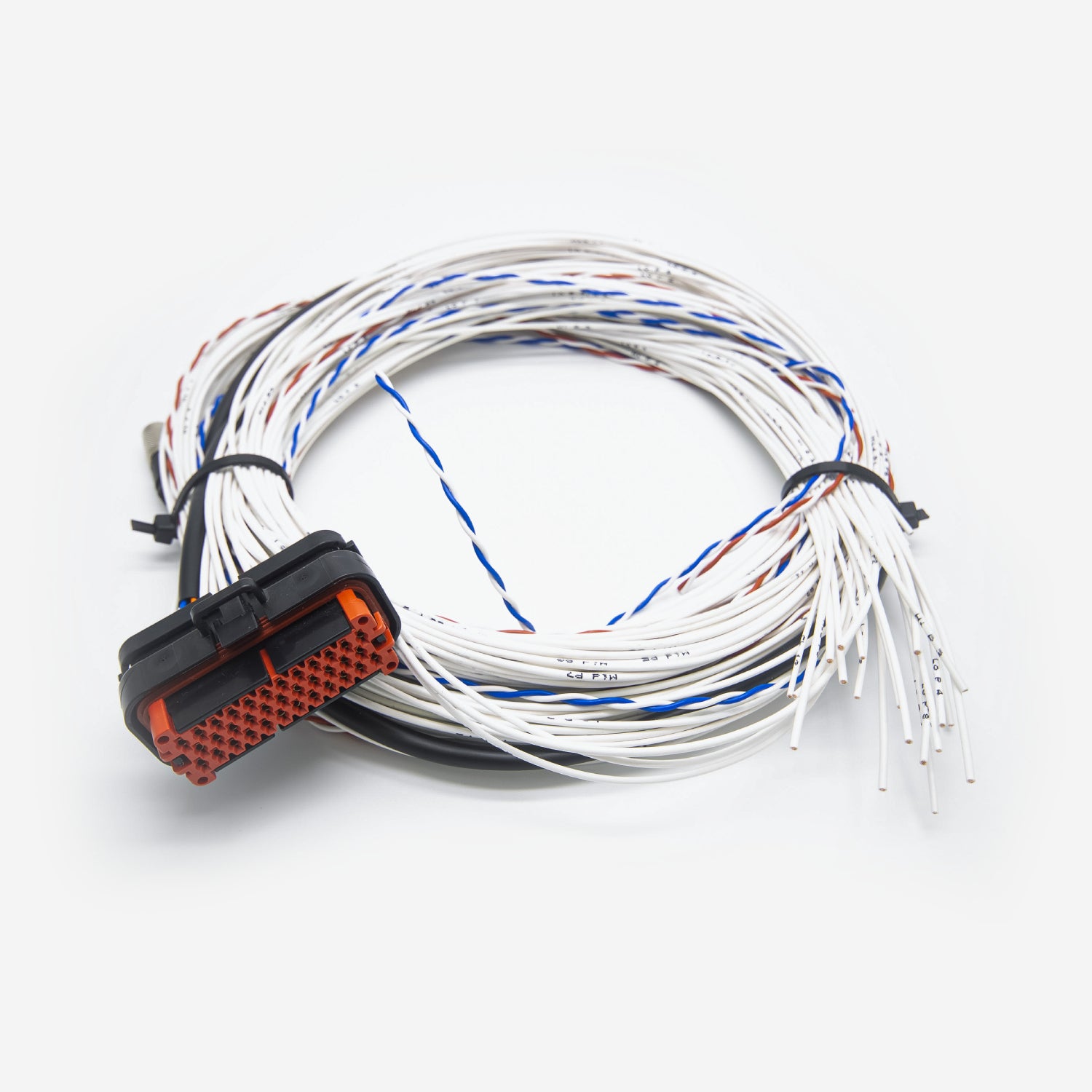

Optional Wiring Solutions

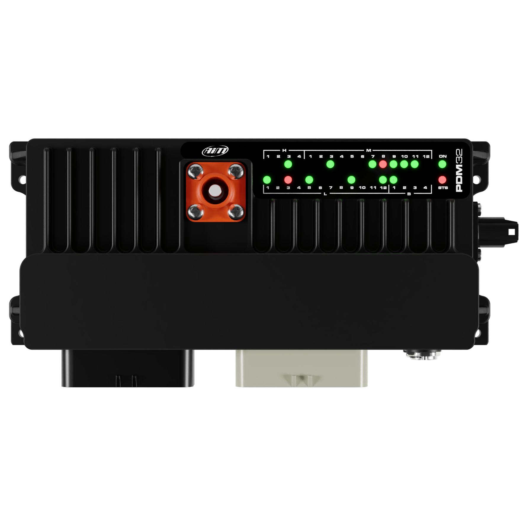

  • LEDs: 32 RGB LEDs, 1 PDM ON & 1 PDM STS (status)

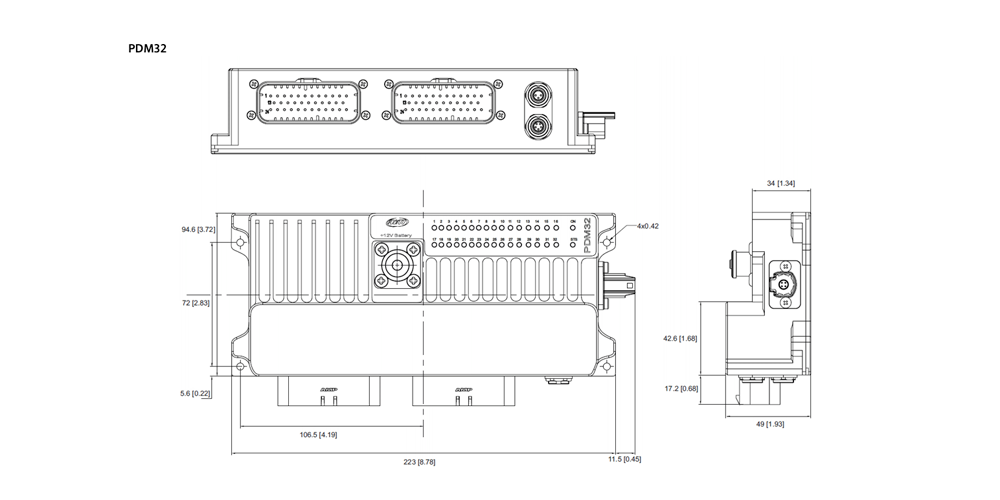

  • Dimensions: 234.5 x 94.6 x 49.5mm
  • Weight: 761g

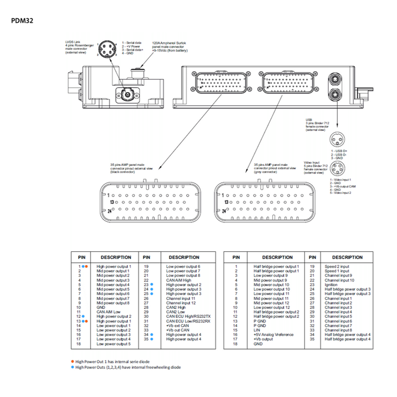

Pinouts
MXS 5 inch PDM display pinout 6" PDM Display Diagram

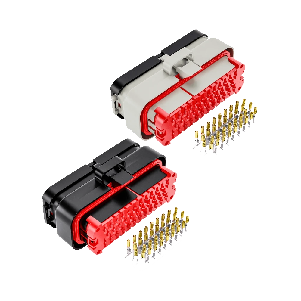

  • Grey & Black 35-Pin Plug & 70 Gold Pins
