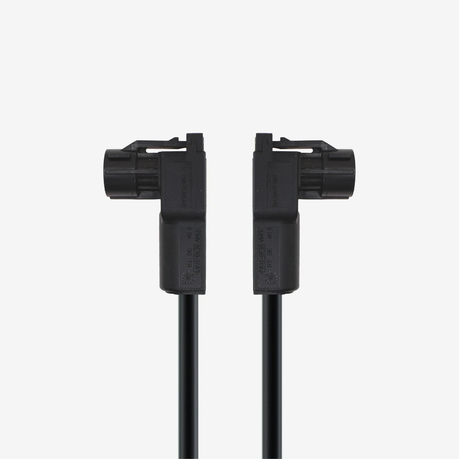

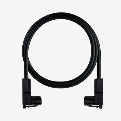

The Aim PDM32 LVDS connector cable provides a high-speed link connection between your PDM32 module and a remote dash display, transferring all the TFT graphics, status LEDs, and control signals through a single harness.
The LVDS connector cable also receives light sensor data and push button inputs from the remote display, and it powers the display with the same link, eliminating the need for extra wiring or power feeds. Featuring strong Rosenberger connectors with IP67 sealing and excellent noise immunity, it always ensures reliable performance.
Why Choose the Aim PDM32 Dash LVDS Connector Cable
Available in 2m or 4m lengths to suit varying vehicle sizes, the LVDS connector cable is the ideal choice if you’re replacing your existing link or installing a new system. With full compatibility to Aim PDM32 remote display infrastructure and a design emphasising reliability and simplicity, it ensures that your dash data is transmitted cleanly and consistently every time. Please refer to the Downloads Tab for user guides and all the information and connection advice needed.
