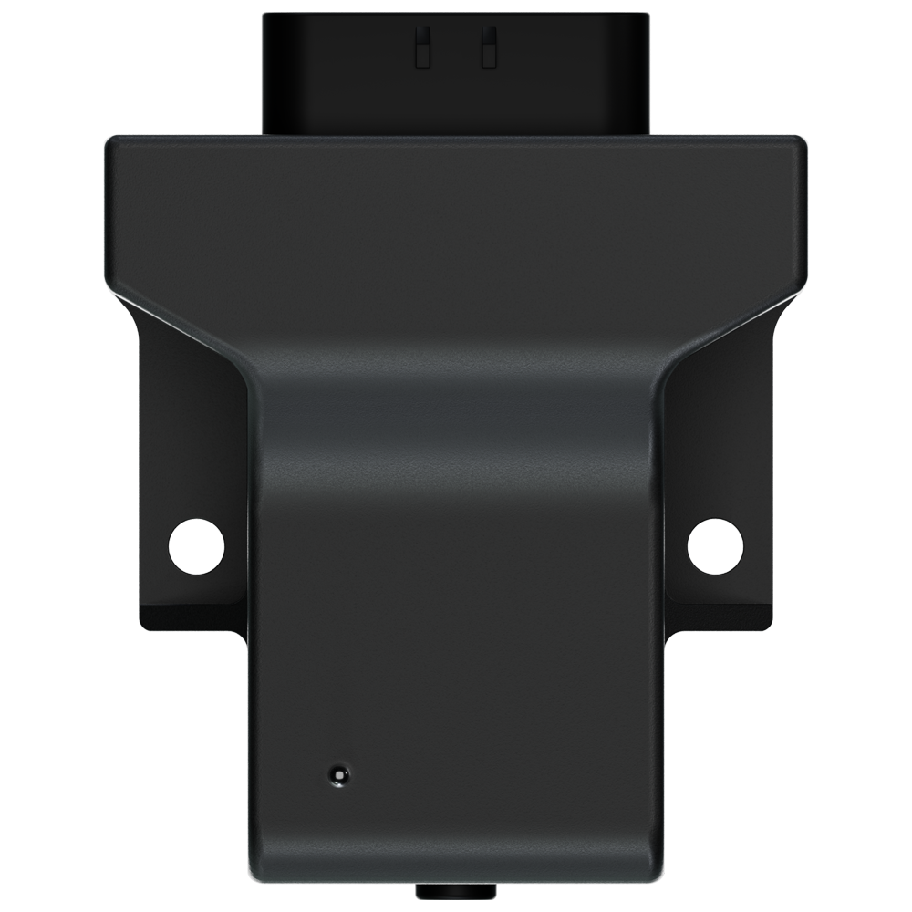

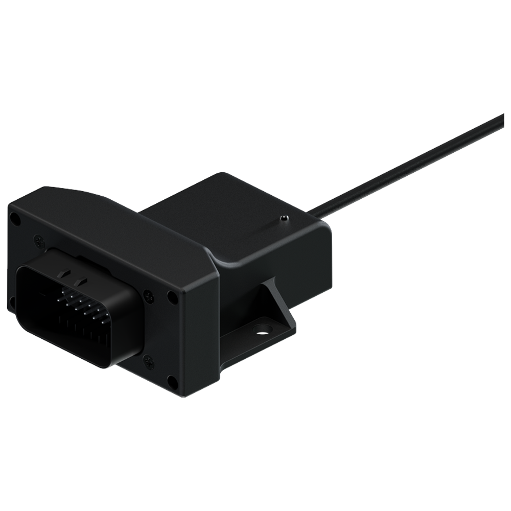

The Remote Input/Output (RIO02) Module is dedicated to push button management when the available inputs are not enough.
Why Choose the Remote Input / Output Module
The Aim RIO02 Module enhances control capabilities by providing 19 inputs. It seamlessly integrates with Aim CAN networks for efficient communication and enhanced compatibility.
Gain access to 11 dedicated switch-to-ground inputs that provide extensive control options for your system's operation, utilise 2 low-side outputs to expand functionality and offer flexibility in controlling external devices or components, and configure 8 inputs to switch-to-ground or switch-to-battery, tailoring control to your needs with precision and versatility.
  • CAN Connections: 1
  • 19 Inputs: 8 prog: Switch to Batt, Switch to Ground & 11 Switch to Ground
  • Dig Outs: 2 low side (2A max)
  • Body: Plastic
  • Connectors: 1 AMP 776087-1 connector
  • Dimensions: 99.2 x 80 x 40.1mm
  • Weight: 120g
